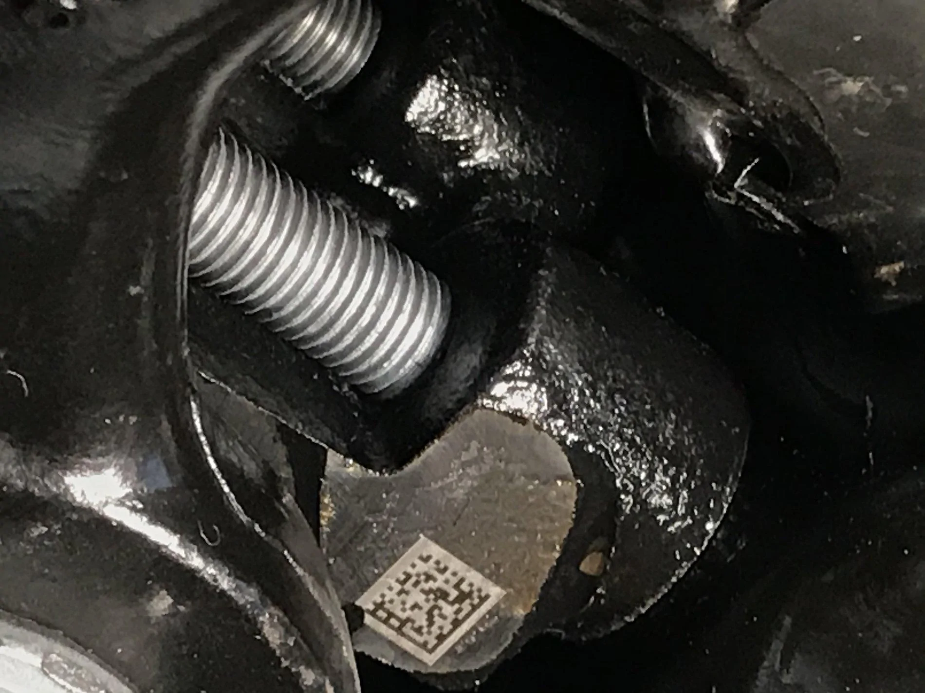

Ok fellas , just picked up Sting from the dealer. New steering gearbox and computer flash (per steering fix TSB). What a difference.
I don’t know if the aluminum housing was too soft and allowed for movement or if it’s a redesign inside the housing but it made a tremendous difference. It passes the “BMW autobahn sneeze test” where if you’re in your lane clipping at 100kph and sneezed and ya stayed in your lane you were good and passed :like: .
I highly recommend getting it done if you had issues with the “free play” and “wander” You still know it’s different than IFS, but comes darn close to Ram and F150 steering. Old and new pix for comparison.

are those the correct bolts they used? I saw another post yesterday where someone posted some really really long ones like that, and others said they werent the correct ones. Not sure it matters if its holding correctly and the torque stays put, just seems odd to have such long bolts compared to before.,
Also, is that before it was finished? I see you are missing a nut on one of the bolts on the left side??
Ya know I didn’t catch that. Will get under there and have a look round.
See if that warrants a nut on there as it seems it should unless it just acting as a locator. :like:
Still it’s working proper.
Let us know. I just happened to notice there was a nut there in the before picture, but not in the after.
Ok upon further investigation... all cool.
This is a threaded housing. All snug as a bug. I also confirmed this with Jeep.
You’ll never get a bolt on the one side anyway because of design location/tolerances .
Example pic Hope this helps.
