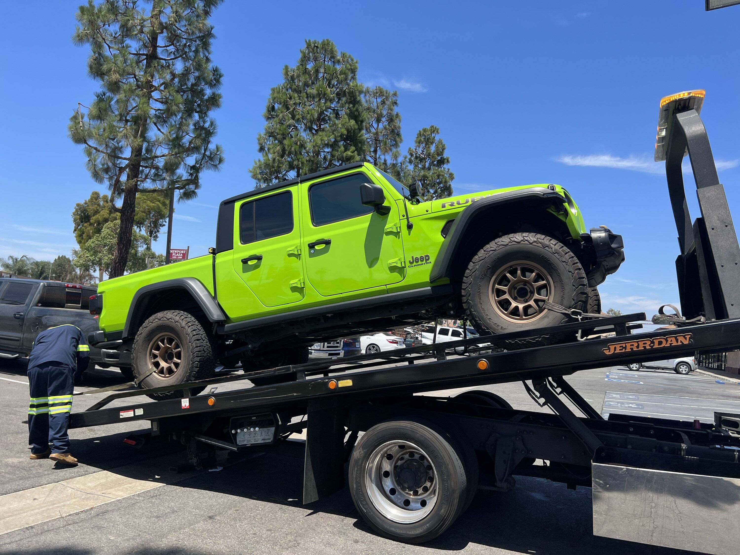

Damn. Thanks for the info. Really appreciate it.
I decided to get it towed - they came pretty quick.
Jeep Gladiator Turbo Went Out! IMG_2618
