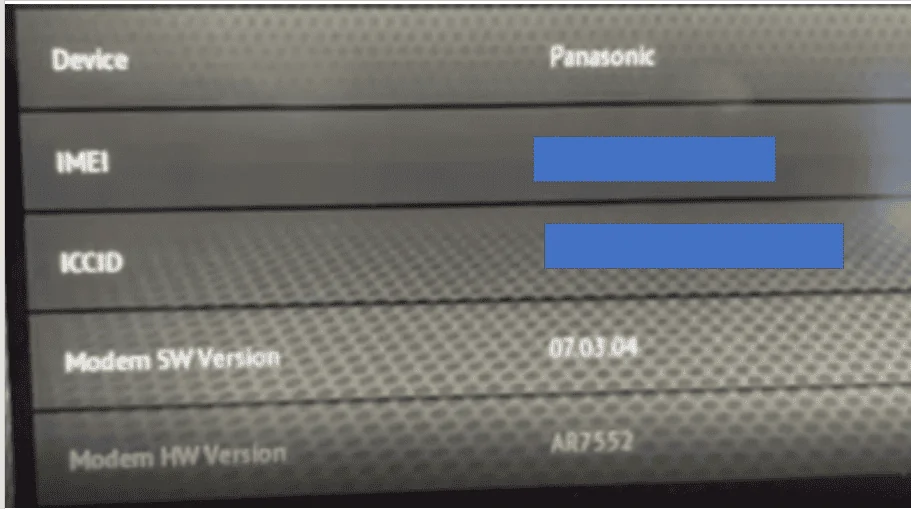

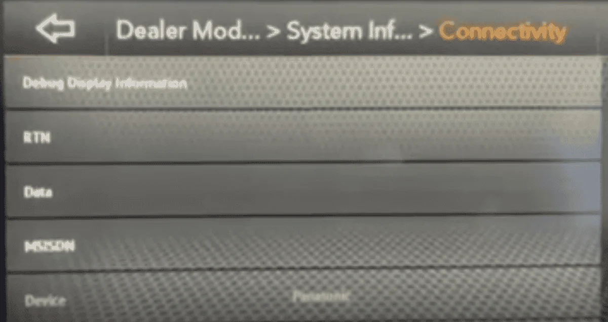

Trying to find the MTN in the dealer menu and the only modem related items (under dealer mode, system information, connectivity information) are shown below. Is there a different location to find MTN?
