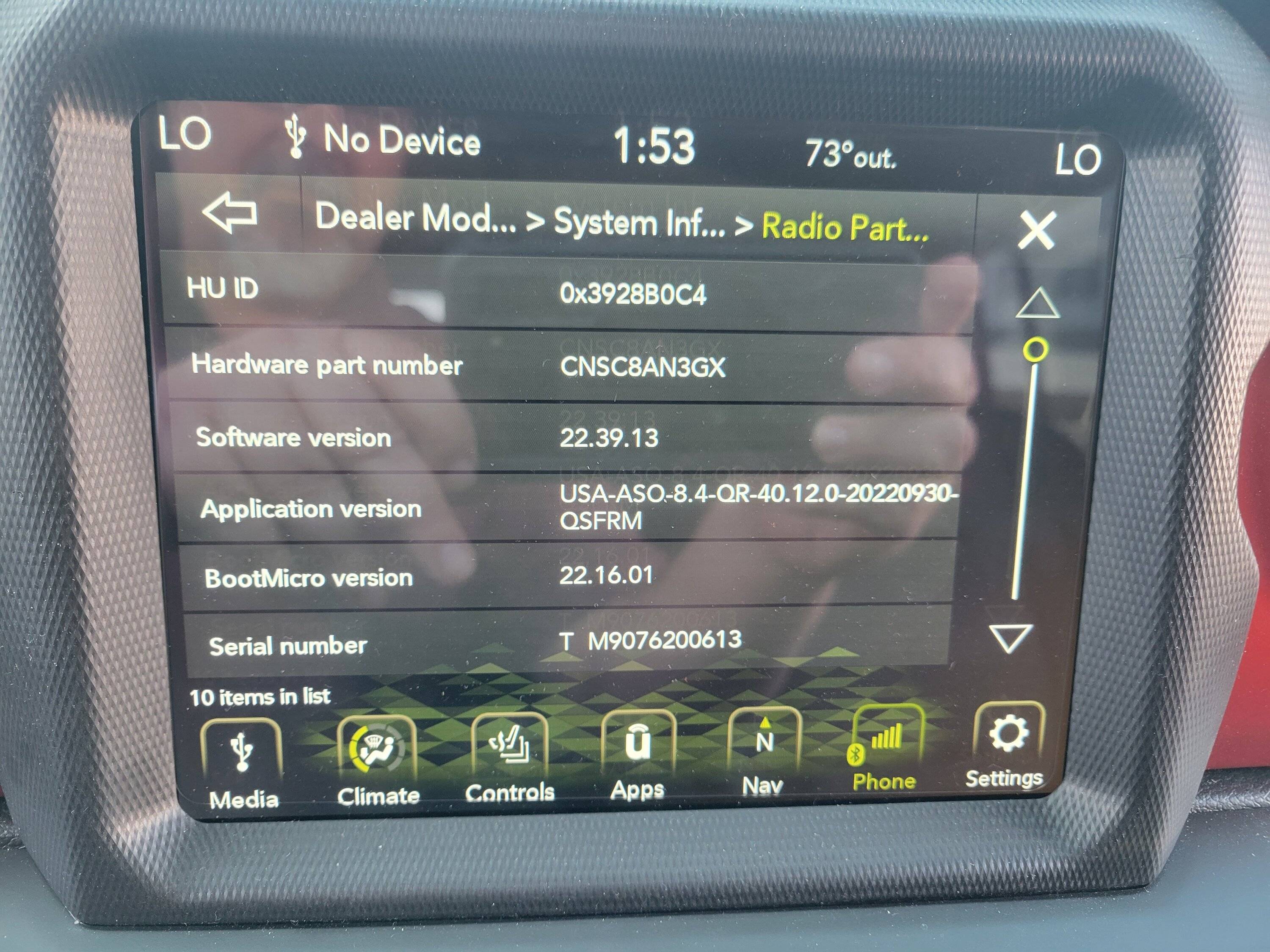

On HVAC controls, press the temp up/down and front window defrost keys at the same time for a few seconds and the radio will go into dealer mode. Select the radio part information and it will list the revision.

Yours needs to be updated. The last TSB I have on it says the application version should be 40.1 where yours is at 34.32.0.
My last OTA update pushed mine to 40.12.0
Keep in mind this is for the 8.4 radio and not the 7.0 radio
Jeep Gladiator UConnect update download 20230420_135320
