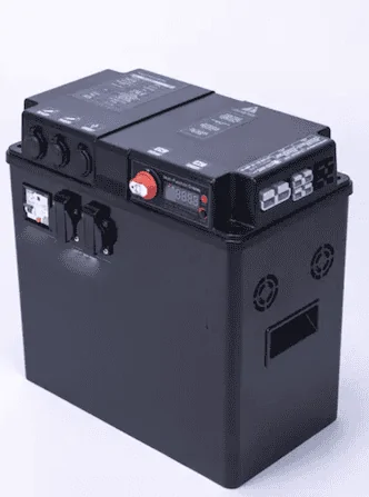

I am working with a manufacturer to create what I think is the ultimate power system for overloading, camping and encompassing the entire outdoor lifestyle.
What I have envisioned is a 12V power supply similar to the ArkPak with a few major upgrades to the system. My system will come with LiFePO4 batteries preinstalled rather than bring your own. They system will have a pure sine wave inverter built in and at least two 110V outlets. Although I do not necessarily feel they are that important I know a lot of people do there will be a couple USB ports as well. There will also be 2 or 3 12V cigarette lighter plugs as well. Now to the unique stuff that I haven't been able to find anywhere else. I have found a source that can provide a 30 amp DC-DC charger, solar MPPT charge controller and battery isolator. There will be two 50AMP Anderson Plugs for charging and supplying power to accessories.
The system would be a true plug and play dual battery system able to charge from 12V plug in, AC wall charger, DC-DC charger from your alternator and solar. The unit will be fully self contained and neatly packaged so the only thing needed to install would be attaching the wires to the truck battery and plug in the Anderson plug and fasten it down. I plan to even provide the wiring for the installation.
As of right now I am planning on two sizes 100AH and 200AH units. Tentative measurements will be about 17x10x13 and 55 pounds for the 100AH and 17x10x17 and 88 pounds for the 200AH unit.
My question for you guys is what am I missing? What other features would y'all like to see and what would y'all throw out? And what kind of value does a system like this have for you?
Although this is very fluid right now the preliminary costs for the units would be approximately $1500 for the 100AH unit and $1900 for the 200AH unit. Although that seems like a lot of money on the surface When you total up what all of the separate parts would cost with quality equipment it is much less. Using one of the most popular battery options, BattleBorn, the two batteries alone would cost as much as the entire 200Ah system. Then when you throw in the chargers and everything else we will include you get a much better value than building your own system would provide.
Please provide any feedback, interest and suggestions you guys may have for me.

How would that be different from the Jackery or Goal Zero that comes as a pre packaged unit and has a warranty?
The main difference that comes to mind right off the bat is the DC-DC 30 amp charger. It takes a Goal Zero forever to charge via AC and the maximum amperage you can put into the system through the 12V plug is 10 amps. Also my system will be designed and engineered to work in the bed of your truck. Leave a Goal Zero or a Jackery out in the rain a few nights and see if they enjoy the experience. I will do a little more research on those units and update my answer if I find any other glaring or differences.

And the largest Jackary is less than half the capacity of my smallest unit. Also I forgot to mention in my previous response was that mine is a true two battery system for your truck. I could also add a 175 amp Jumper cable system so you could use the second battery to jump start the truck if the main battery should die.

They have to have some form of dc input...
They can be charged by solar, so I'm wondering what the specs are.

The charger that I am talking about is not just a DC input. it is a DC-DC charger that allows the smart alternators on modern vehicles to charge at the proper voltage regardless of the input voltage.
I just checked on both the Goal Zero and the Jackery websites and leaned that both of those batteries are Li NMH and my batteries are LiFePO4. The difference in the two battery chemistries is the number of discharge cycles. Goal Zero website states that their batteries are rated for 500 cycles whereas mine are rated for 2000-3000 cycles.
I will add this edit to discuss the price of Goal Zero. On their website the 1400 is $1900 and it is rated at 132 Ah at only 10.8V. That won't do for us my biggest system is tentatively the same price with a minimum of 200Ah at 12.8V.
And finally I am working with a company to manufacture these units and they will have a 12 month factory warranty.

Will the voltage be regulated? Some of the solar generators on the market can't be used for 12v DC camper fridges as the voltage drops below the minimum voltage for the fridges as the battery drains down. Also, what is 100ah in watt hours? The largest Jackery is 1000 wh I believe.

Yes it is voltage regulated through the BMS to provide a very stable power supply the nominal voltage is 12.8V. The main reason for me going on this quest was to power my Dometic CFX95DZW.
amps x volts = watts so these systems will be rated for a minimum of 1200 watt hours.
I will also add that the theoretical capacity could be as much as 120ah for the small one and 240ah for the big one. I am having one assembled as we speak to see exactly how many cells I can fit in the box. I will be able to update that information by the end of next week. But to be safe I introduced them as 100 and 200 ah.

This is why I'm thinking about running 24v..
starting amperage at 12V is 7.5amps!
at 24, it would only be 3.5.
