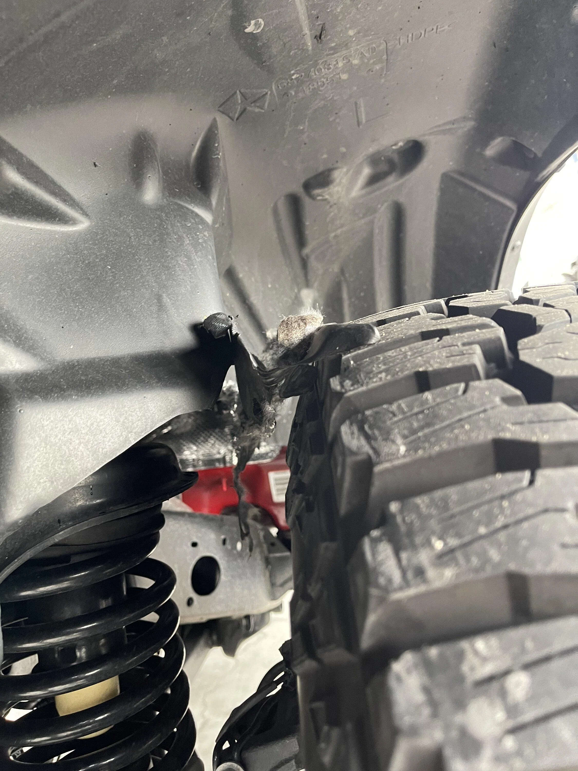

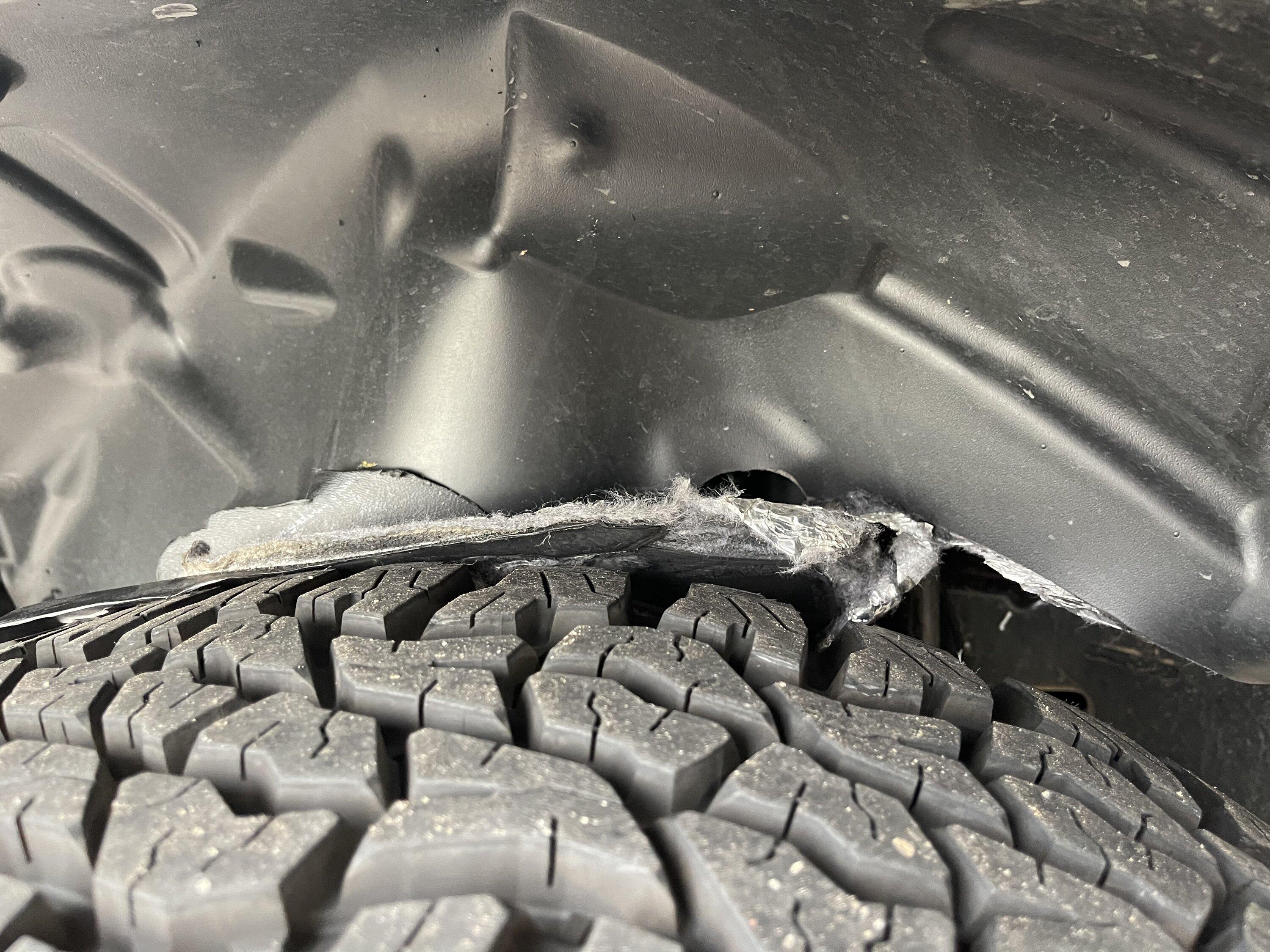

Two days ago I would have agreed wholeheartedly with you. Then this happened just yesterday with only 3600 miles. Happened driving 75 mph into strong headwinds over a mountain pass. The fender liners are so thin it’s about as thick as a milk jug plastic. And not secured enough. The wind pushed the plastic into the tire.
In two weeks I’ll see what the dealer will say. I will push it’s a design flaw and an easy fix would be one more plastic Christmas tree
But as an alternative, now I’m looking a no none sense fender liner. I still subscribe to the if it’s not broke don’t fix it club. Now it’s broke

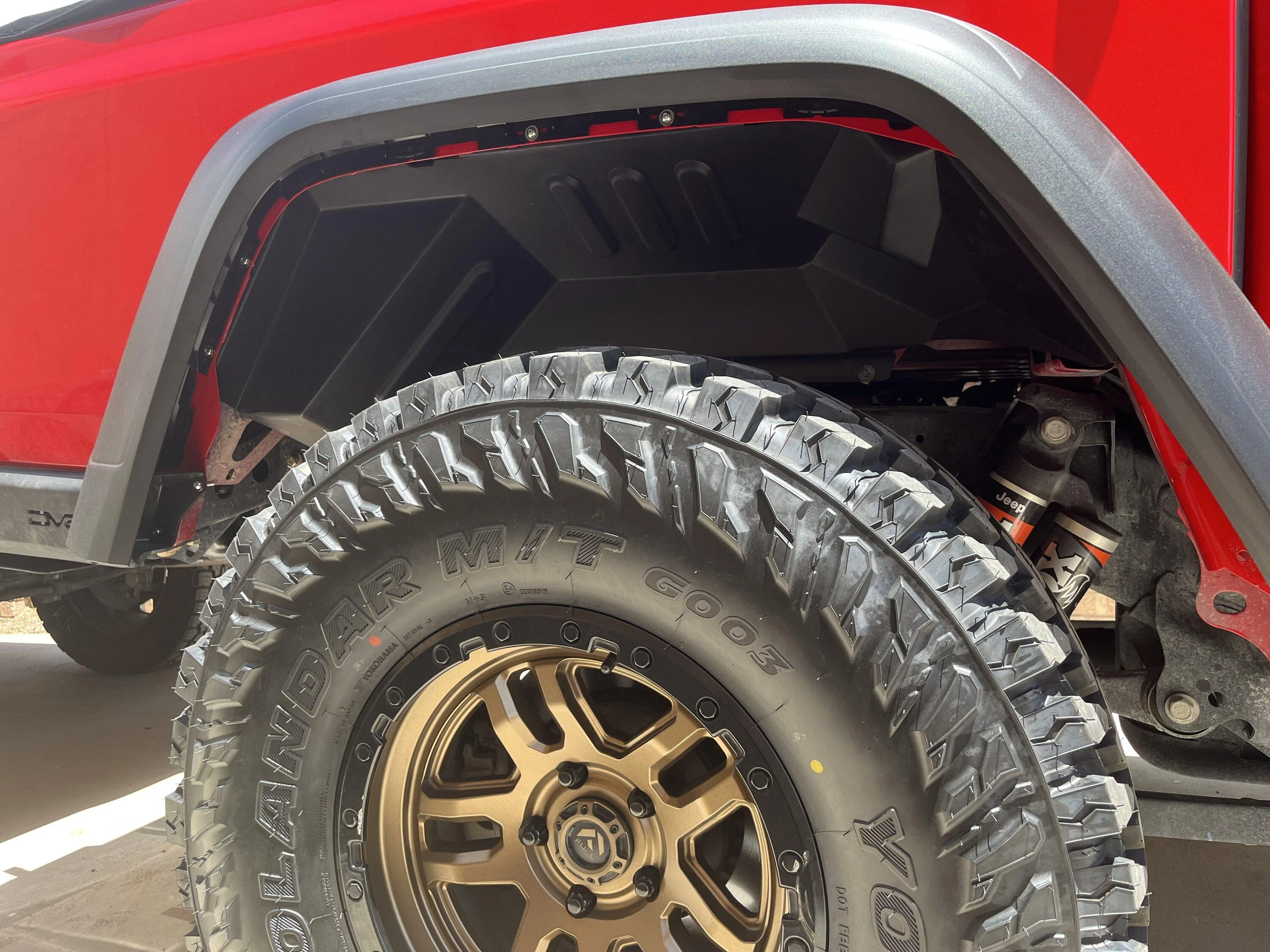

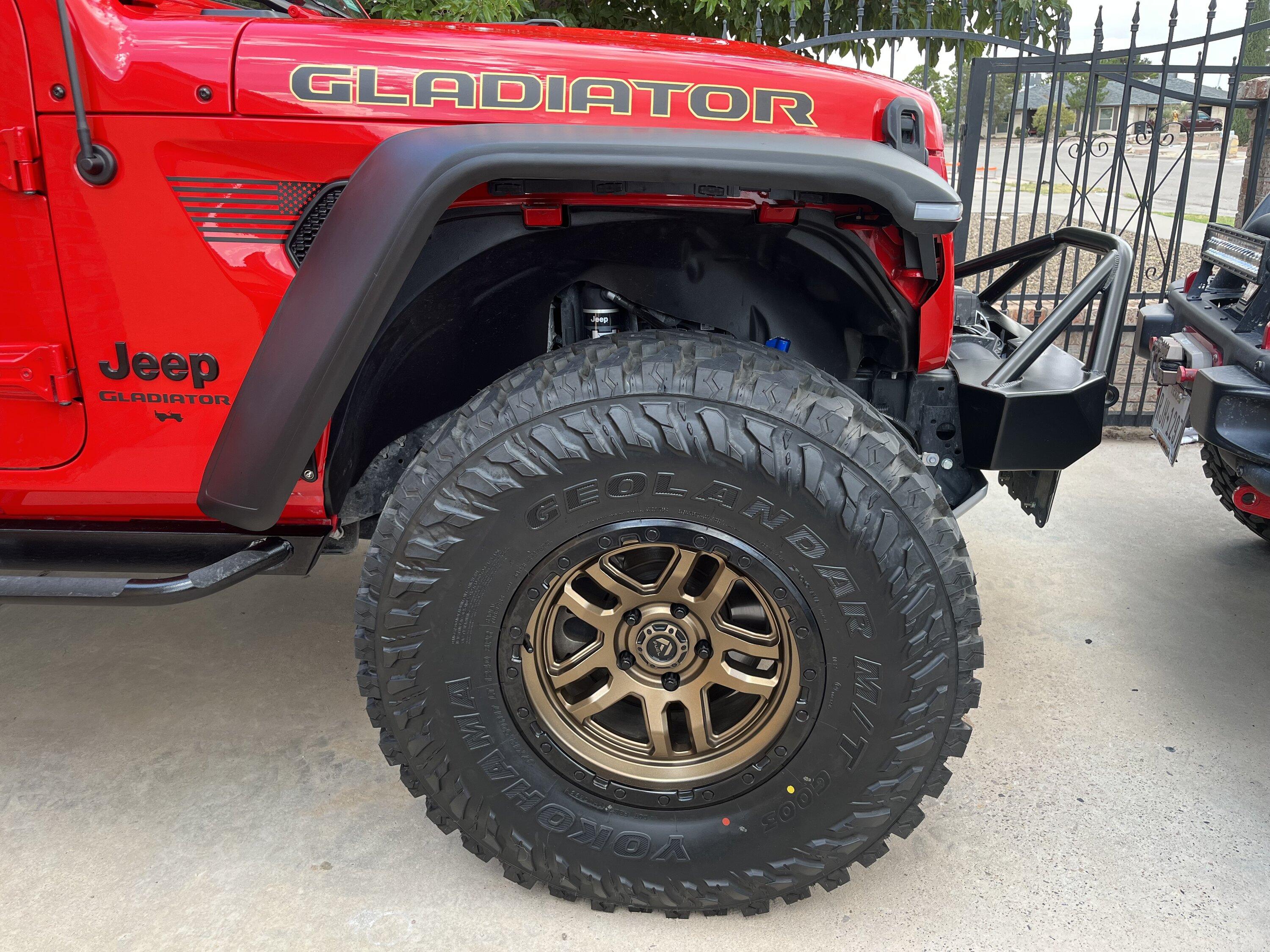

Not a fan of metal liners because of the unnecessary cost, weight gain, and they tend to rattle. Also I'm paranoid that if they rattled loose at speed you now have a giant metal shard that will go straight through any tire.
At any rate, I had to switch from the OEM liners to something aftermarket as I swapped to the Max Terrain flares from Rugged Ridge. Right now I have a mix of the rear liners that came with my new fenders, and Paramount front liners. Just my personal preference. Polyurethane and ABS respectively. But they are a bit expensive for what they are.

Fellow Jeeper at work has Al wheel well liners on his JKUR and I'll look tomorrow if he put them on his JTOD, I figured it was so he could have the cut-outs with slogans on them (not my cup of tea). If shredded liners happened to me I would be seriously pissed! We went through an >80 MPH windstorm on the way to Zion back in April, no ill effects suffered, but now I'll be looking for an issue.
Sorry you have to deal with that, good luck with the "stealer".

No problem, a word of advice though, I would stay away from Paramount's REAR plastic liners, I had bought a matching set before to pair them with the Max Terrain flares, only to find out that the molding for the rear fenders actually rubbed WORSE than the OEM ones they replaced!
They did an excellent job on the front liners, then completely phoned in the matching rear set. The molding for the fuel filler neck does not follow the the same path as the OEM, it just drops straight down, right into the tire, it would rub on a speed bump, never mind mild articulation on any trail, plus the issues with the bottom of the liner hitting the rear brake lines, chewing them up.
I got really lucky(?) that I missed part that my new fenders came with polyurethane rear liners, and that I only needed* front ones. Just asked for a refund on the rears and that was sorted out. You can buy the RR plastic rear liners, looks like a matching front set are not available.
(*the RR flares tell you to trim the OEM front liners, but it looks cheap and unfinished.)

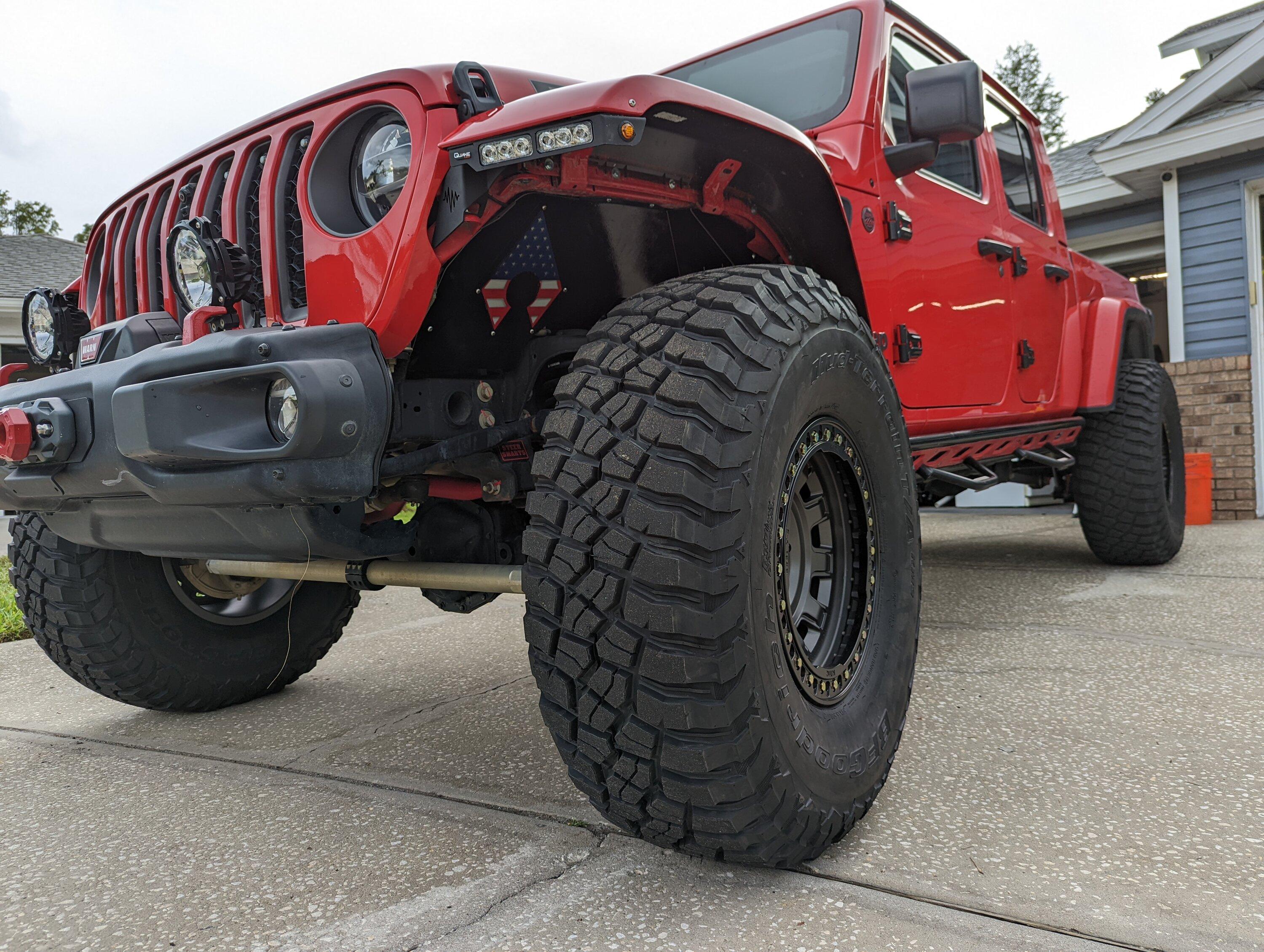

Im seeing more people use their OEM liners, just cut and bolted in other places than the original spot. I did the AAL high fender brackets and lights but kept as much of the inner fender as possible. I don't get as much clearance as I would taking it completely out but Im not a fan of metal inner liners and until I come up with a better plan this will do. It also kept a bit of the rigidity it brought to the fender...
