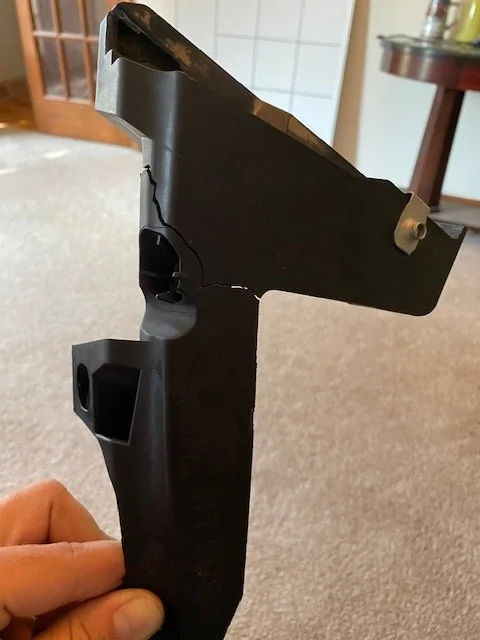

UPDATE: Ordered a new fender flare as it was also slightly damaged. We will see if the bracket comes with new flare. However, taking another poster's advice, I researched plastic welding and bought a cheap plastic welding tool from Harbor Freight. Success! I was pleasantly surprised at how well the plastic welding worked at putting the piece back together. Obviously not as strong as originally, but it should hold in the mean time.
Long story short: I am an idiot, broke the mount (not the light itself) for the turn signal on the driver side. I've looked through all the part sites and I cannot find the piece. Which leads me to believe that it is either a component of the fender flare itself (but can't see it in any diagram) or doesn't exist (duh it has to exist).

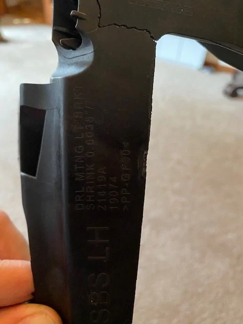

I've pulled the broken piece and it has this information stamped on it:
SBS LH
DRL MTNG LT BRKT
Shrink 0.0035"/"
21419A
19074
> PP=GF30 <

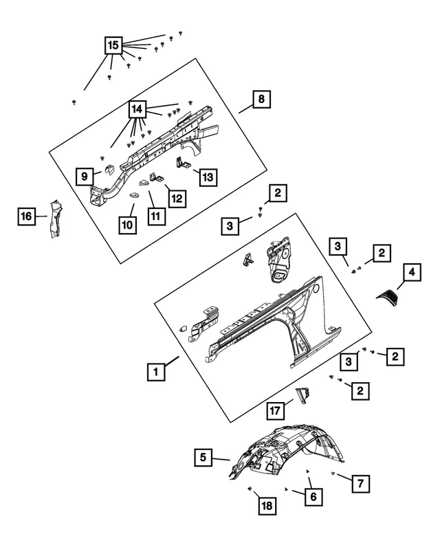

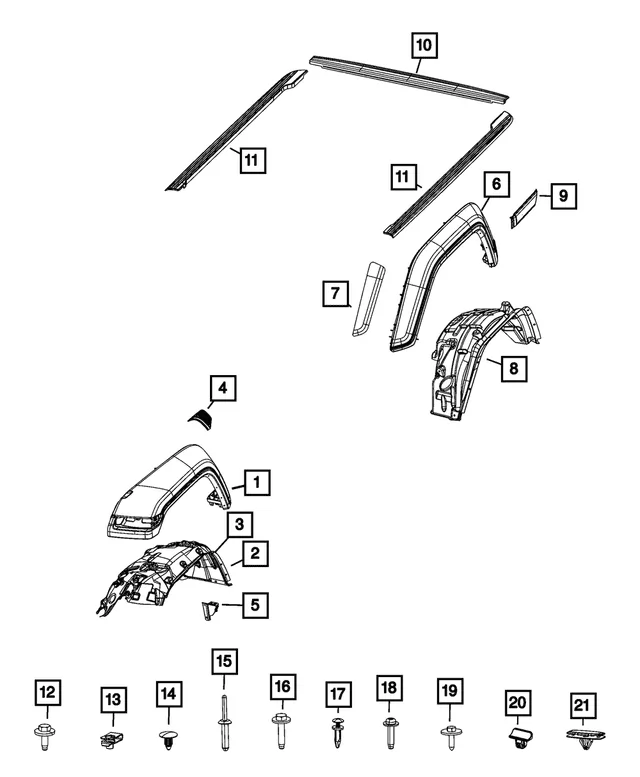

I found this diagram on Allmoparparts.com , but I am having a hard time finding the individual pieces.
They are a forum sponsor, and can probably help.
Jeep Gladiator UPDATE:  Help Locating a Part I'm going Crazy! - Picture Attached. 1601143305675
Thanks for looking this up. I did see this, but I don't see the bracket part I need. I think someone else is correct that it is part of the flare itself.
