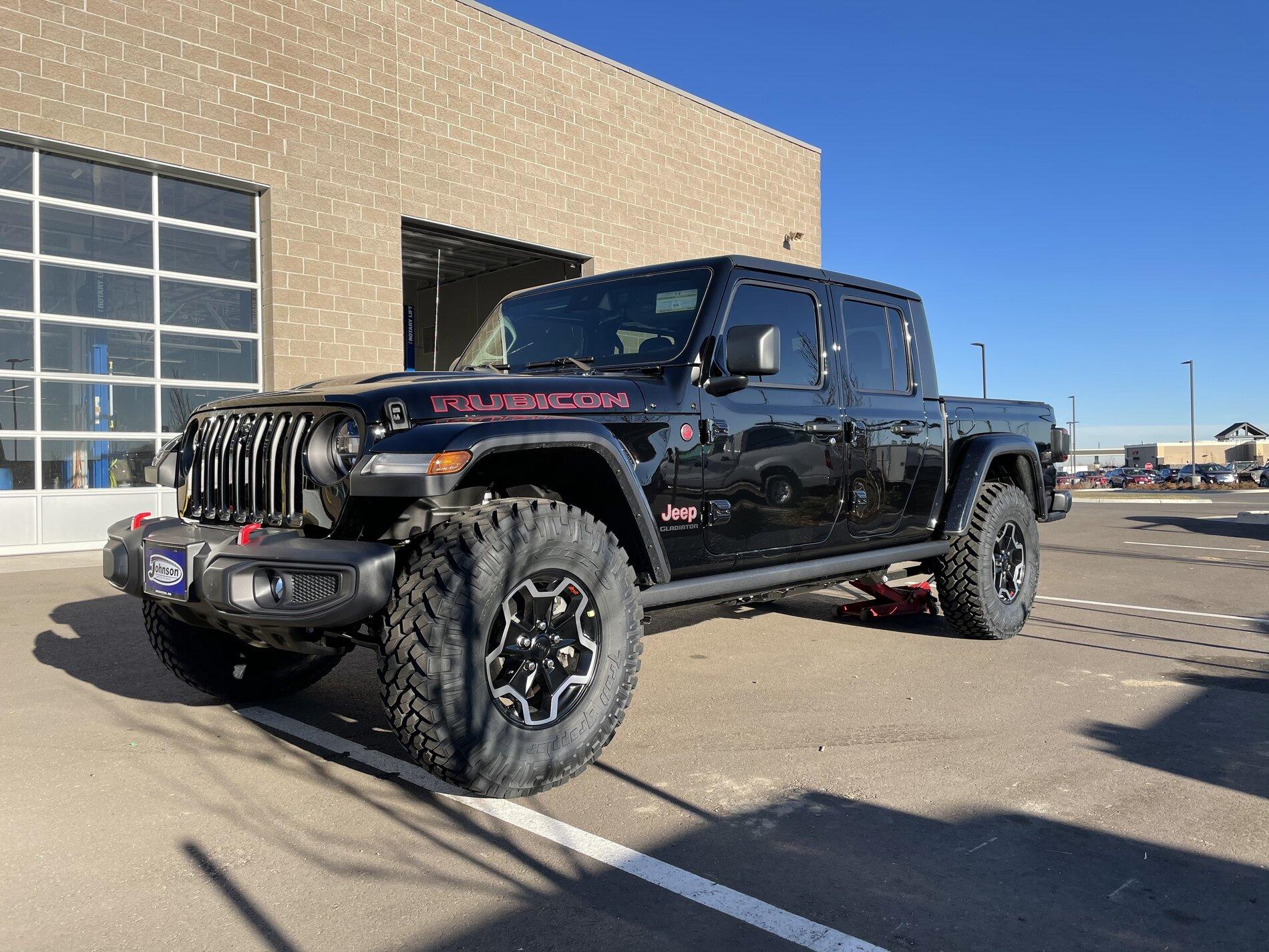

Ok, just had my Nitto Trail Grappler 35x11.5x17's put on with no lift. Love the way they look.... but not so pleased with the loss of power.
They are roughly 9lbs over my stock tires, but make a considerable difference in acceleration. It also seems that the transmission is working a bit more.... as to be expected.
I am hoping to add something down the road that wont affect my warranty like a pedal commander or re-gear. I don't need more hp or tq… just something to get me off the line without the turbo lag.
But for overall ride quality, I am very pleased with the noise and hardly any wandering. MPG.s have also taken a bit of a hit... currently a mile or 2 difference for sure.

I noticed the same with my gas JT, it is interesting that many on here claim no difference gas or diesel when going to larger tires. surprised it is that noticeable on the diesel I would think the low end torque would really help.

Yea, I think I am just being a little pickey. I just want the instant go like my 2013 gasser rubicon with 410's and 34" tires.

I noticed it at first also but after a little time, the new performance becomes normal. I don't even think about it anymore. Give it some time and see how it goes!

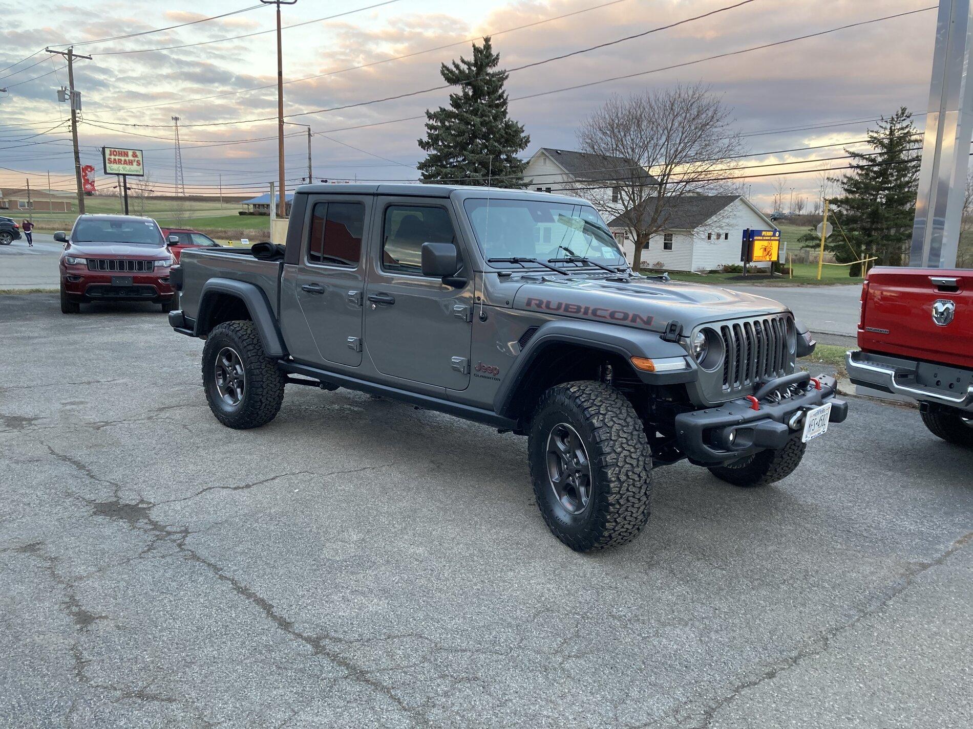

Yup - same here as the OP. Some sluggishness when I went Nitto Ridge Grappler 285/75/18s on the OEM Overland wheel, and some hunting between 7th and 8th gears. Have since calibrated with my Tazer Mini (took a few tries to find the right tire-to-speed ratio/size) and the MPG and shifting is doing better. Nonetheless, a hit to the MPG (1-2 MPG on local streets) indeed, and definitely less 'take-off' from standstills. All that being said (written?) - still happy with the choice in terms of looks, performance, and no humming on streets.

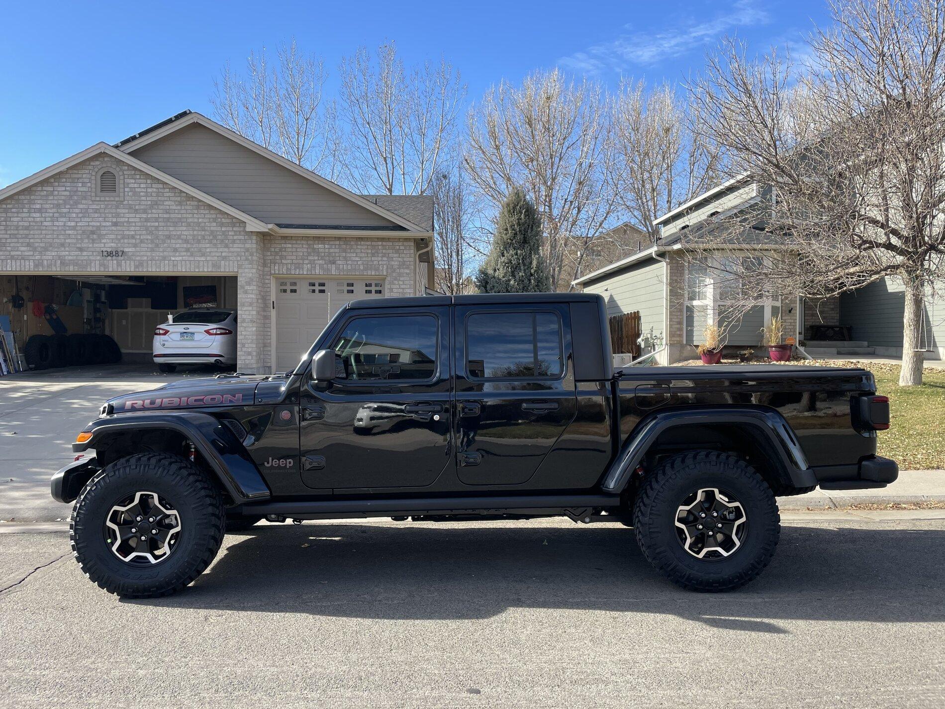

I've been running 35s on my EcoDiesel since I picked it up on Oct. 23 (BFG KO2s, 35x12.5x17). Did about 800 miles that way, then added the 2" Mopar lift last week (and got the recalibration for tire size). Added another 500 miles since then.
Definitely better since the recalibration. I managed almost 24 mpg on a 400 mile highway trip. Seems to do worse on MPG over 60, and hits a sweet spot from 40-55 where I was topping out over 24. overall milage is around 22, about inline with everyone else 2 mpg drop. There was a little off-line hesitation at first, but I've either gotten used to it or the recalibration worked that out a bit. Much less noticeable now. I didn't see any top-gear hunting on the highway, and a good part of the trip was crossing some East Coast mountains, so elevations shifts of up to 1000 feet or so. Seemed to hold 8th pretty well.
Overall ride, even with the lift, is excellent. Surprisingly smooth. Very happy with the look and feel.
