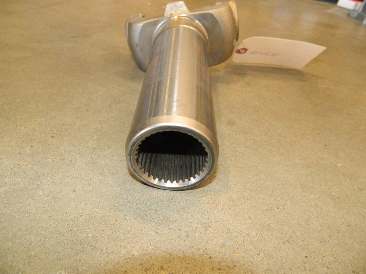

I've been made aware of a type of adjustable, telescopic driveshaft that is meant to freely extend and retract as the axles move up and down with the suspension. I'm not sure what the quality of these are though.
Edit: here's a portion of such a driveshaft.
Pretty common. It is called a slip yoke.
