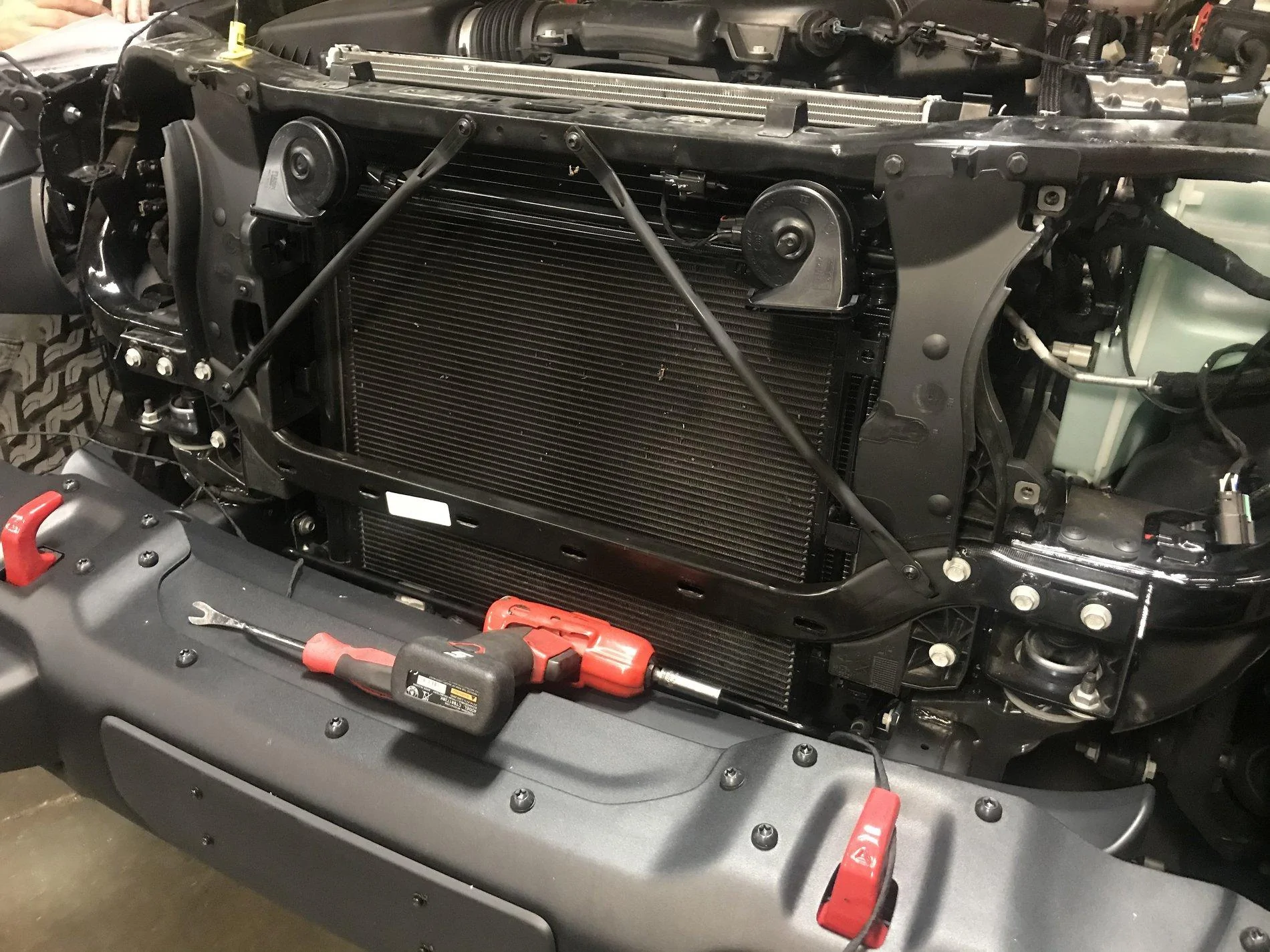

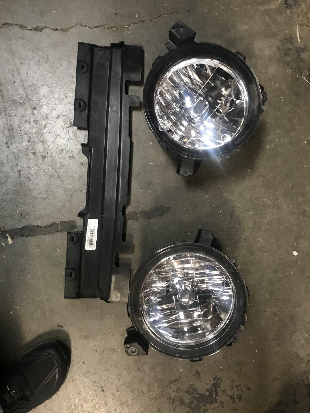

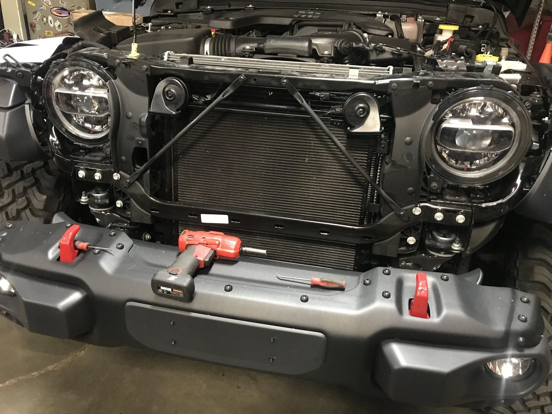

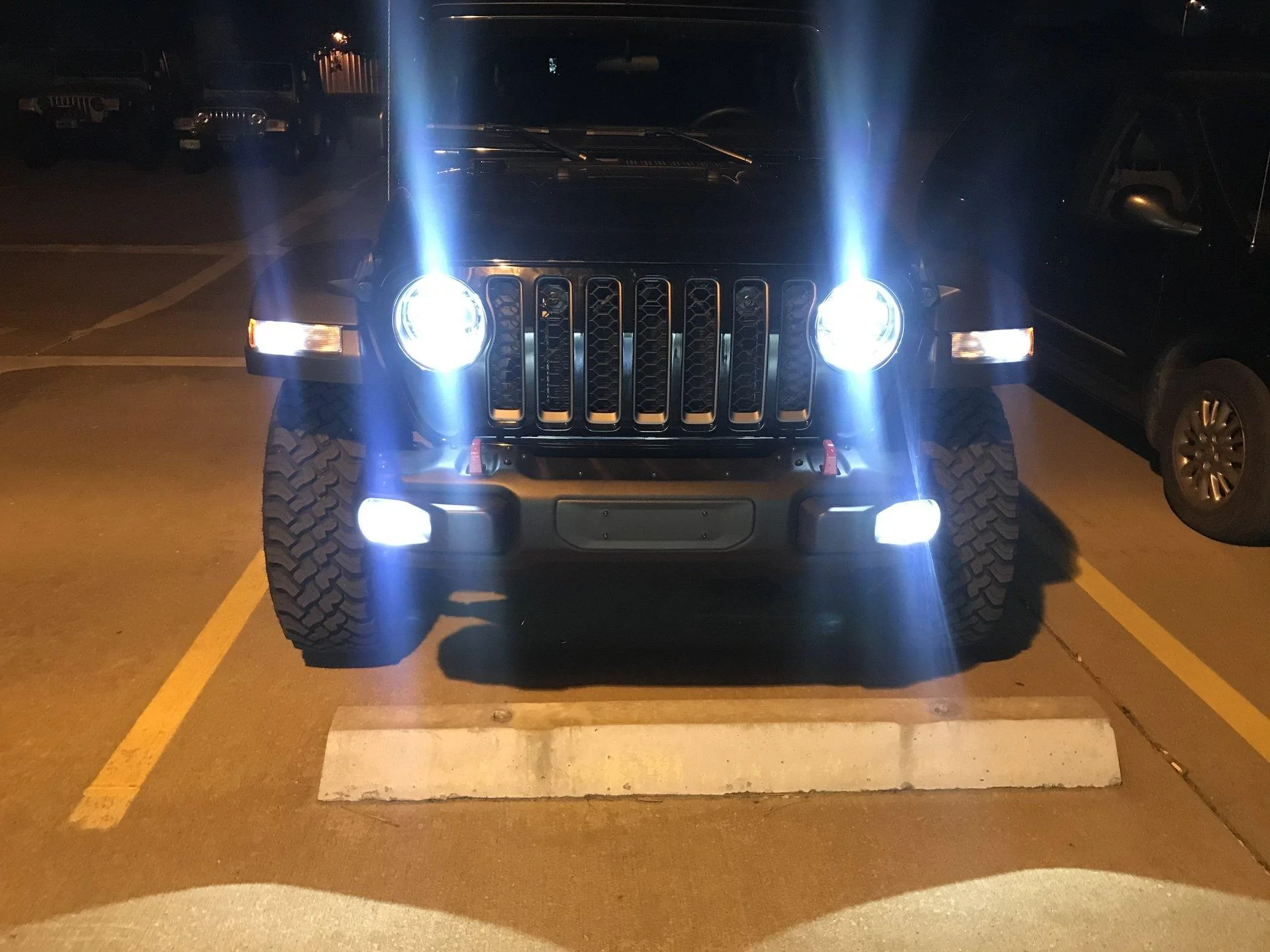

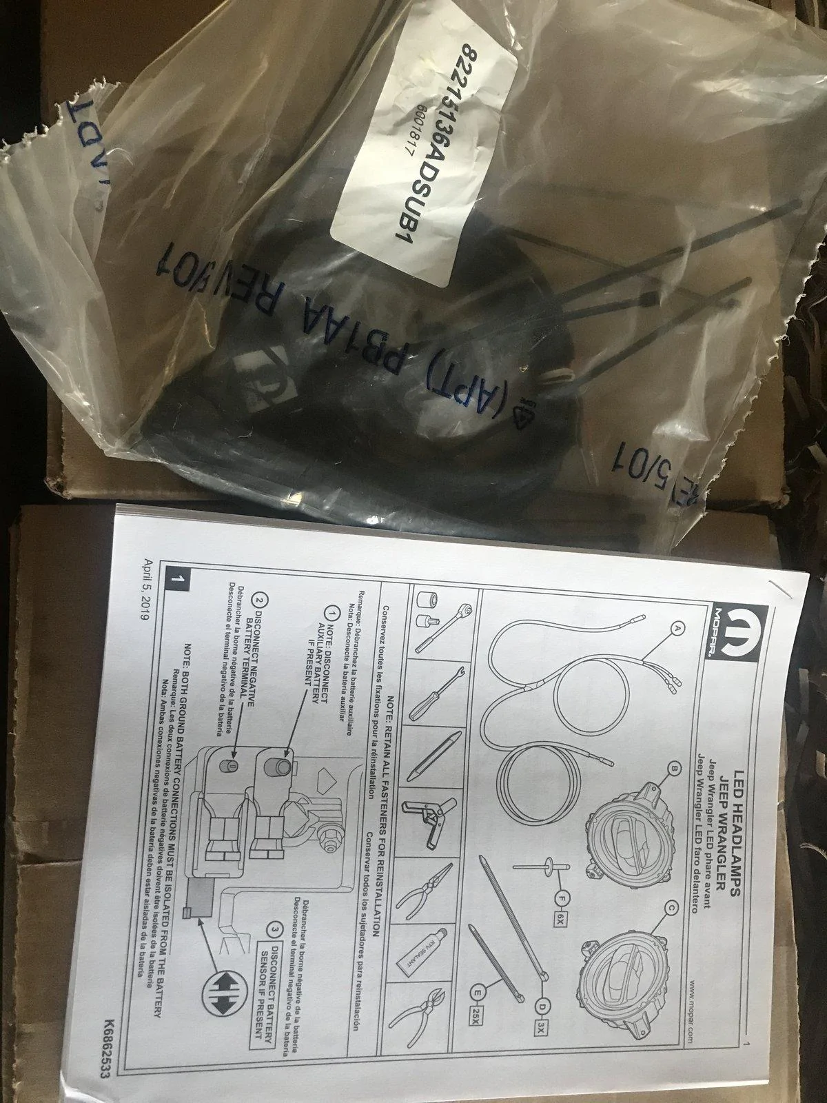

    Did the OEM LED headlight conversion. Had a friend do the wiring. I felt it was above my skill set to do on my own. LOL. Replacing the headlights themselves is straight forward. Wiring to the BCM is a complete pain. Adding the wiring harness to the headlights is easy but once you get to the cab part that’s where the real fun begins. LOL. Unfortunately i didn’t get any pics of the cab portion. Space is a little tight. Might think about removing the passenger seat to give yourself extra room if you’re thinking about doing it yourself. Waiting on a tazer to arrive to do the programming so the high beams and halos function properly but at least the low beams function as they should. I forgot how well LEDs work. The difference is huge from the halogen. Definitely recommend the upgrade.
