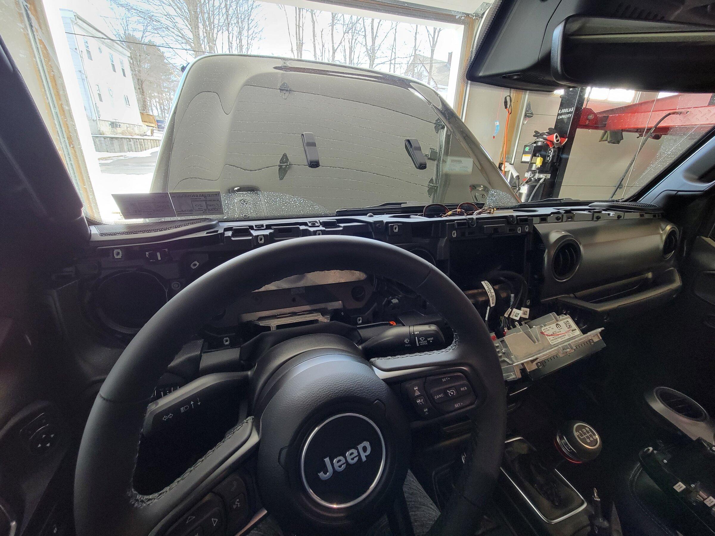

I took delivery of my 2022 Sport S that I optioned up with the 8.4" Package, Alpine Audio, both Safety Packages, Leather, Cold Weather, and Popular Equipment Package. I mistakenly didn't check off the tech. package, as I assumed all of that was also included in the 8.4" package. To my surprise, when I took delivery of my JT two weeks ago, I had a fully loaded interior, but a base model black and white instrument cluster- uh oh!
I did a little research online, and ended up finding an instrument cluster out of a totaled 2020 JT with the tech package for $125 on lkqonline.com. I just recieved it today and only took about 20min to install it. Everything was plug and play, just had to unplug the old one after removing part of the dash, and then reinstall. Then just reprogrammed the odometer over OBD2 bluetooth, and it's good as new!
I'm super happy now as the car is exactly how I envisioned it! Didn't see the need to pay more for a higher trim model as I have no desire for rock-climbing or much high-speed off roading. The Sport S with all the packages I wanted is a perfect truck for me!
Jeep Gladiator Upgraded Instrument Cluster - 3.5" to 7" Easy! 20220303_093642
Jeep Gladiator Upgraded Instrument Cluster - 3.5" to 7" Easy! 20220303_132733
Jeep Gladiator Upgraded Instrument Cluster - 3.5" to 7" Easy! 20220303_134204

Wow, I am surprised it came with that dash, thought the larger screen was standard with Sport S.

I take it that the truck has no idea what's going on and you have to tell it that there's a new instrument cluster and re-read the mileage from wherever its stored?

Funny thing is that when you add the 8.4 to the Sport S on the website, it also makes you add the technology package, and upgrades the instrument panel. Weird. nice work!

Will definitely keep the old one around if anything weird happens. Although at ~$100 a pop, I'm not sure I'd worry too much about the warranty anyway.

Yea I was confused as well. Apparently if you select the 8.4" package and the popular equipment package, it cancels out the technology package, and you have to then re-add that one manually. Looking back, doing that would've cost me an extra $1,000, so I'm actually happy I ended up in the situation I'm in.

The swap was super simple. Maybe 20min total? Just a few screws and a bunch of clips to pull out.

Super glad I found your post this morning because I am apparently in the same boat!! Was looking at some other stuff last night on this site and suddenly came to the realization that I got misinformed by the dealer AGAIN. Still super irritated. But this is nice to know that the upgraded cluster can be installed easy enough.
Although I checked that site you linked to and it looks like from wrecked vehicles. No dash for Glad or JL currently available. I wonder what MOPAR would charge...
