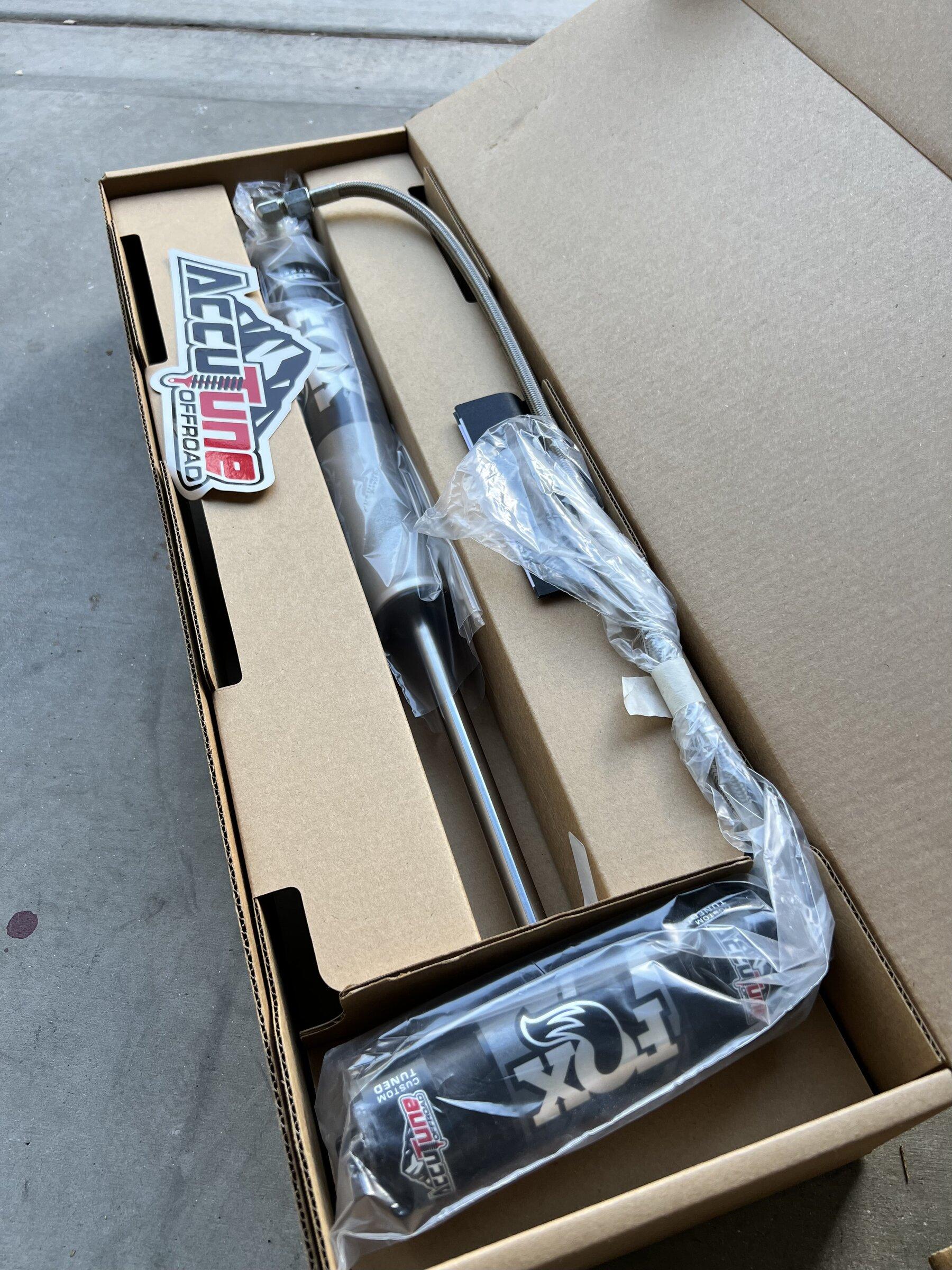

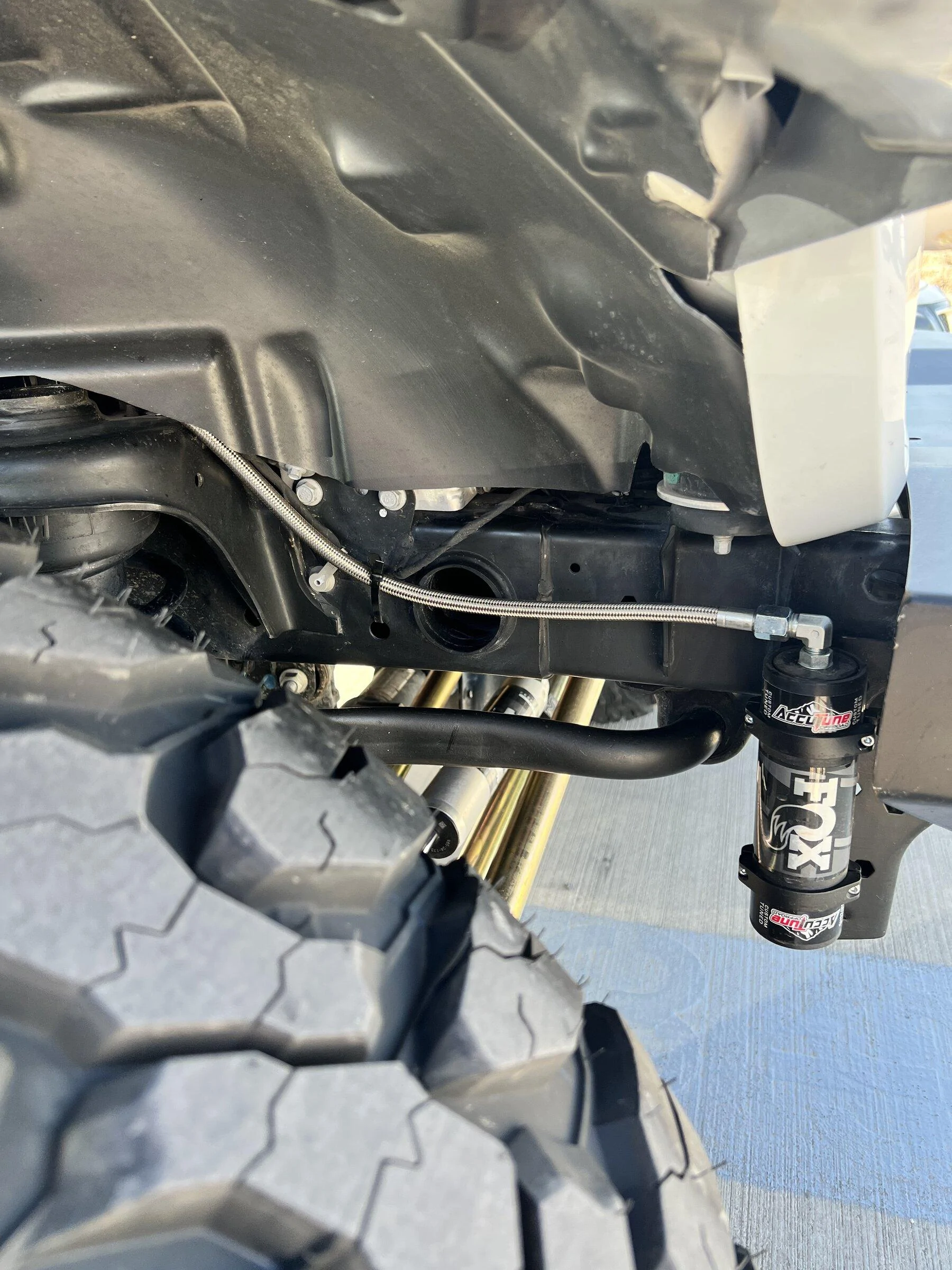

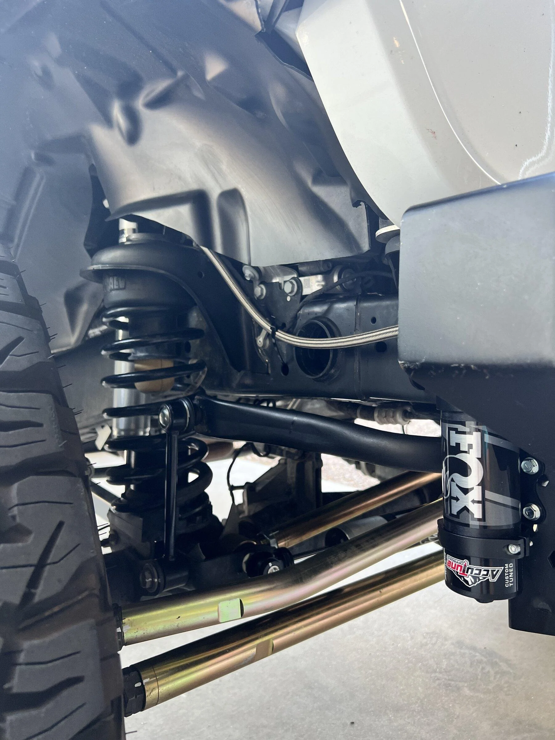

Going from stock Max tow shocks, to Rubi Fox, and now to Fox 2.0 remote reservoirs.
All I can say is wow, what a difference. Stock for the ride was plush and soft, with Rubi Fox, the ride was stiffer (not in a bad way) but I got a lot of see-saw action. I was not a fan of that and that’s the main reason why I decided to spend the money to upgrade.
Now, I was going to get the regular 2.0’s but after a lot of research, they are probably marginally better than the Rubicon shocks.
Which comes to the 2.0 remote reservoirs. These feel really good. The best of both worlds to be honest. A very planted feel but in a soft and stable way if that makes sense.
Plus, I purchased from Accutune and had it custom tuned for my purposes and weight on my truck. Very happy and can’t wait until I get the rears in a few weeks.
Jeep Gladiator Upgraded to Fox 2.0 Remote on Max Tow CCACFEB0-3844-4F86-B7F1-D74C4F7FD7B6
Jeep Gladiator Upgraded to Fox 2.0 Remote on Max Tow 548926B6-0E6D-4959-A4F0-9E7705966698
Jeep Gladiator Upgraded to Fox 2.0 Remote on Max Tow 6FFFE3CF-162B-4F14-9390-07C5ABAF5997

Great to hear about your install. I'm still waiting for my rears, I think those will make the biggest difference. Thanks for the tip for the rear install as well. Do you have pictures of the rears installed?

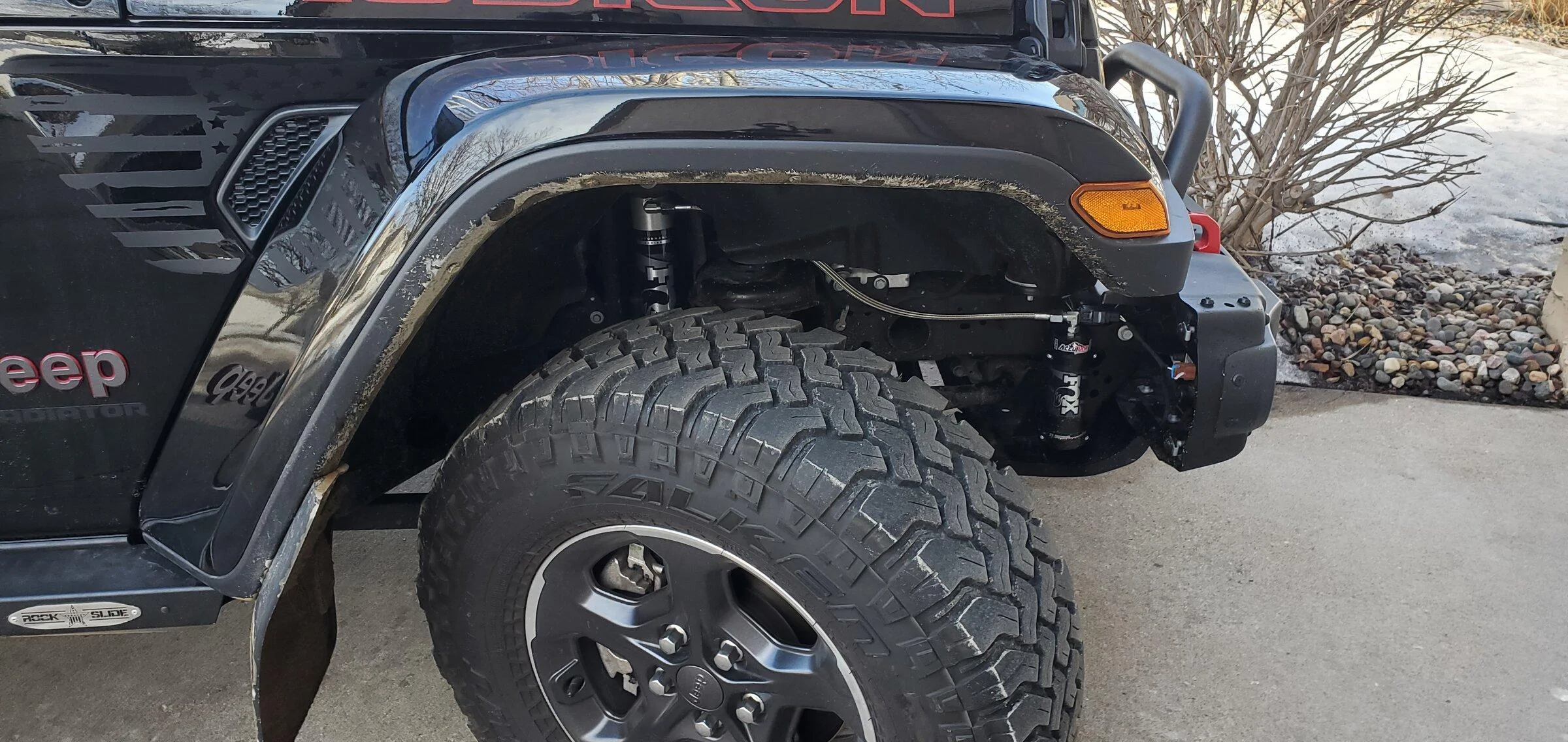

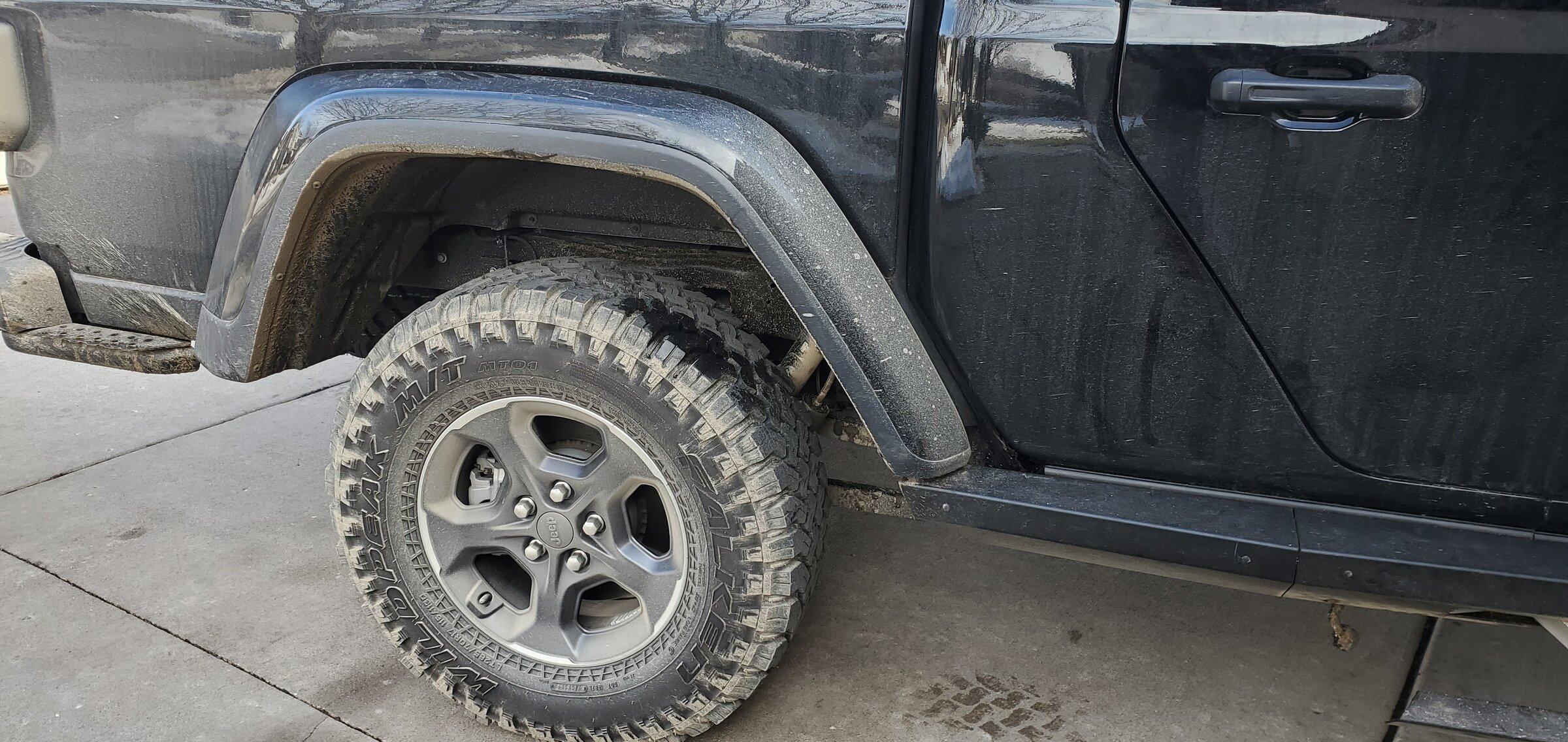

I have one pic of the rear, but test drove it on a muddy dirt road and it's hard to see them. I'll try to get the truck washed and take a better pic.
One small disappointment I have is that when you mount them the way they tell you, it's really hard to see the reservoir on the rear. The instructions tell you to mount them towards the front of the truck and which puts the reservoir lower on the shock so it's obscured by the tire. Not a big deal because I bout them for the performance (ok, and the looks), but they don't have the look of the Mojave's where the reservoir in mounted higher on the shock mount. Not sure if it's worth exploring other options for mounting the reservoir, but it's not for me at this time anyway.
I posted some additional details in my original post on the shocks in case anyone is looking into these in the future.
https://www.jeepgladiatorforum.com/...-2-0-remote-reservoir-shock.54783/post-918068
Jeep Gladiator Upgraded to Fox 2.0 Remote on Max Tow 20220317_103837

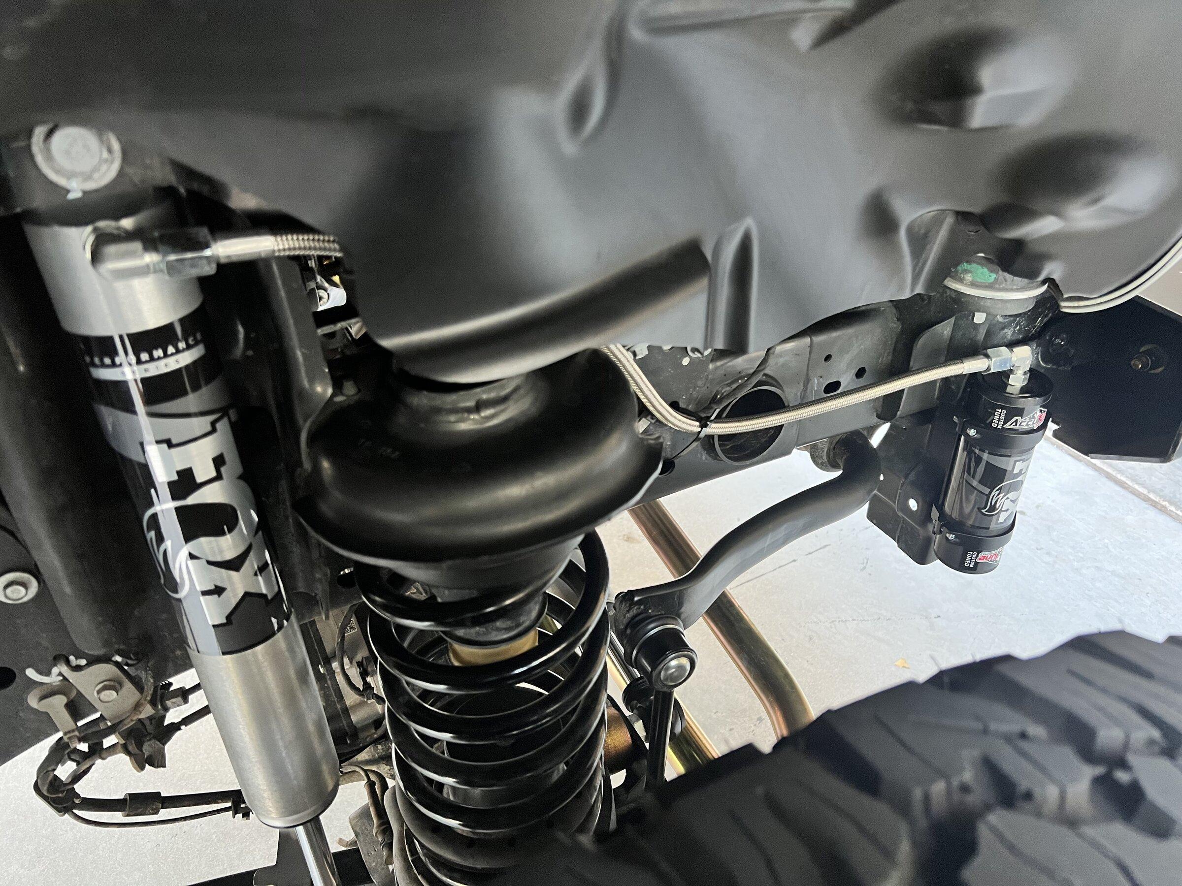

Thanks for the pictures! In regards to the front, the bracket should be flipped the way you did it. In the booklet, it says the bend should be towards the rear for 2.0's. You did it right.
It is a little unfortunate about the reservoirs for the rears. I was hoping it would look similar to the 2.5's. I wonder if the rears can be either L or R. If they are, it would flip the reservoirs to the top? But like you said, function > form. Your truck looks great.
They can be either Left or Right depending on how you install the reservoir mounting bracket. It looks like there's room to flip them around so they could face towards the back, but I'm not sure if that would impact performance or cause rubbing or other clearance issues. Either way, I think they'll still be to low to be visible like the 2.5's.

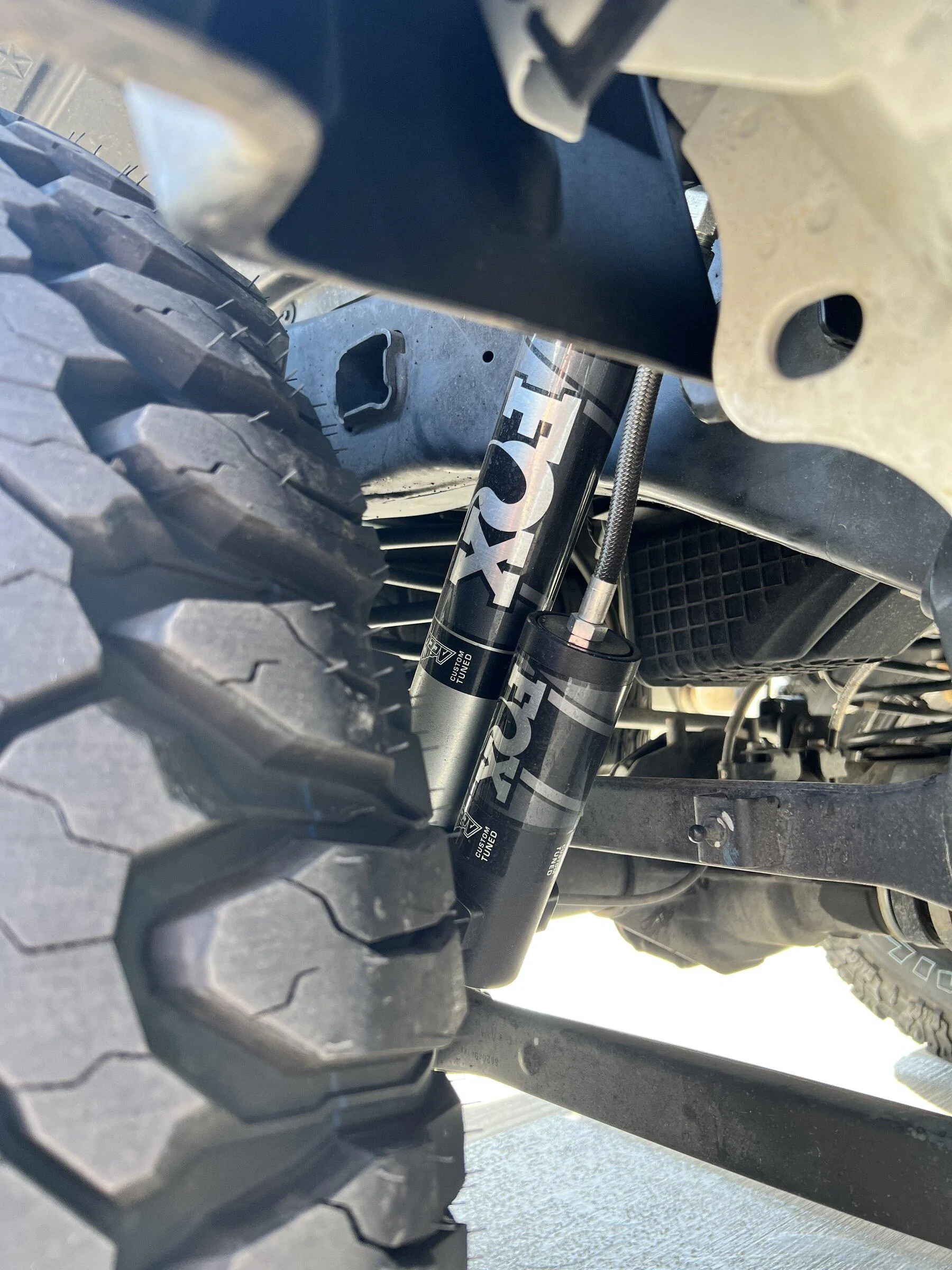

Had my rears on for a couple weeks so far and I absolutely love these shocks. The truck rides very well overall. For daily driving it feels great and absorbs any bumps it goes through. Highly recommend if Fox 2.5’s are out of budget.
