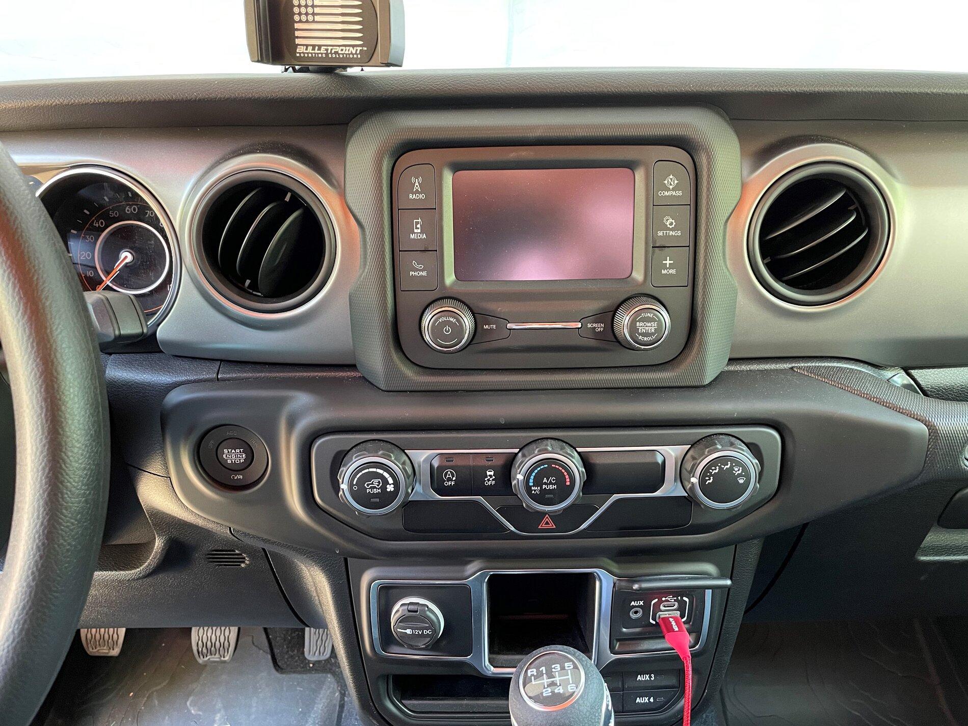

I have a 2020 Sport and after going two 10-12 hour trips I realize that I miss having a high speed multi-media system. My Ram had CarPlay, apps, and my guidance mapping was shown on the screen. I like the way my Jeep is set up and I don't want to trade vehicles.
I did a search on this site and did not find the info I am wanting.
One compatible system I found did not support the back up camera. Has anybody replaced their base system and kept the other features of the system intact?

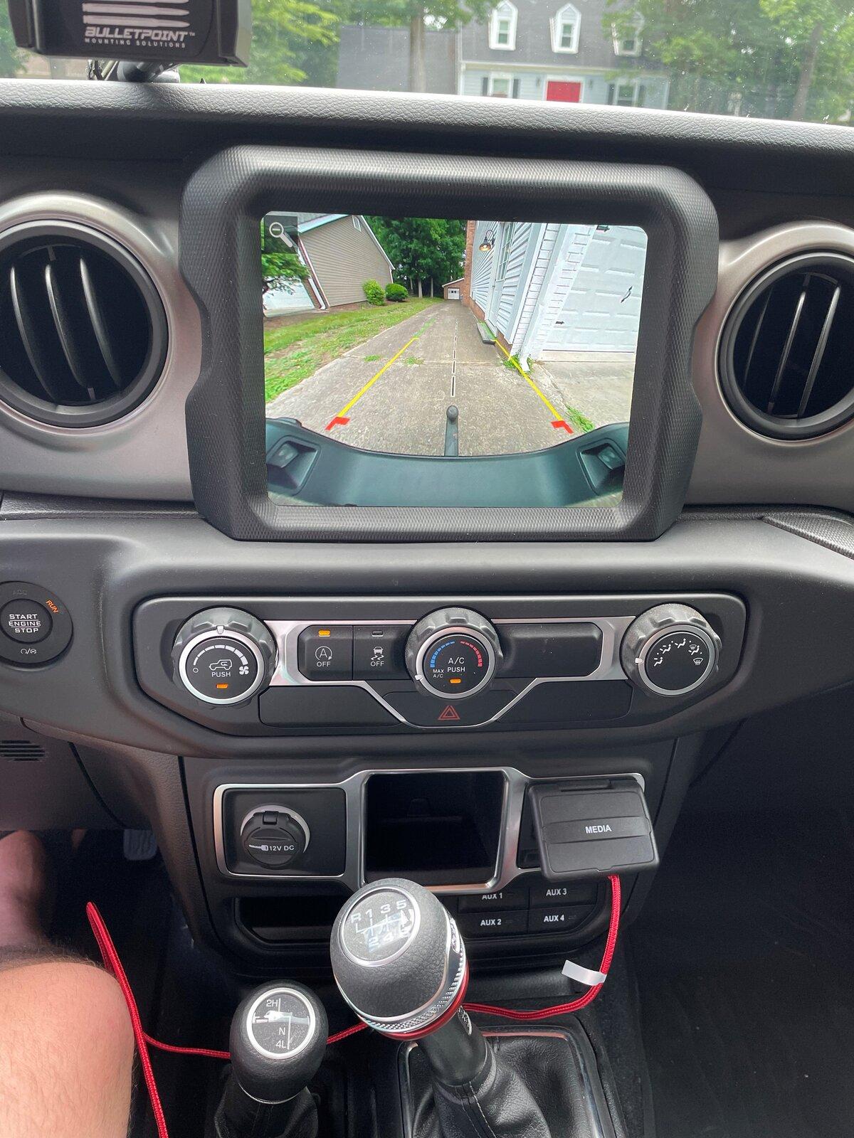

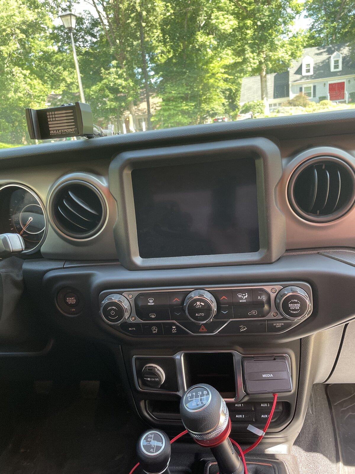

I did the same in mine, swapped in the 8.4" to replace the factory 5". Super simple, takes about 10 minutes to do. Awesome head unit with Carplay etc, works great.
Search my posts, I have lots of pics and info, but here's one of my Sport with a 8.4" swap.... all the wires are the same, everything just works, super easy, and my favorite mod by far because I enjoy it every time I drive.
I then did upgrade the AC control panel too ($150 used), so will post that pic too. Great easy solution to your problem.

That's worth it right there just to have the larger backup camera screen ^^^
