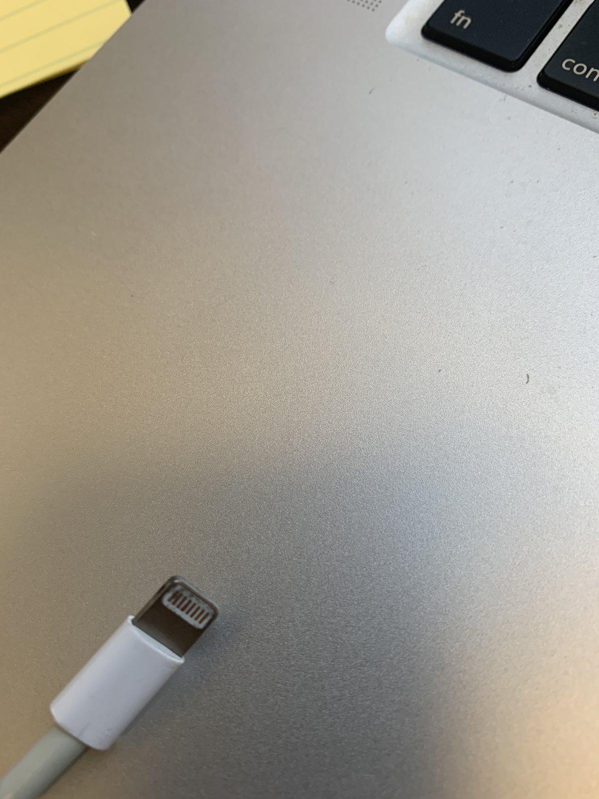

Some USB cords only work if plugged in ONE direction...for example, the one that came with my iPhone wonā€™t charge/connect to CarPlay unless I flip the connector 180 degrees when I plug in. To remedy this, I used a permanent marker to add a dot to the side of the cable that needs to face the phone to properly connect. I bet you guys are having the same issue!

I'm confused...for my Apple USB charging/data cable, there is literally only one possible way to plug it in to a USB port.
I have an iPhone 10 and this is the end that plugs into my phone...if I plug it in ā€˜backwardsā€™ (which feels just the same as plugging it in the correct way!) sometimes nothing will happen and other times Iā€™ll get a ā€œaccessory not supportedā€ message on the screen.
Some USB cables can actually be plugged in upside down into the USB port too...Iā€™ve done it with this exact cord.
