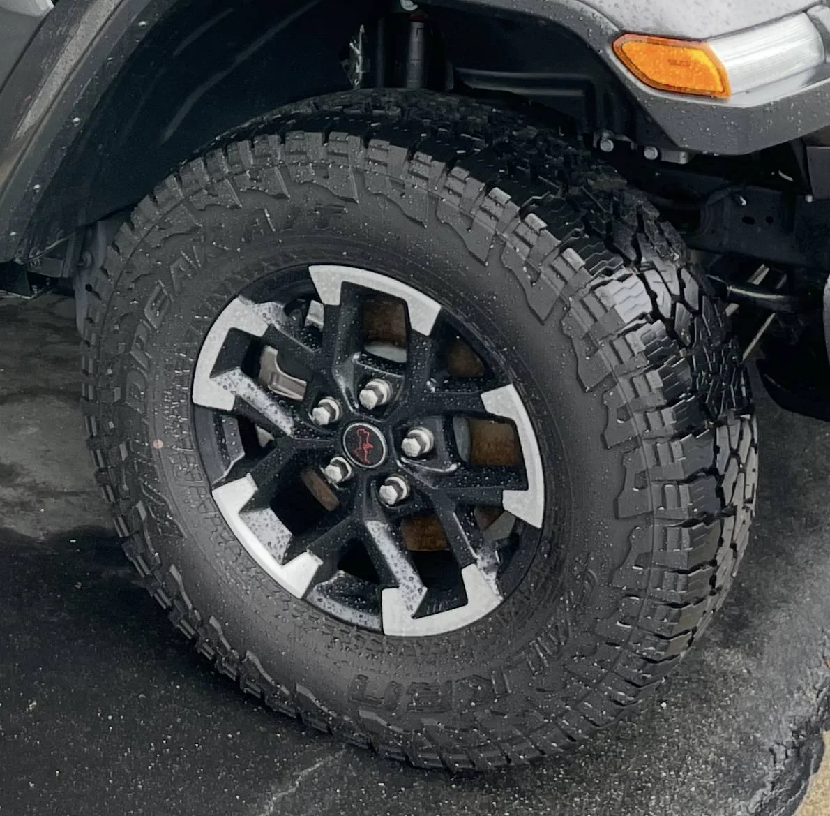

I have the stock wheels and tires that came with my Gladiator. I have less than 200 miles on my rig but I’m thinking for when the time comes for the first rotation. I see the center caps appear to be aluminum.
The round center section of those should pop right out by pushing it from the rear, at least they did on my original wheels as well as a set of Wrangler take offs I have
