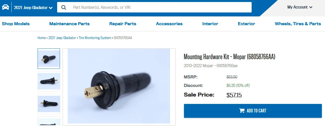

Yeah, I think you are hosed if wanting to recover full threads then. Like @Lunentucker mentioned, the stem itself can be replaced separate from the sensor but you are probably going to need a tire shop to do it as the bead has to be broken off the wheel/tire to gain access. There is shade tree methods to do it at home but is a bit of a pain and run risk of scuffing your wheel finish.
If you have a tire shop do it, they may not take your bring in replacement stems and want to sell you theirs on top of the labor to change them out.

Here's the rubber stem kit:
tpms.com has them for $1.99:
