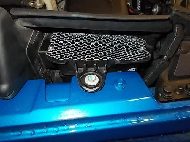

After cleaning out the air box, and replacing the filter element decided to fabricate a way to keep the little critters from gaining access a second time.

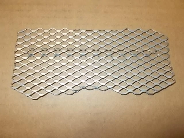

I cut the expanded metal screen from the surface of the old air filter element. Then cut a section of the screen to fit the inlet opening of the filter air box, and riveted it in place.

This first image is of the screen cut to fit the air inlet flange.

And this is the finished product riveted in place, & should do the trick.

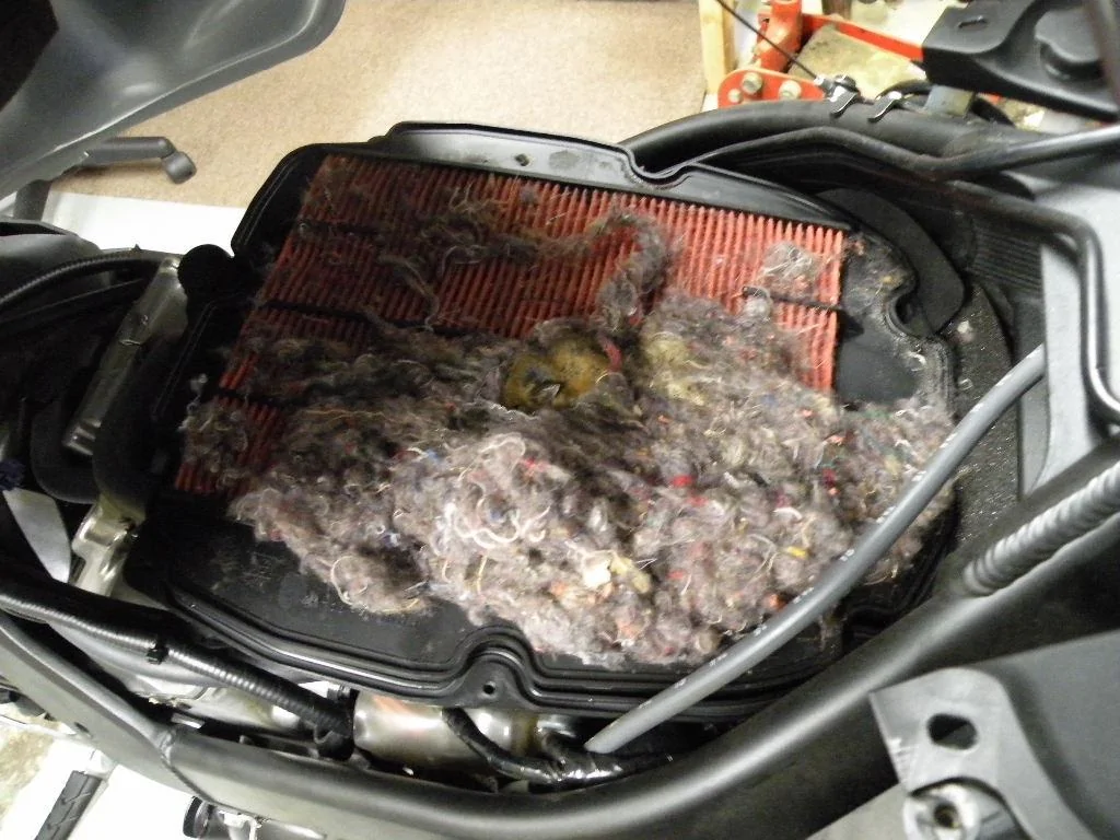

Here's a picture from my motorcycle. It's a 2007 Honda VFR. Bought the bike as a leftover still in the crate in 2008. So it sat in the dealer warehouse for months until I bought it. Put the bike together and put it on a dyno to see where it stands. It was way down on power. At first we couldn't figure out why. i started to dig, and this is what I found. 3 dead mice.

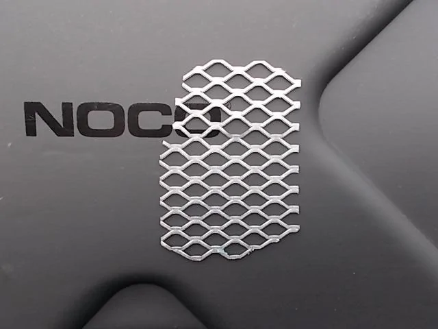

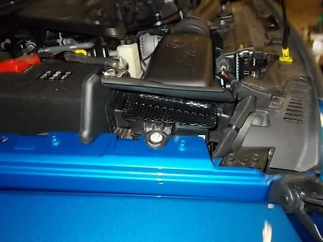

Decided the other day to dust some matte black paint on the new screen so it is less noticeable when the hood is up.

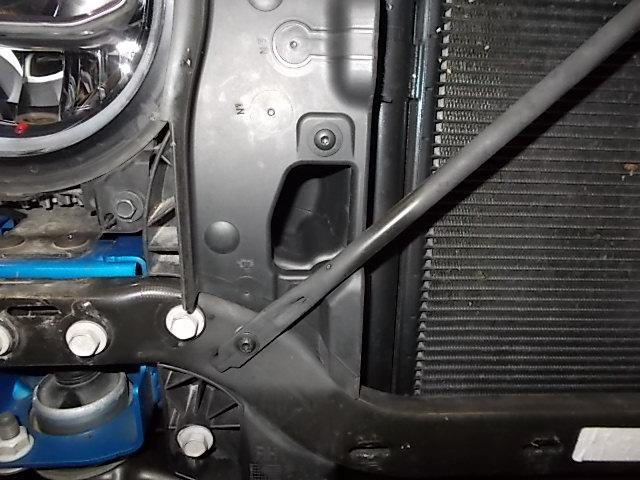

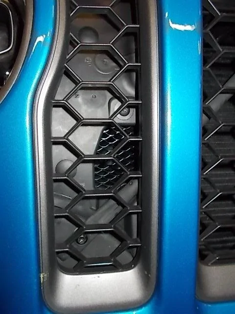

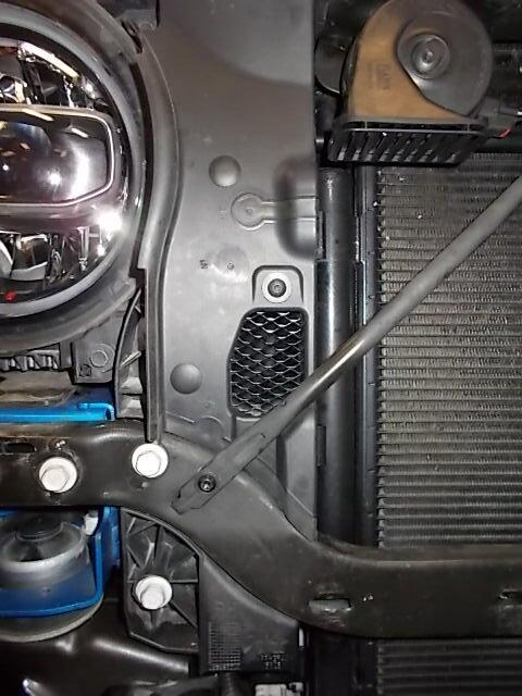

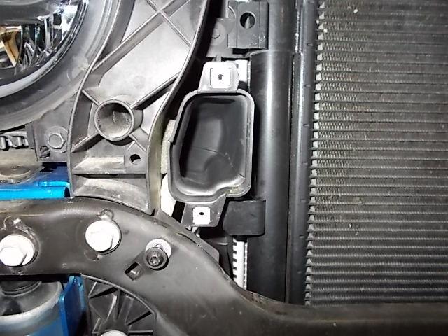

Had some time today, so made a screen for the small air intake duct in the grill opening.
Thanks again to Kevman65 for reminding be about this duct opening to the filter air box.:like:
Removed the grill, and the black plastic vertical filler panel on the passenger side of the radiator to expose the end of the intake duct.

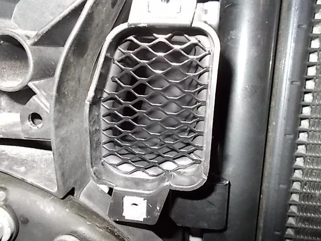

It has a nice stepped flange molded into the end, so cut another piece of the screen material to a tight interference fit.
After dusting a light coat of matte black paint on the screen, pressed it into place, then re-assembled everything.
Worked out pretty well, and coincidentally the hex pattern in the screen material matches the pattern of the grill inserts.
I'm now pretty certain that there won't be any furry hitchhikers living in my air filter box & chewing up the filter element for nest building material! 🐭🐿🦔

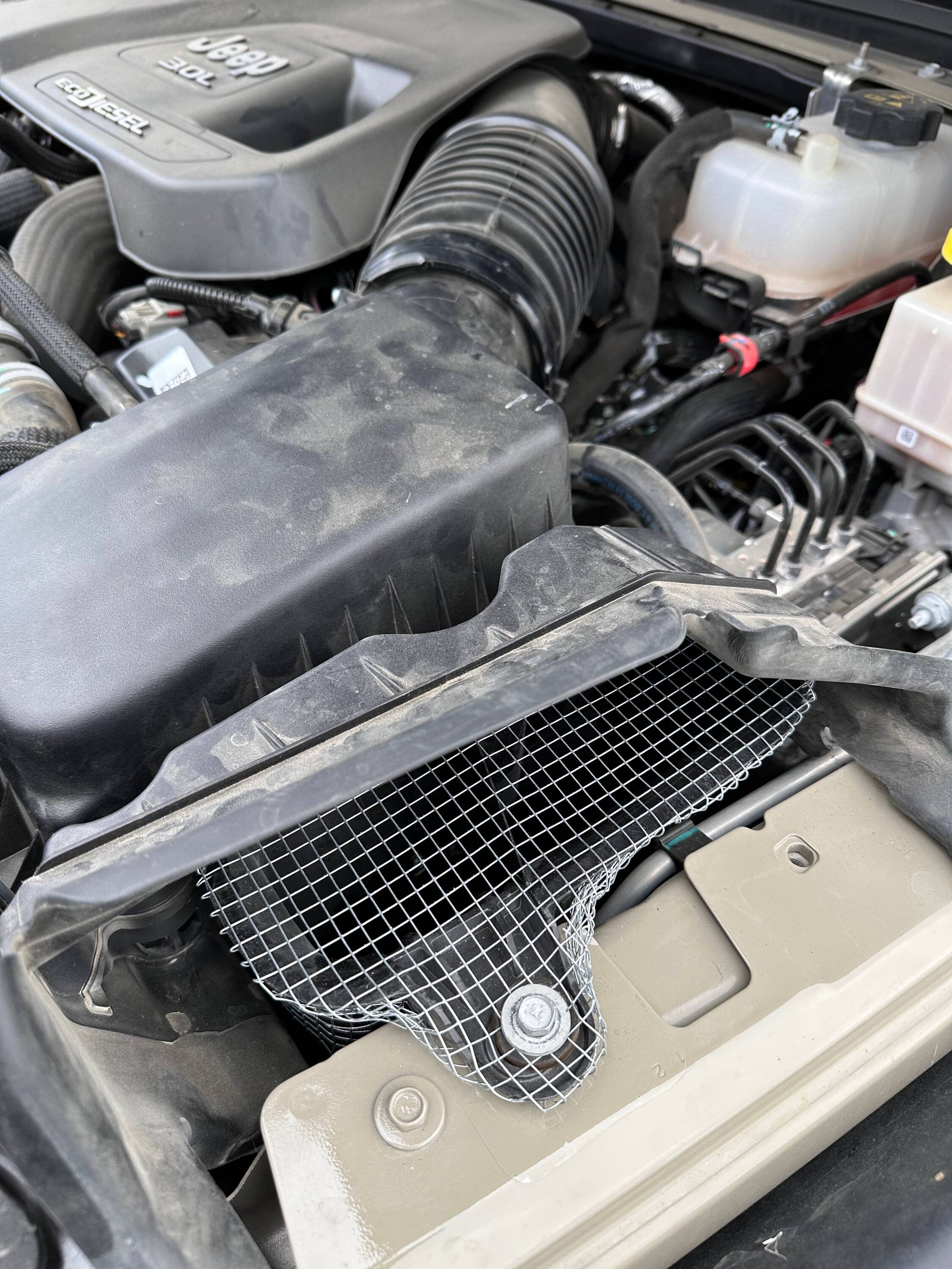

Interesting. I finally got around to trying to protect the air intakes today. I don't know if things are different on my 2022 diesel, but there's no HVAC intake between the wipers. Or on either side of the wipers - unless it's in a gap between welded panels under the cowl, totally inaccessible. I looked all over the cramped engine bay, and nothing visible there either. Totally perplexed.
Unsurprisingly, the diesel air intake is different too. If you didn't know, it's on the opposite side (gas passenger side, diesel driver side). And that little air scoop in the front grille doesn't enter the airbox at all - it just directs cool air up into a rubbery cowl around the main intake. But all air must enter through that main intake duct (except a pair of tiny water drain holes at the bottom of the airbox)
Anyway I did a job with 1/4" hardware cloth. I wish I'd revisited this thread first - the riveted expanded metal from the air filter looks a lot better. Maybe I'll convert over one of these days
Jeep Gladiator Mouse & Varmint-proof Engine Air Intake Project IMG_1173
