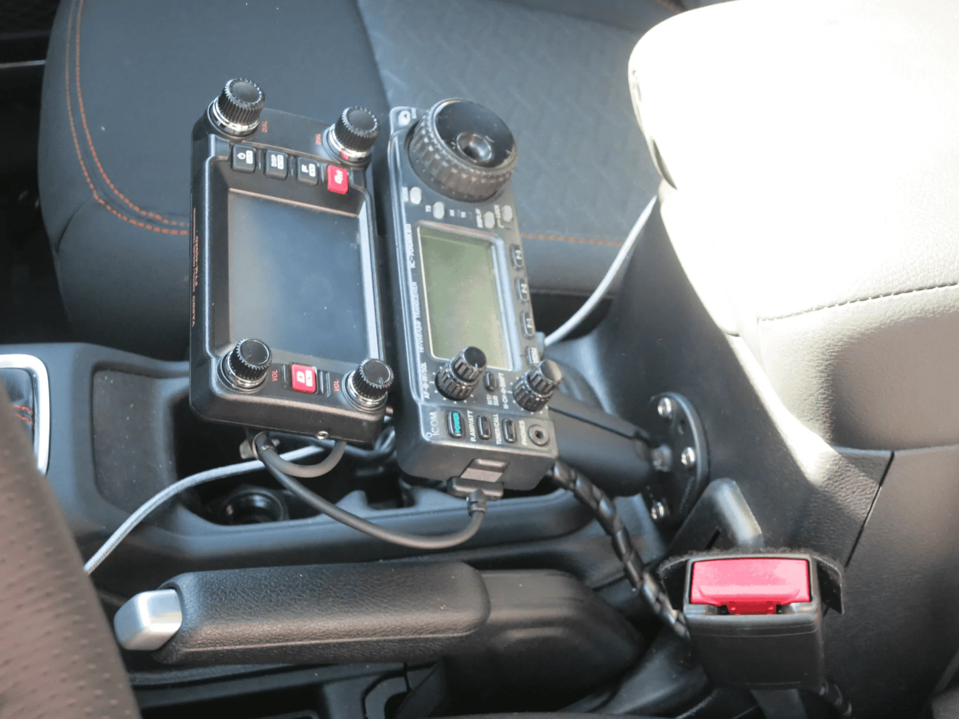

Here is a pic of my two control heads on a RAM mount.

That's two control heads in the picture. One control head is half the size and with the swivel mount you can raise or lower it or move it to either side. Its the only solution I've found that keeps the radio knobs within easy reach and you can remove and store it fast.
Ya I think that would drive me nuts, not enough room already

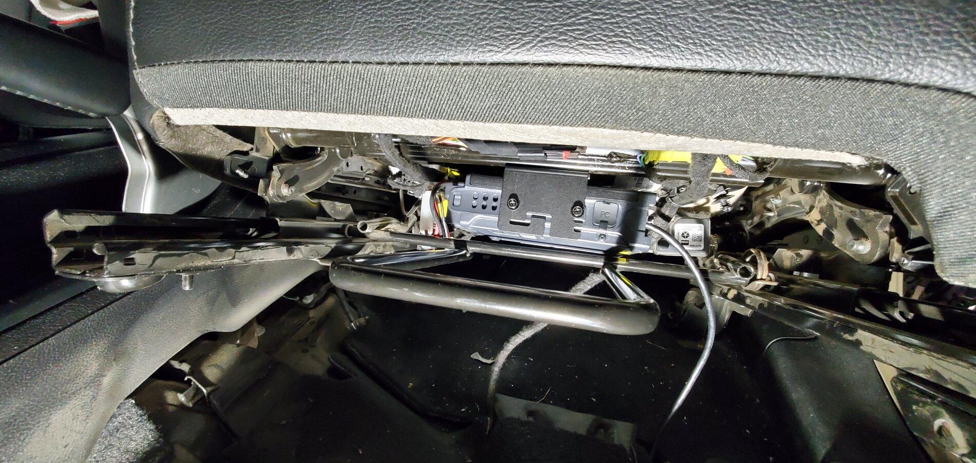

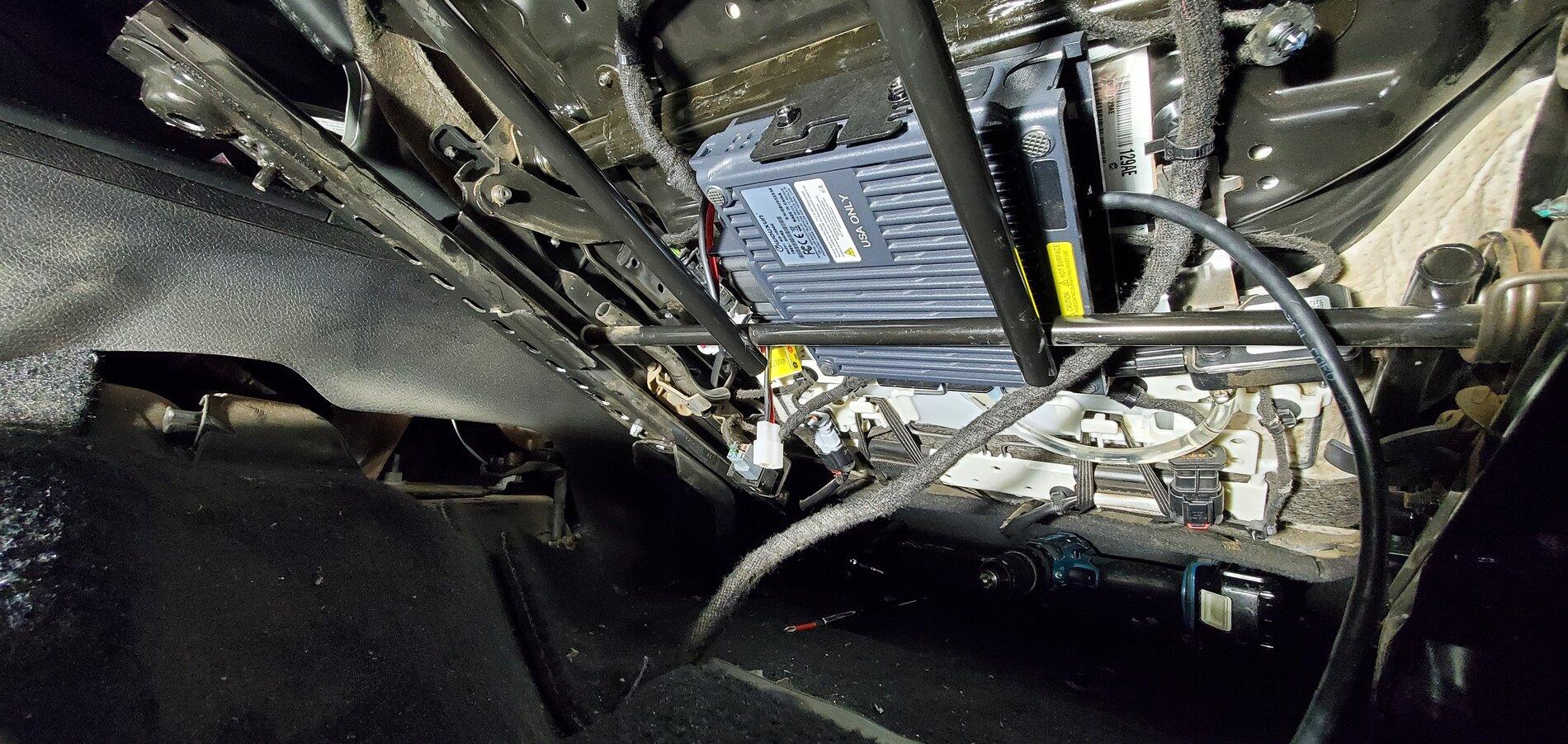

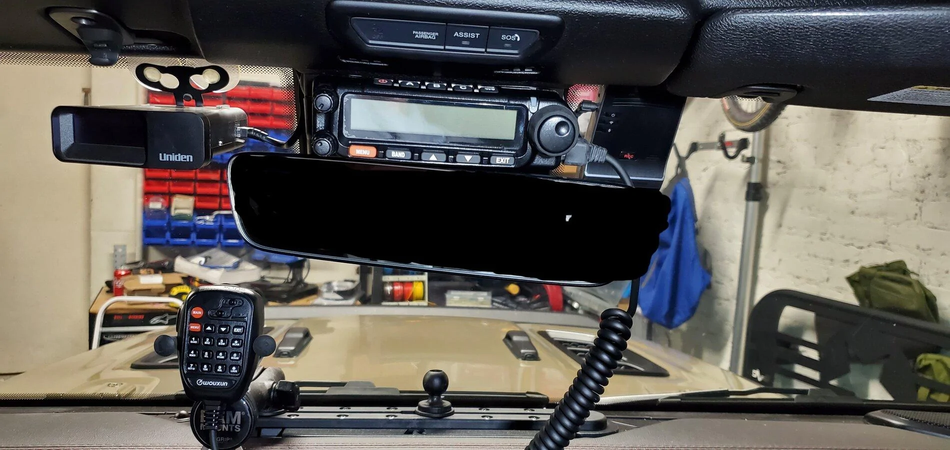

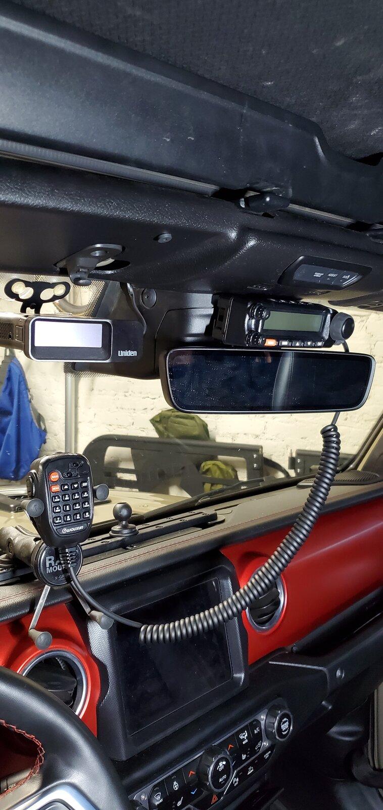

Hey has any one figured out a brilliant place to mount a two, way radio? Thinking maybe under the drivers seat?🍻
Here you go.
GMRS radio base mounted to underside of front seat. Faceplate mounted above rear view mirror.

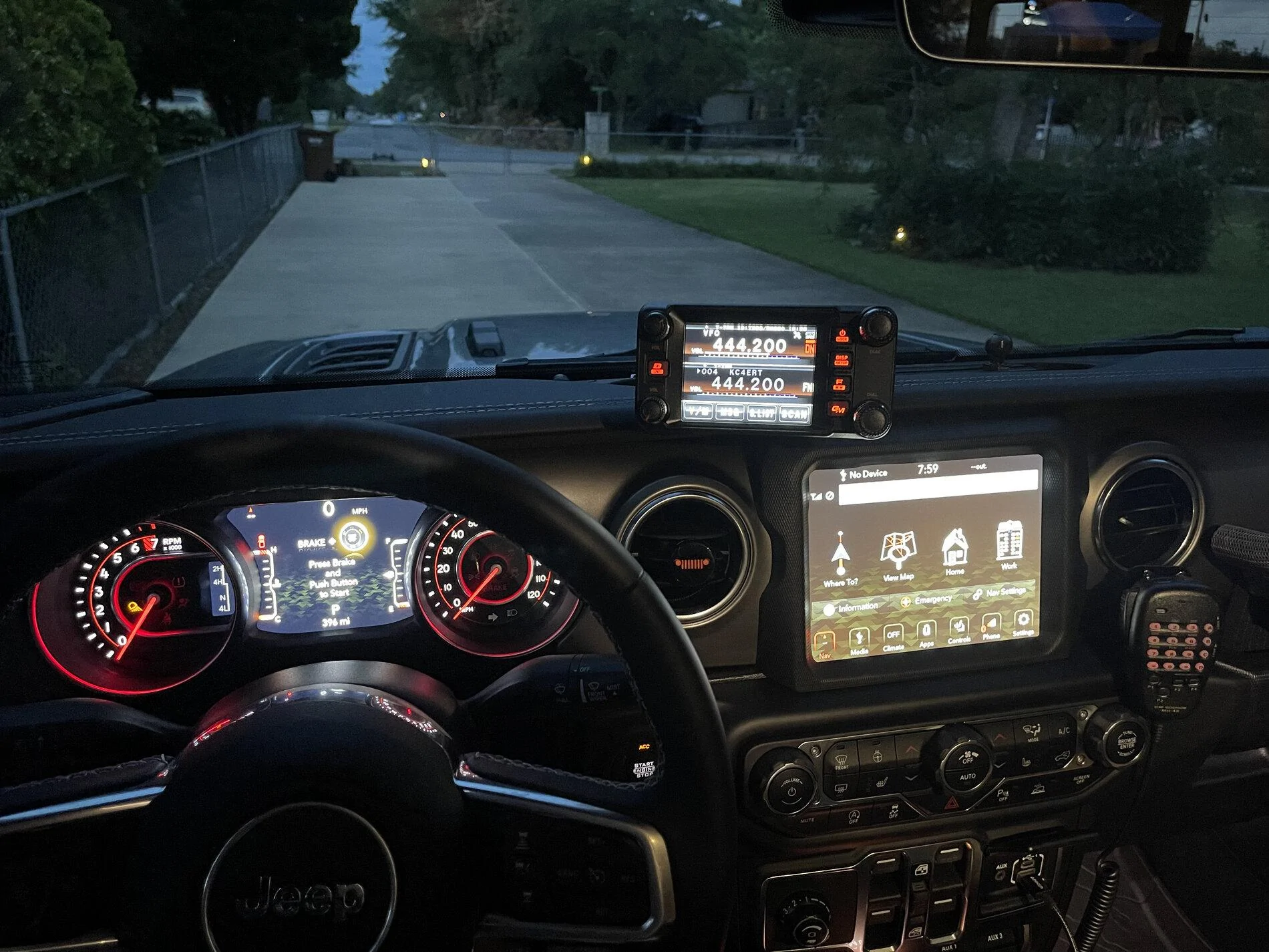

Here’s mine. Main radio under drivers seat. Using 67 designs mounting system. That’s a VHF/UHF ham radio. It does all kinds of things. ;) I have a Ham license.
Jeep Gladiator VHF radio install 00A8DA6C-B968-4A31-A34E-053696C7EDAD
