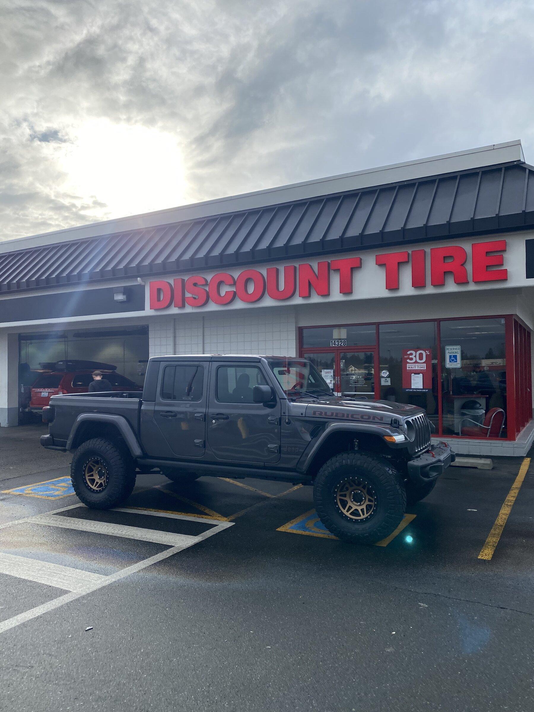

Hey there. So I just had @Discount Tire install my 37s and the truck looks solid but it strangely started to vibrate the wheel when accelerating from 20-25mph. I called and the shop told me to bring it in but said because they are 37s it’s probably the tire size that’s causing vibrating.
I asked them to rebalance them anyway and they agreed to .
Is anyone else having vibration issues with 37s?
Also has the Mopar 2” lift but I didn’t have any vibrating after the lift install.
Tires are Nitto ridge grapplers and wheels are method 312s.
Tia
