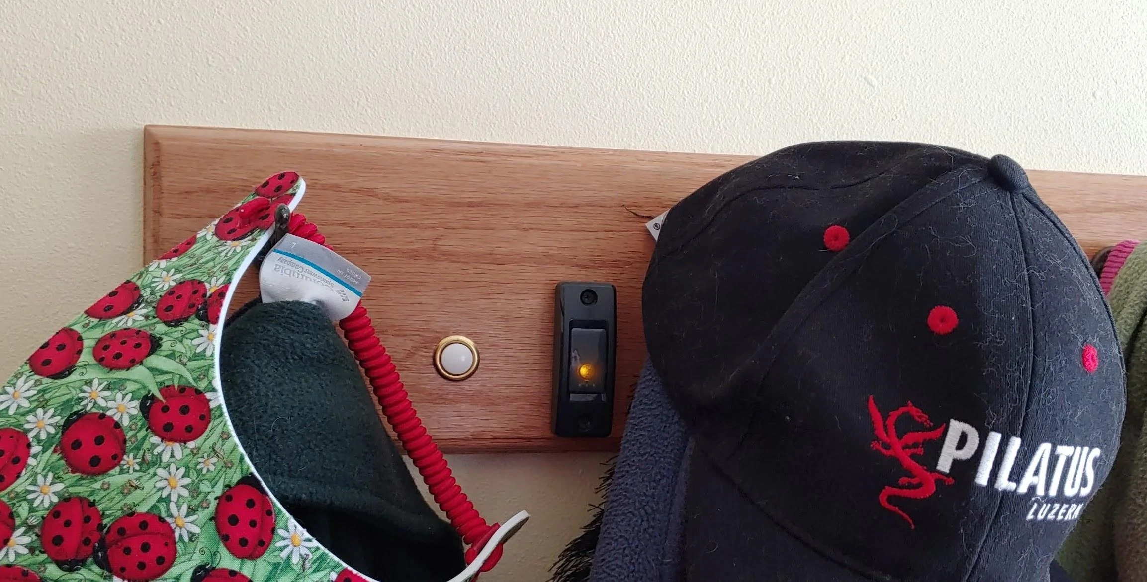

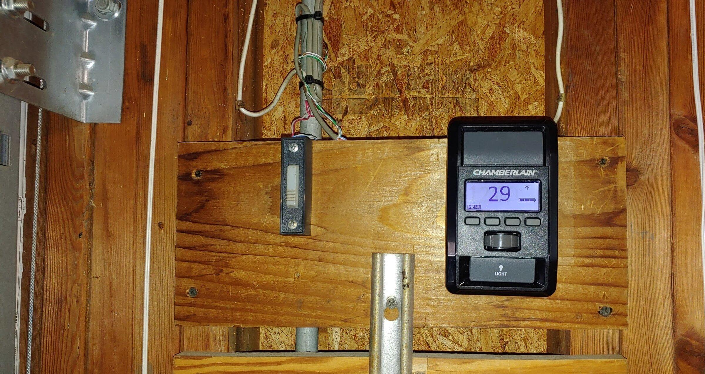

OR (referring to pictures below)
Use button on wall in house to open garage door, start truck, exit garage with truck, use truck to close door.
When coming home - use truck to open door, park truck in garage, shut truck off, go to house and close garage door with button on the wall.
Pictures below show how I can either use my truck to open or close the garage door (I simply close the door BEFORE turning the truck off- it ain't rocket science)
OR
I park truck in garage, I shut truck off, walk out through overhead door, unlock house, enter house, I use button in house to close garage door
OR
I park truck in garage, shut truck off, get out of truck, walk over to the buttons on the garage wall and close the overhead door and exit garage via walk-out door in garage (or go into house and use buttons on wall in house to close garage door)
I don't get the big deal about needing to have a device to give you 30 more seconds. Simply change your habit and close door THEN turn truck off. It ain't complicated and yet folks need a tazer instead of actually changing the order of pushing buttons. Door button first, THEN ignition button LOL
Really, after reading all the posts on this in this thread and the other multiple threads on this exact same thing - is this truck your only means of opening and closing a garage?
Is it really so hard to close the garage door THEN shut the truck off?
Is it really so hard to start the truck THEN open the garage door?
Do you have no other buttons aside from inside the truck to open or close your garage door?
Sorry, I really did have to laugh about needing 30 seconds because someone can't simply close the door THEN shut the truck down.
I can open or close our garage doors either from our vehicles, from switches on the wall inside the garage, from a code panel outside the garage, or from buttons in the house.
Garage door operating instructions:
Shut truck off, exit truck, walk by the buttons on the wall, close garage door.
Jeep Gladiator Visor Garage Door Opener garage-door-buttons
Alternate garage door operating instructions:
Park truck in garage, shut truck off, exit garage, enter house, push button on wall to close garage door.
(I did have two matching small buttons but the new hi-tech opener will not function with a simply NO push button - the remote button has to be programmed to match the opener so someone can't simply access wires and short them to open the garage door so now I have one larger clunky button but it's secure and can't easily be hacked)
Jeep Gladiator Visor Garage Door Opener coat-rack-buttons
Get creative, guys (and Jeep gals) - close door THEN turn off truck. No tazer required.
I still can't believe the grief that simple process is causing. IMO, it's like the fuel door and key fob issues.
