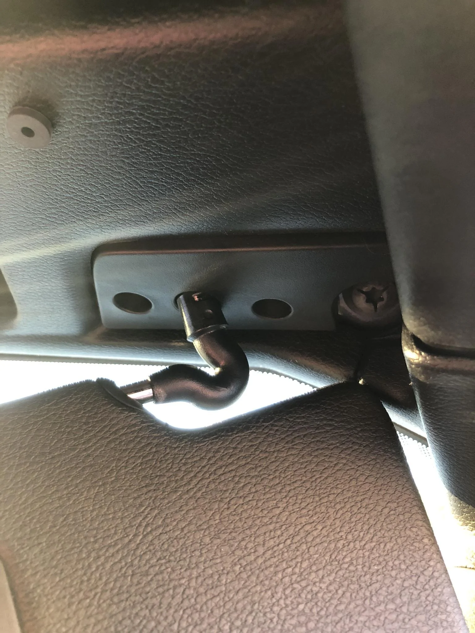

While lowering visor to open soft top, this happened. I keep pushing it back in but it comes out regularly . Anyone else run into this hiccup and possibly a fix?

Mine just did the same thing. Order the Taccom plastic clips. $20 dollars on amazon and worth it in my opinion. Dont get the two screw one. Just get the half moon looking one with one screw so it wont interfere with the visor itself. 5 minute install and problem no more.

The visor is broken, maybe you push it a few more times and it will fall off. But it's quite easy to fix that, go get a clip for it, flip your sun visor forward, remove the factory 'outboard' screw next to the visor post, install this clip, rotate it in to capture the band on the visor post, and tighten. that's what I did. I bought the sun visor clips from auxito, fyi.

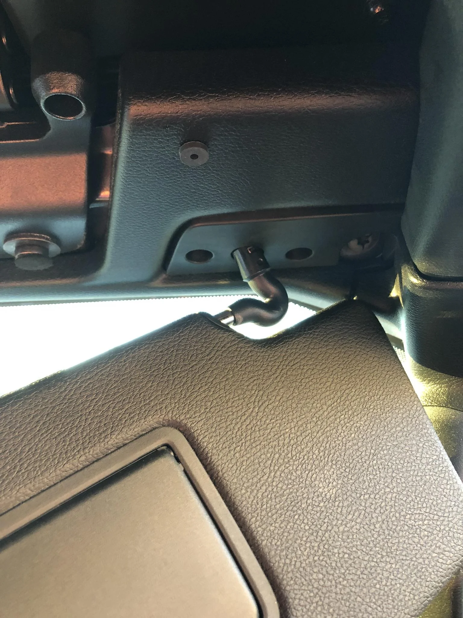

I had that happen. I had the dealer fix it under warranty. No arguing or fuse.

TACCOM makes these cheap plastic hooks and they sell them on amazon. Takes 30 seconds to install and fixes the issue.

get the Tacom thingies and fix it yourself. brinin it in to have dealer fix it will simply replace crappy broken one with crappy new one that will break
