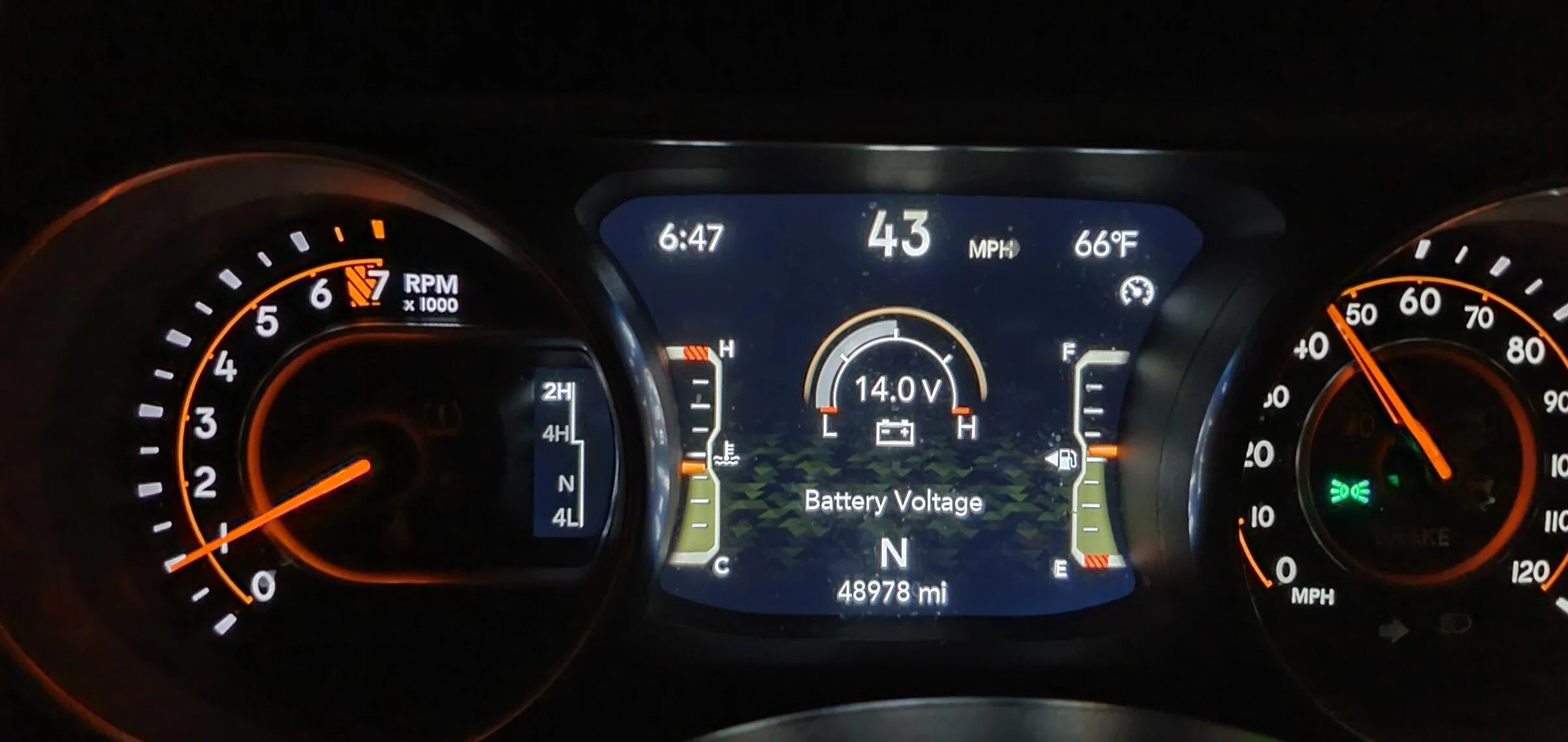

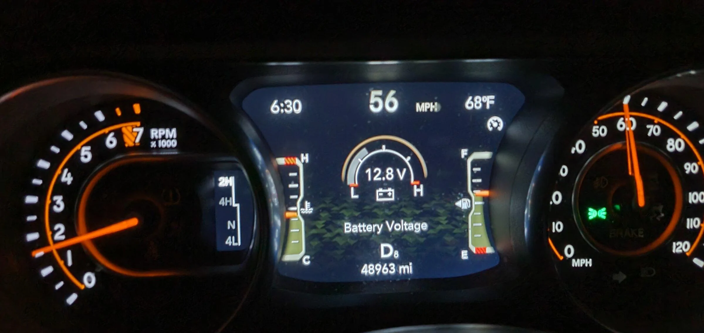

Hey guys I know something's probably wrong with my Gladiator and I'm hoping it's just the batteries.
I just had an ESS event and when it started all the lights dimmed down pretty low like the battery is about to die.. So I checked my voltages while driving home the highest I ever get is 14 V in neutral coasting the other picture is while driving. I'm probably going to replace both batteries do you think that'll fix the issue?

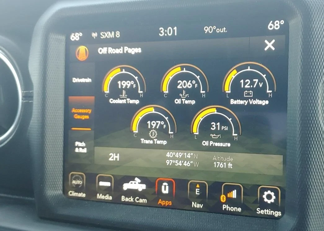

This picture is from my own truck this last summer. AC was on, cruise was on, everything was working just fine.
Jeep Gladiator Voltage too low? 20210613_150145

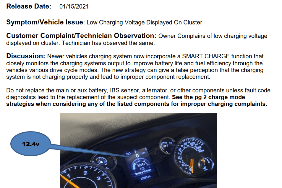

And this is what Jeep says about it -
Jeep Gladiator Voltage too low? 1639615573961

I do understand the low voltage is ok because if the "inverter" alternator but after that pic on the way home I got down to 12.5v constant while driving and it never goes above 14v ever. I used to have the jeep shut off in ESS at almost all lights, not I get lucky if it happens twice a day. I drive about 300 miles a day.
