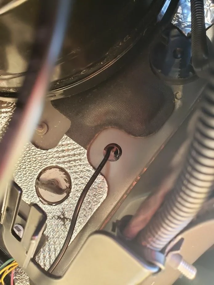

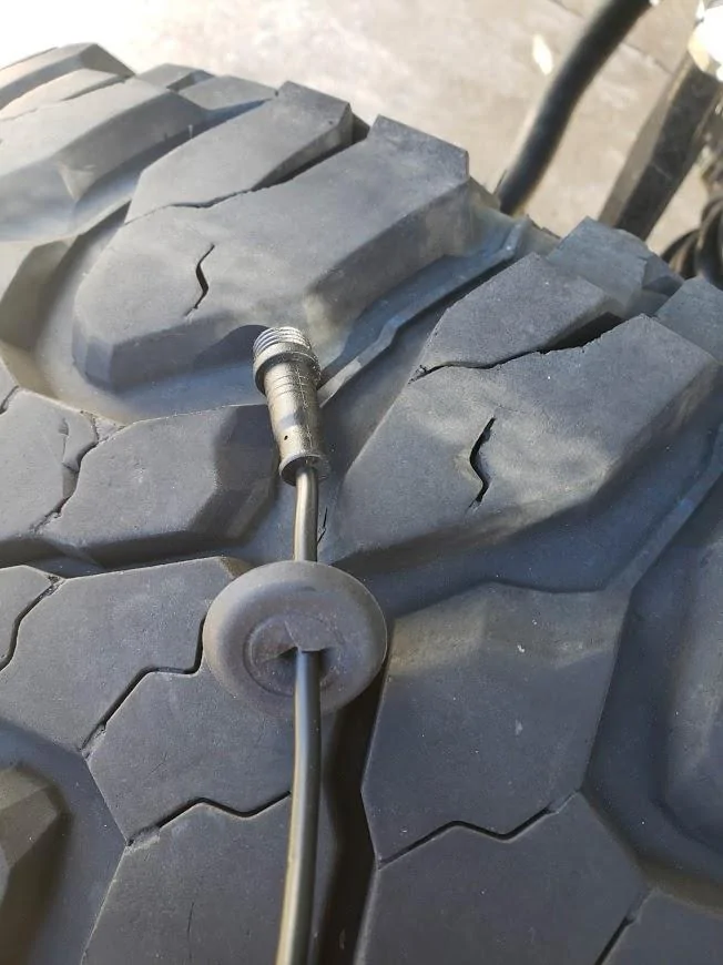

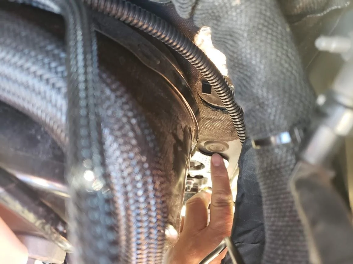

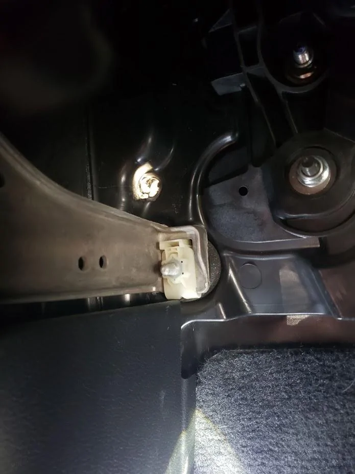

I ran my voswitch wire into the cab threw another grommet. I did have to run a drill bit threw a plastic panel that was behind the grommet but I would rather do that than run the wire under the windshield, just did not like that idea. Pushed the grommet out slit the middle of it and pushed the wire threw it and reinstalled the grommet with some silicone over the wire to finish the seal. last picture is from inside where I had to drill.
Jeep Gladiator VOSWITCH JL300 voswitch6

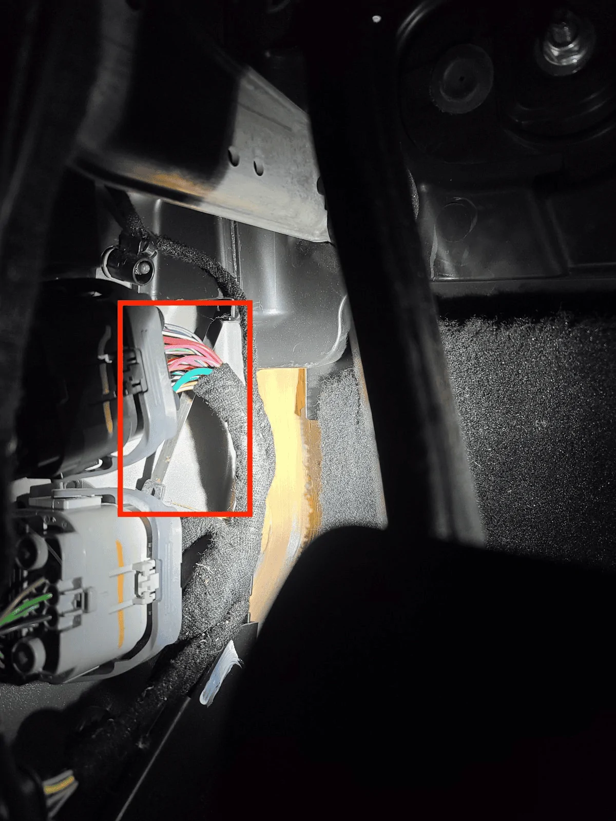

For others: no need to drill through the plastic. If you push a wire or fish cable through it, it will be angled down behind the kick panel:

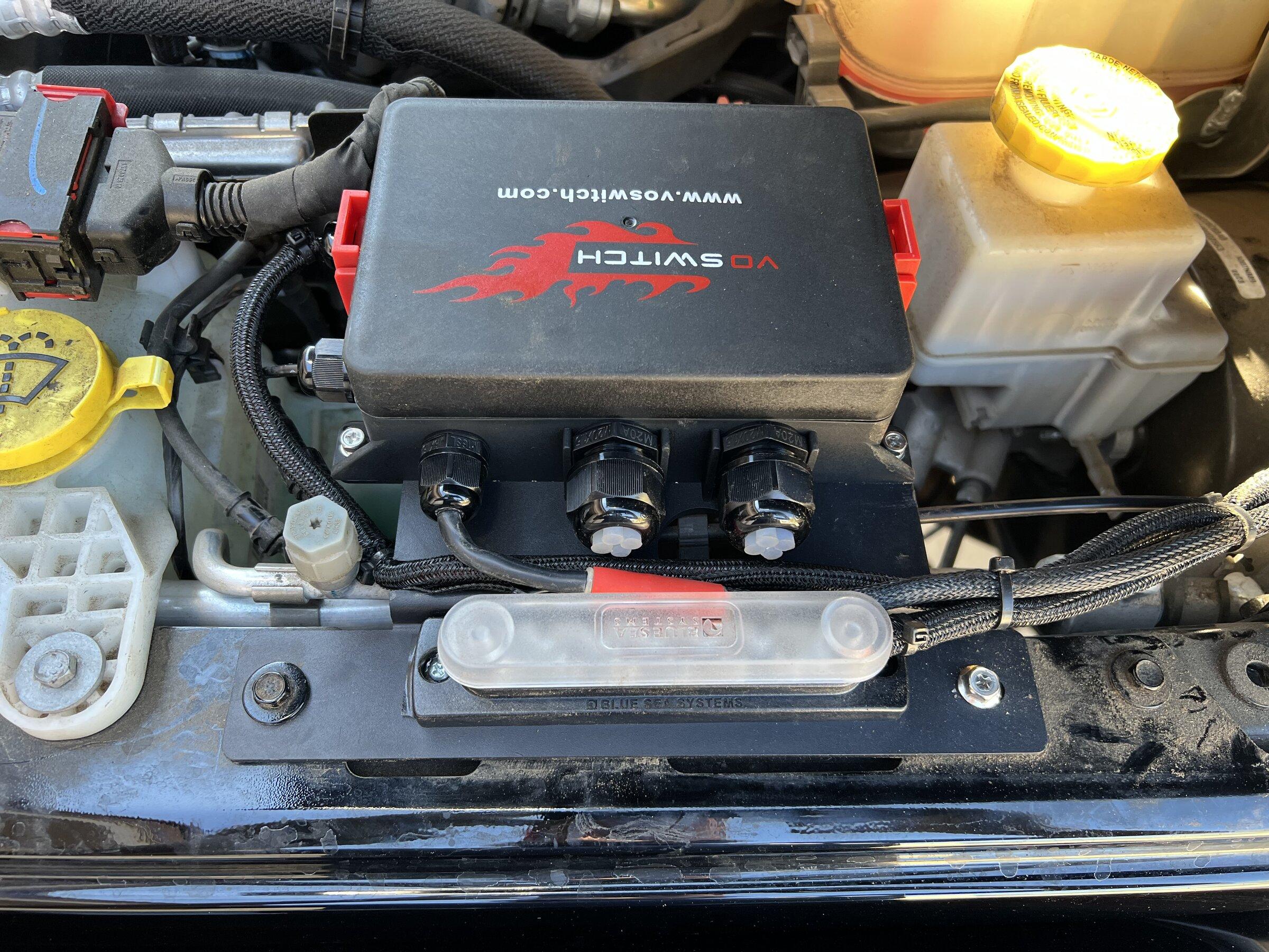

I did this install yesterday. Super simple. I also didn’t like the idea of running through the windshield but I folded it down and there is actually a ton of room. There is a small section where there is basically no weather seal next to the A-pillar and it fit perfect with no pinch.
I also added a ground buss bar. This is pretty much the only thing the kit doesn’t have.
I went back and forth on the Mopar switches or this. Glad I went thisroute and saved 200ish bucks.

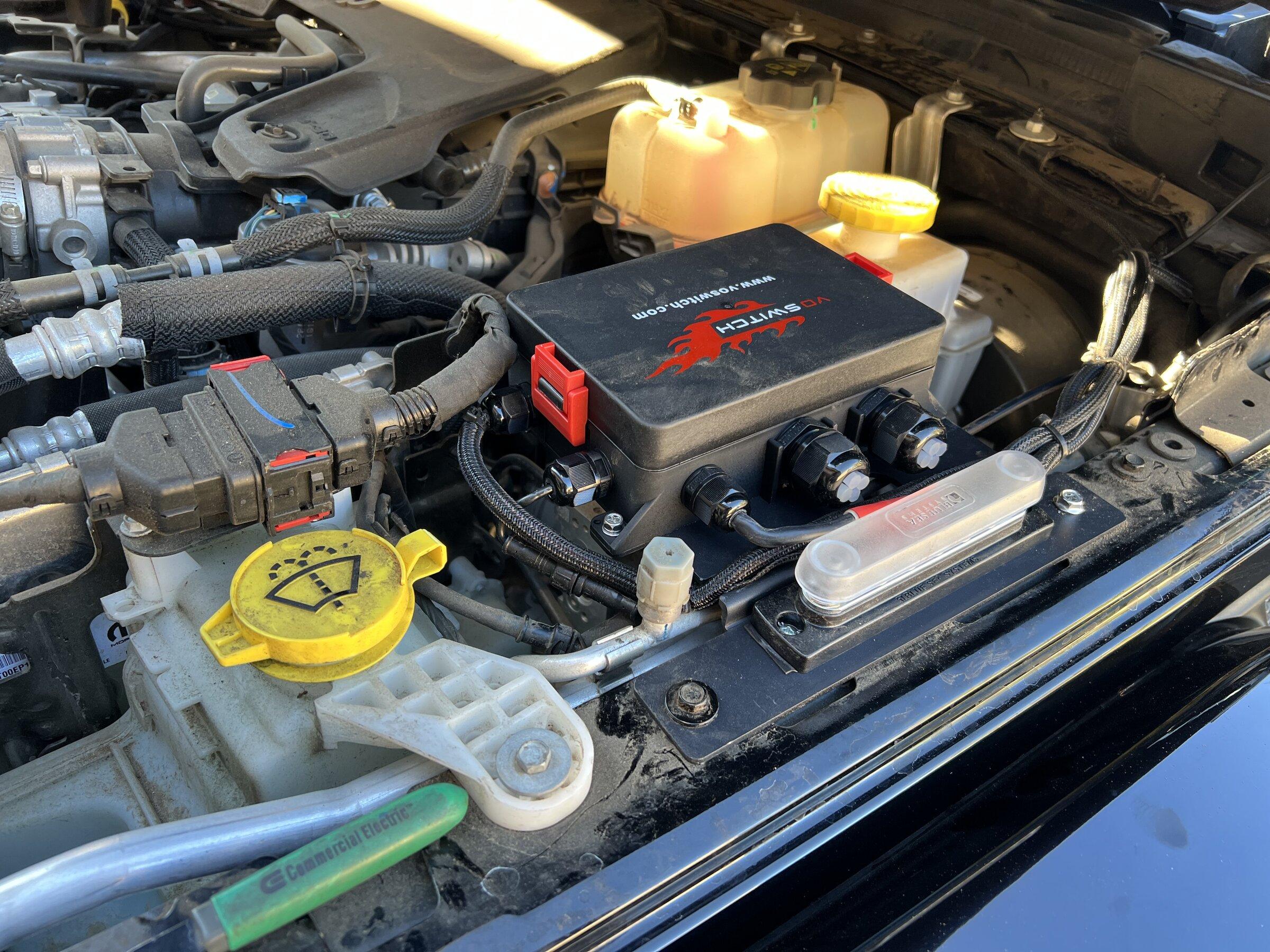

Jeep Gladiator VOSWITCH JL300 BAA4E9A5-D869-41FF-89C5-39CC63DDFF6C
With install mine was going to be around $700 with the Mopar switches. I’m sure what route I’m going now. I just don’t have the money any other way.
