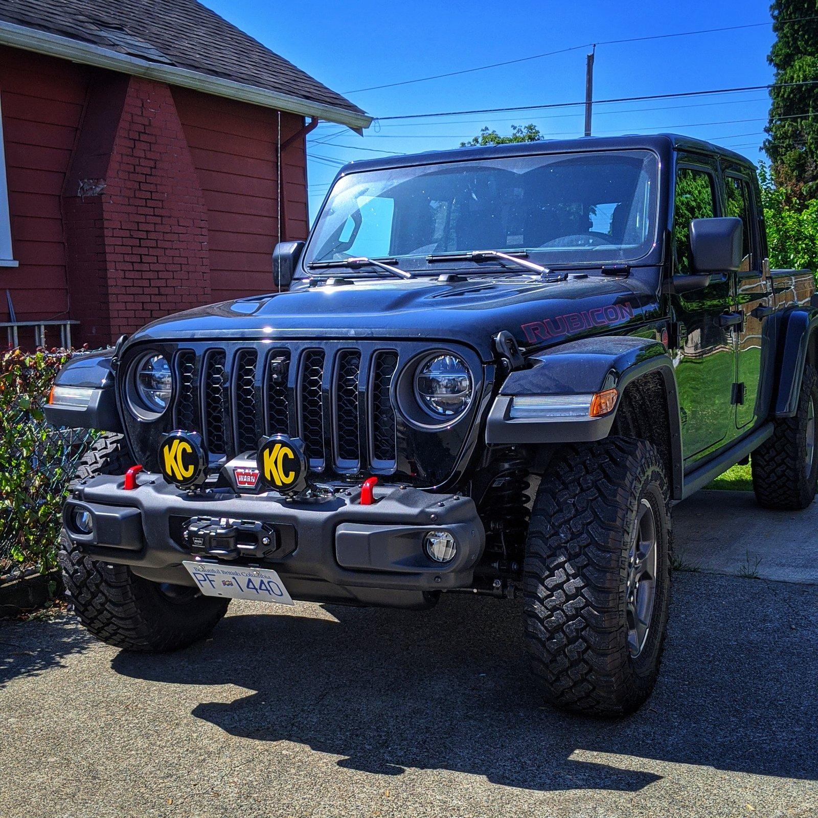

Thanks all. Yea it fits it's tight as hell but It got on there. Like sassJT said the dimension on the warn website was the same so I purchased it.

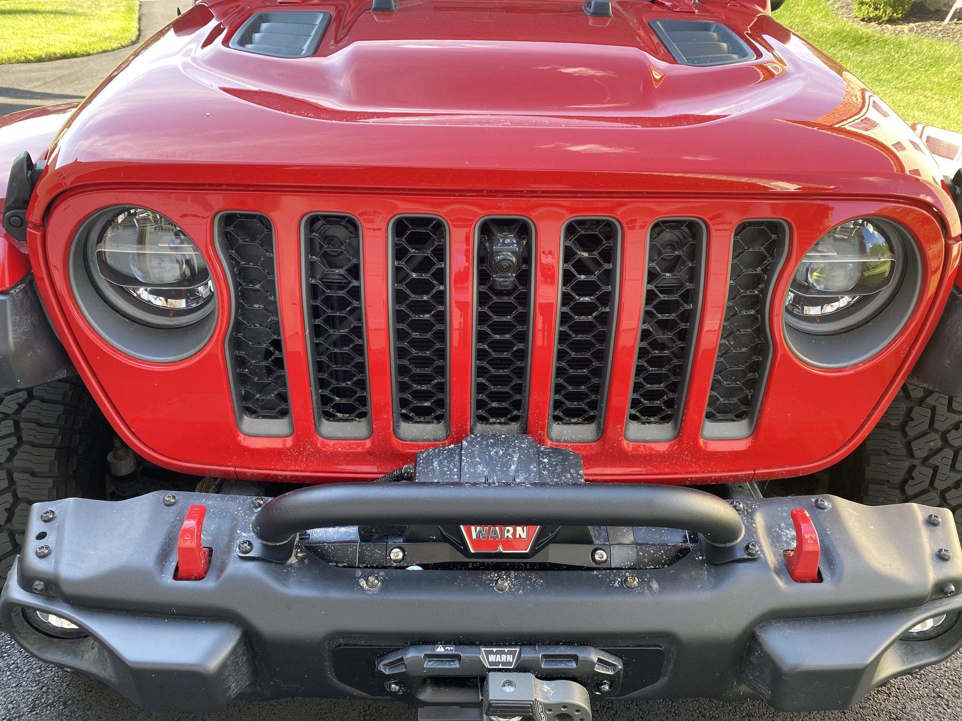

Finished torquing mine down this morning.
Jeep Gladiator Warn Winch 12S IMG_20200629_111543-01

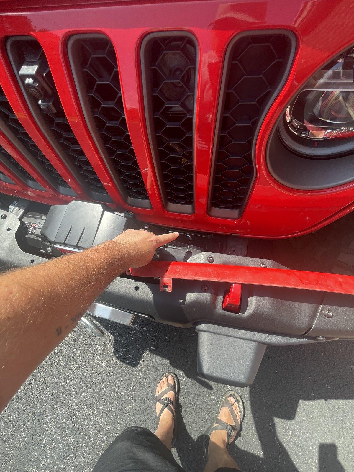

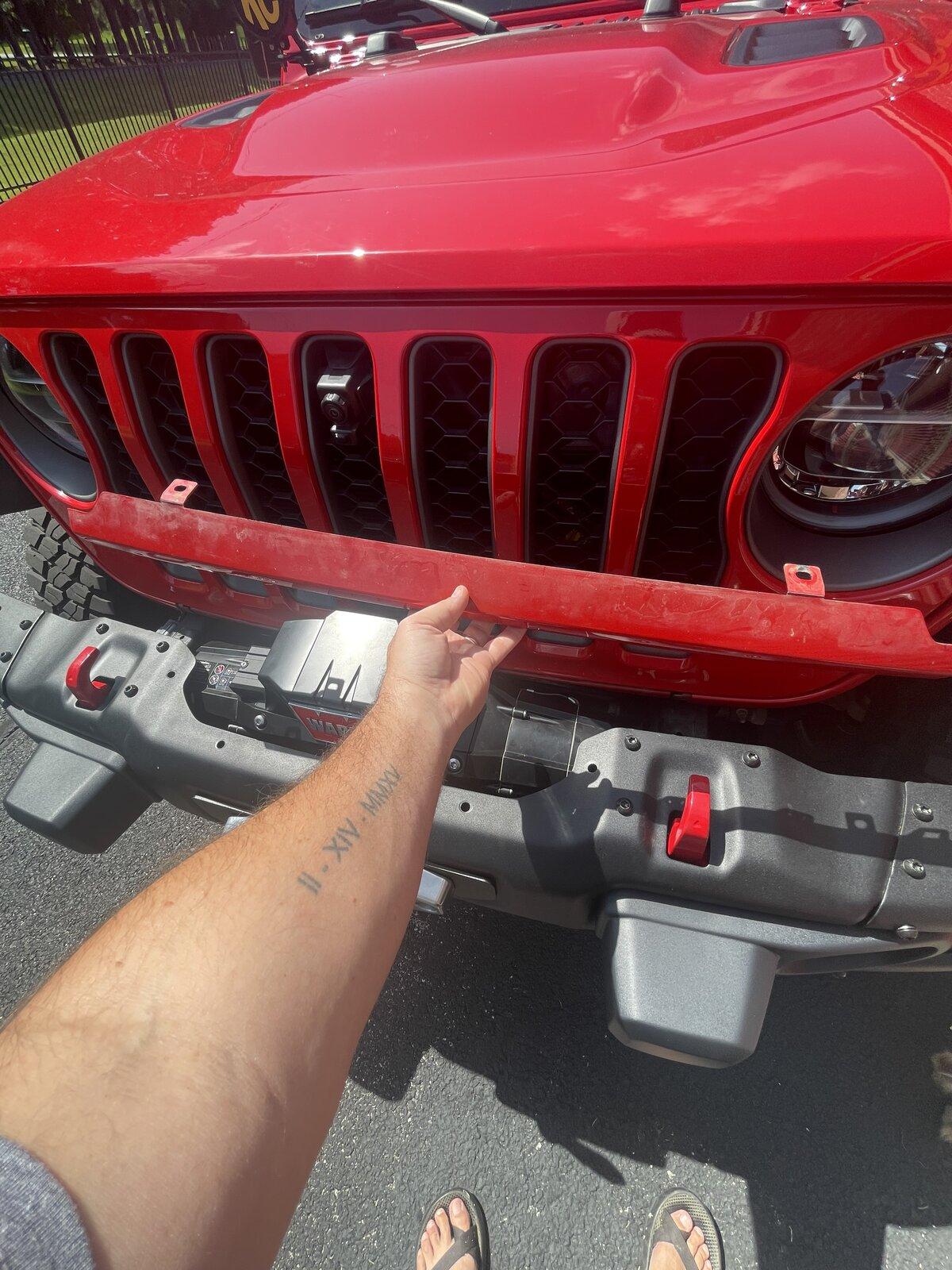

I had my local dealer install my 12s and they can't get the winch to fit with this bottom piece of the grill. Anyone have any insight as to how you fit yours?
Jeep Gladiator Warn Winch 12S IMG_4293
Also, the steel skid plate won't fit anymore. What are you all running for a skid plate?

Did you swap from a the plastic bumper to the steel one when you put the winch on? If so, the steel skid plate will not match up. You’ll need to get a different MOPAR steel skid plate to bolt up to the steel bumper. (That’s just ridiculous… why not have one skid plate that works for both bumpers?)
I was able to put all of the grill pieces back on, but I had to leave out the two outer filler plate bolts and nuts. They were interfering with the winch/bumper fitment.
also, check to see if you can move your freespool lever all the way. Mine wouldn’t rotate fully 180*. Apparently warn has a replacement freespool lever that makes it only need to rotate 90*. It’s either that or raise the winch about 3/8” to so the lever clears the bumper, or notch out the bumper.
Yea, I went from plastic to the mopar steel bumper. You’d think the skid would be usable but JEEP…..I’ll try that with the lever. Thanks!
