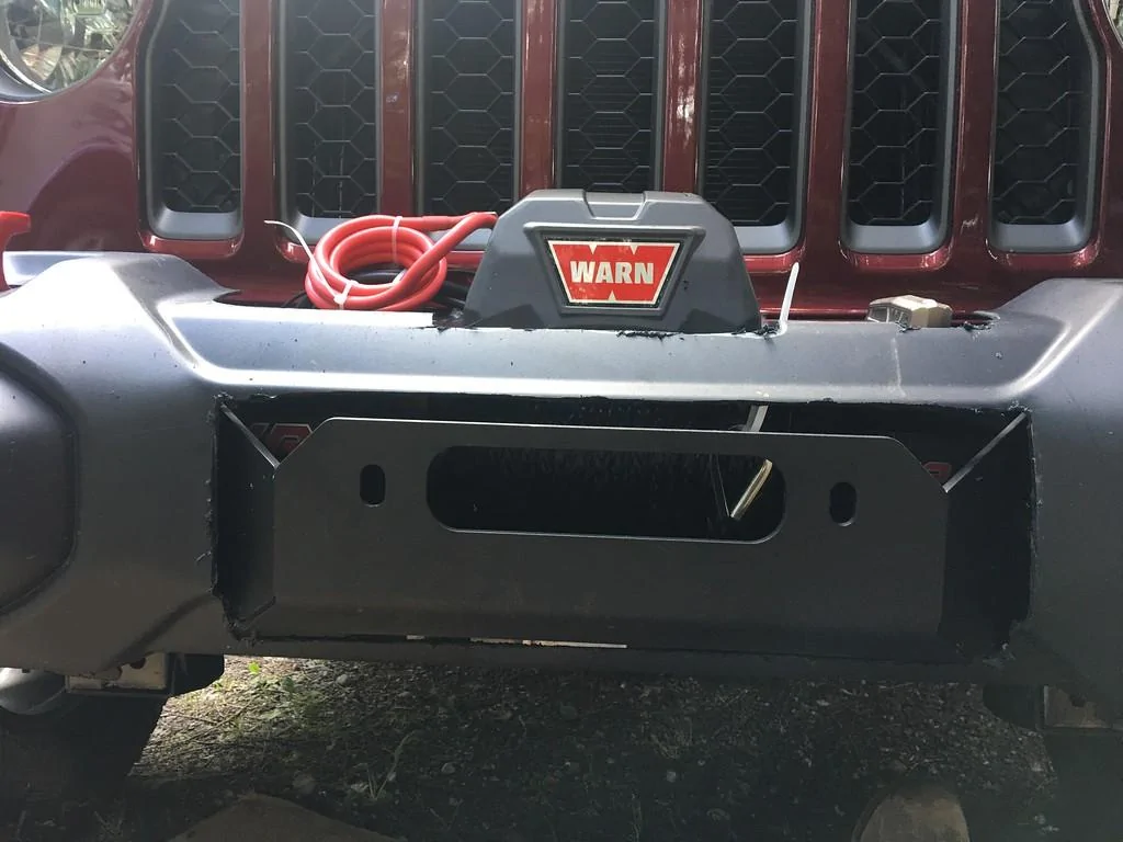

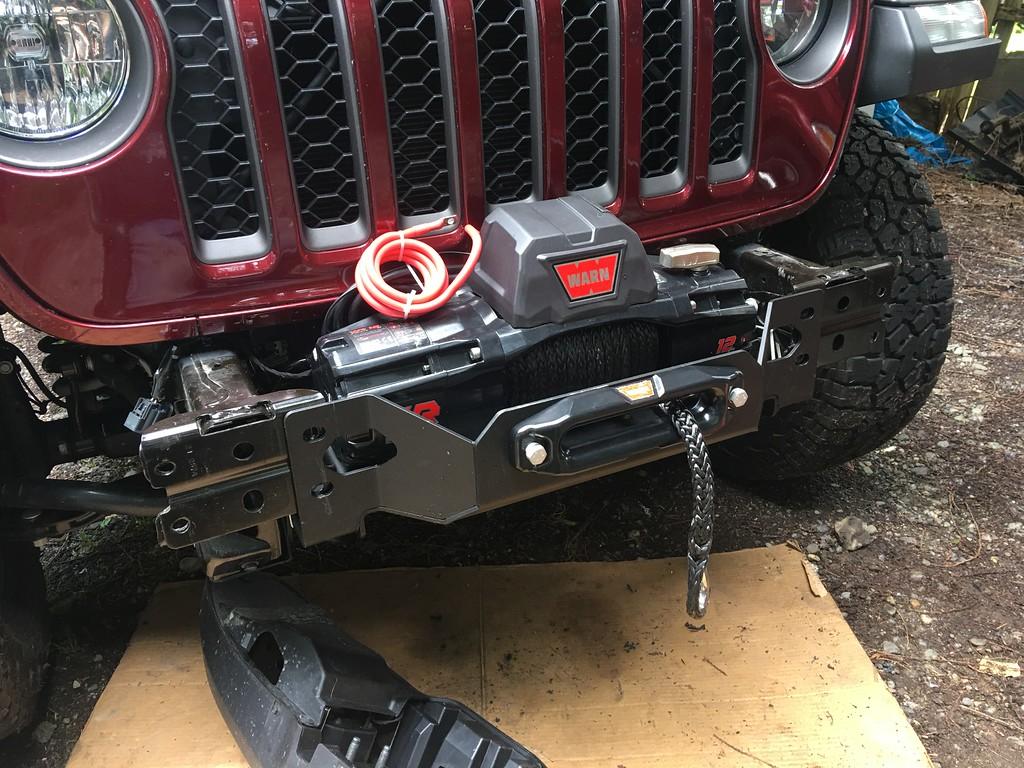

However, the fairline part of the winch mount sticks out at least two inches beyond the front of the plastic bumper. I had to cut a massive hole in the plastic bumper for this to work. Here's a couple of photos showing what I am talking about.
This is the winch plate and winch mounted.
Jeep Gladiator Warn winch plate #101255 with a FACTORY steel Rubicon front bumper? YES, it can be done THANKS for the information IMG_5267-XL
This is a close up of the hole that had to be cut in the plastic bumper to clear the front of the winch mount.
Jeep Gladiator Warn winch plate #101255 with a FACTORY steel Rubicon front bumper? YES, it can be done THANKS for the information IMG_5266-XL
Finished install. Look how far the fairlead is in front of the bumper, would the factory steel bumper have to be massively cut like this to work with this winch plate that according to Warn, is designed to fit on the factory steel Rubicon bumper?

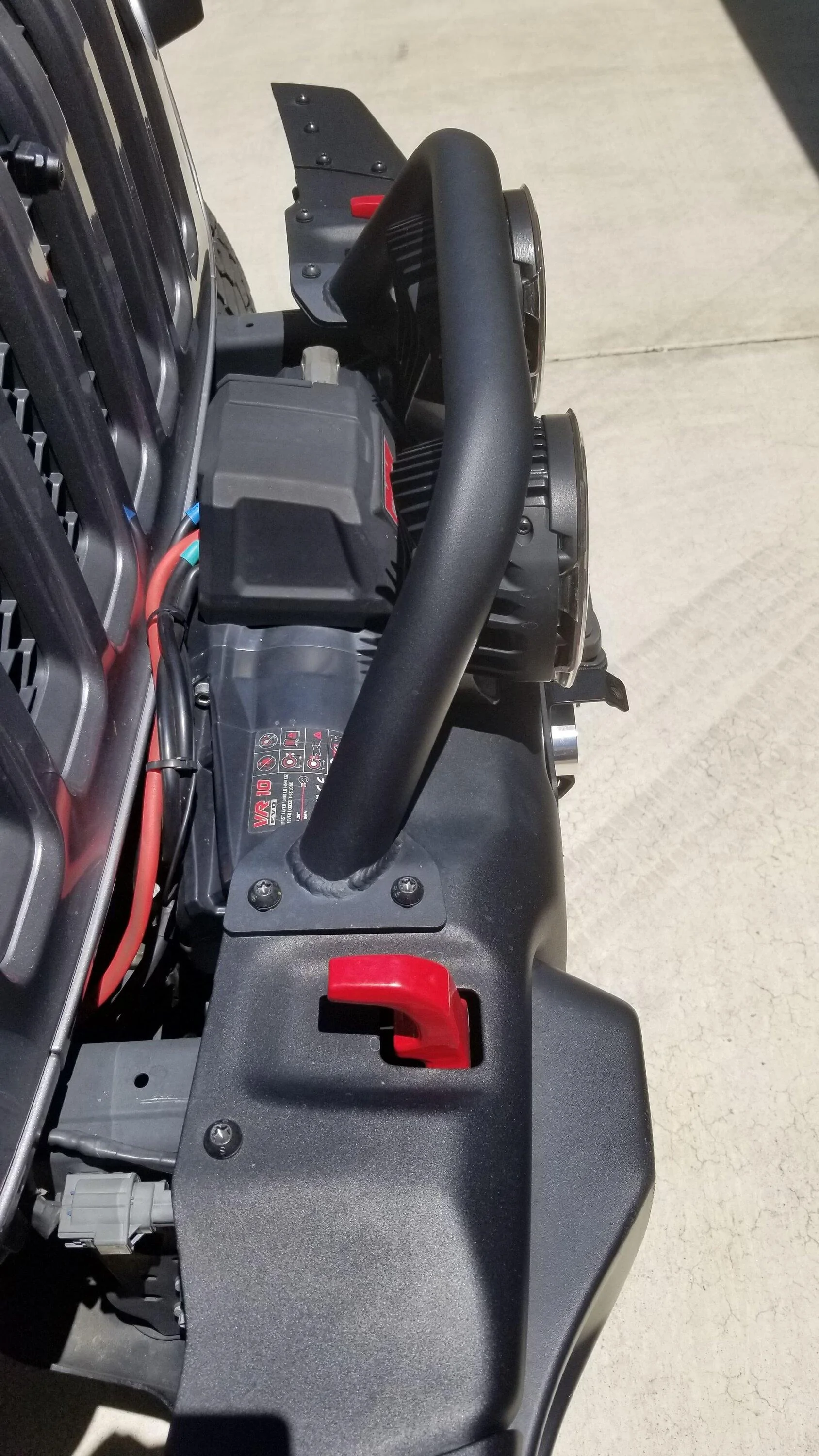

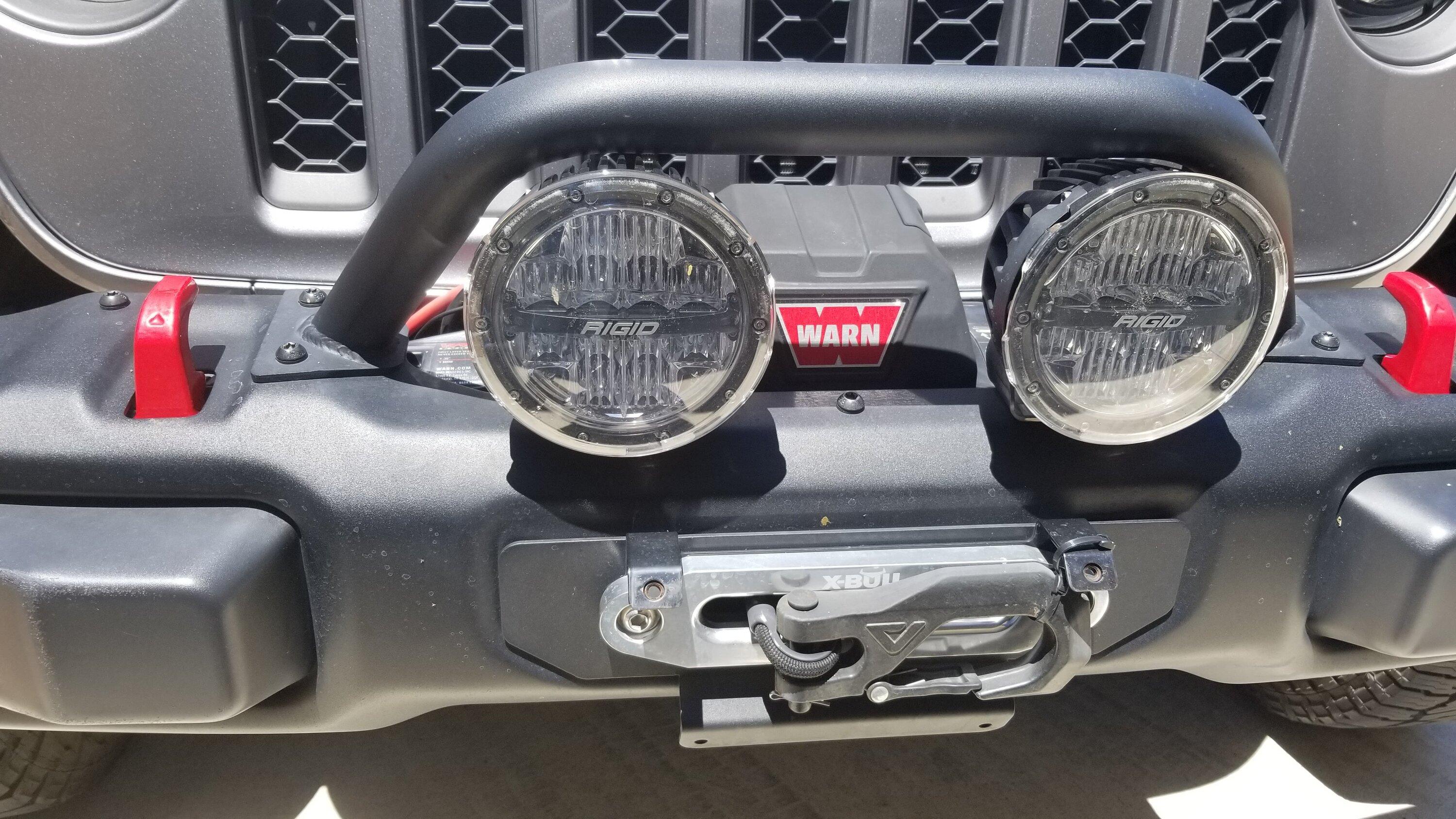

I have the same set up, except 10k winch (same size as 12k, but different gearbox). It will be fine.
Jeep Gladiator Warn winch plate #101255 with a FACTORY steel Rubicon front bumper? YES, it can be done THANKS for the information 20220613_133126
Jeep Gladiator Warn winch plate #101255 with a FACTORY steel Rubicon front bumper? YES, it can be done THANKS for the information 20220613_133135

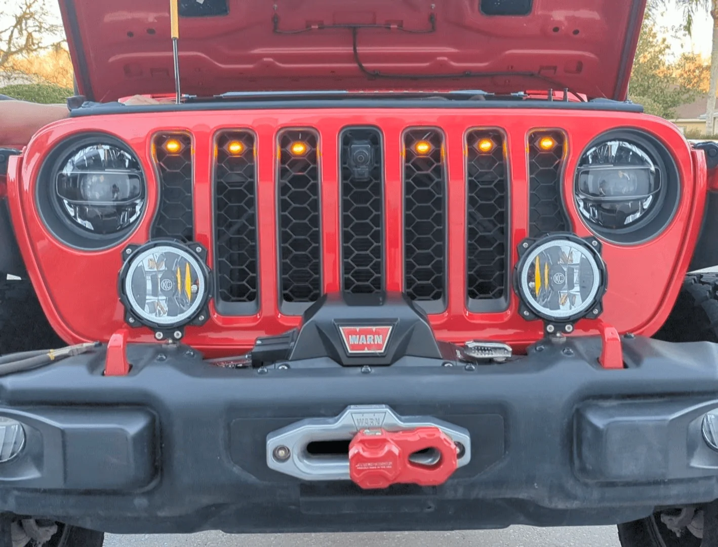

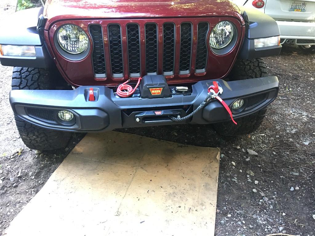

The picture I have is the warn winch plate with the rubi steel bumper

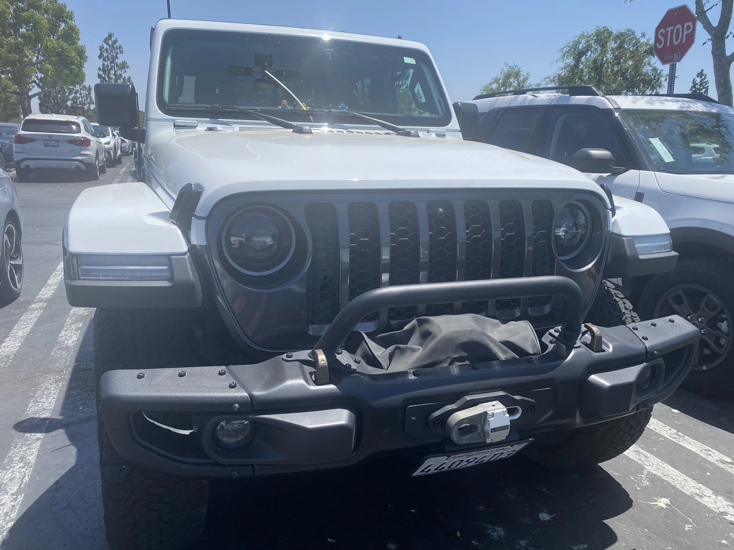

Mine is on 80th anniversary with the factory Rubicon bumper. All bolts lined up and fit was good.

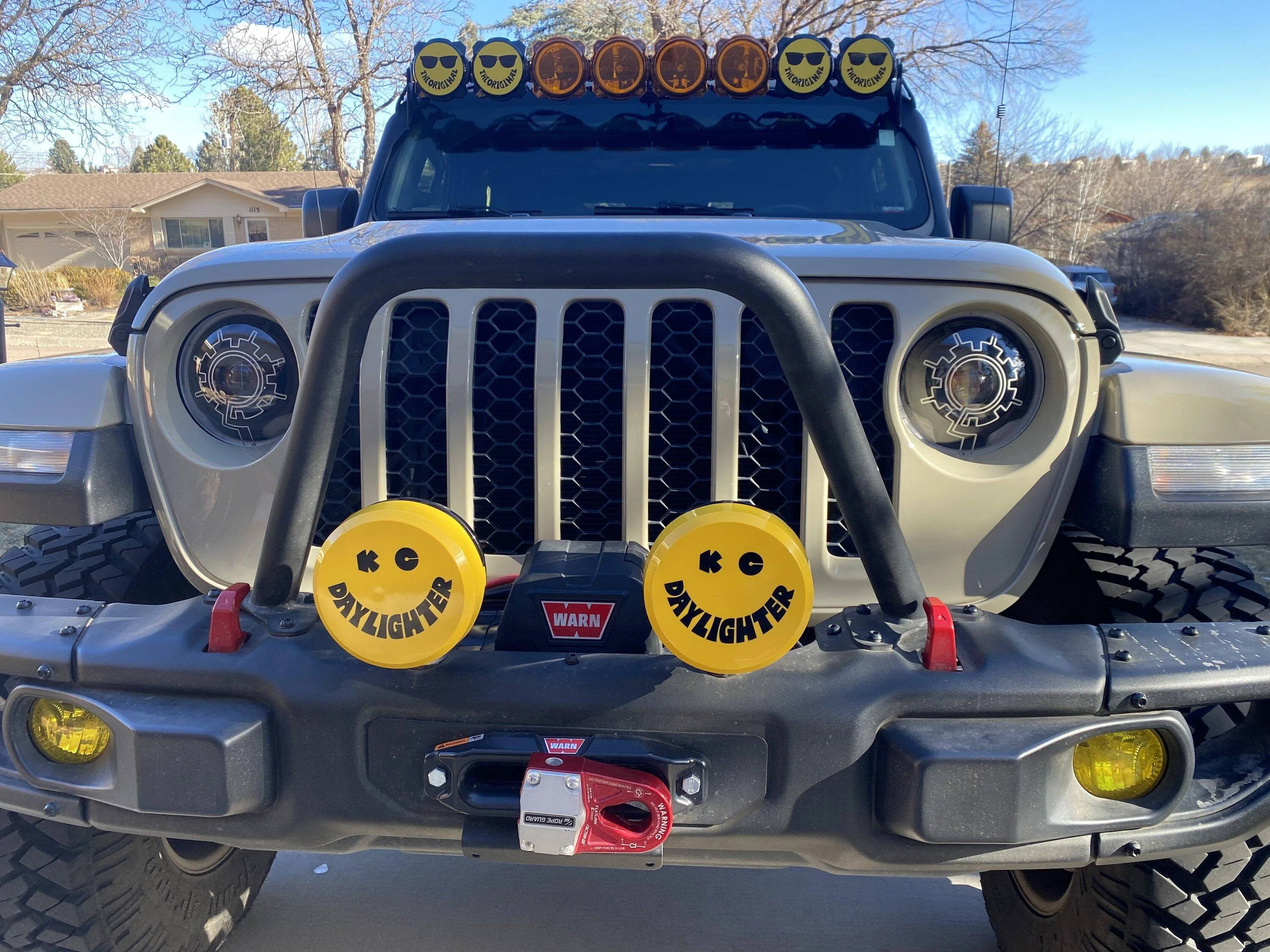

Mopar Steel and Warn winch plate 12k winch on a sport s
I just bolted the fairlead to the bumper. It's steel and not being abused.
Jeep Gladiator Warn winch plate #101255 with a FACTORY steel Rubicon front bumper? YES, it can be done THANKS for the information IMG_9753
