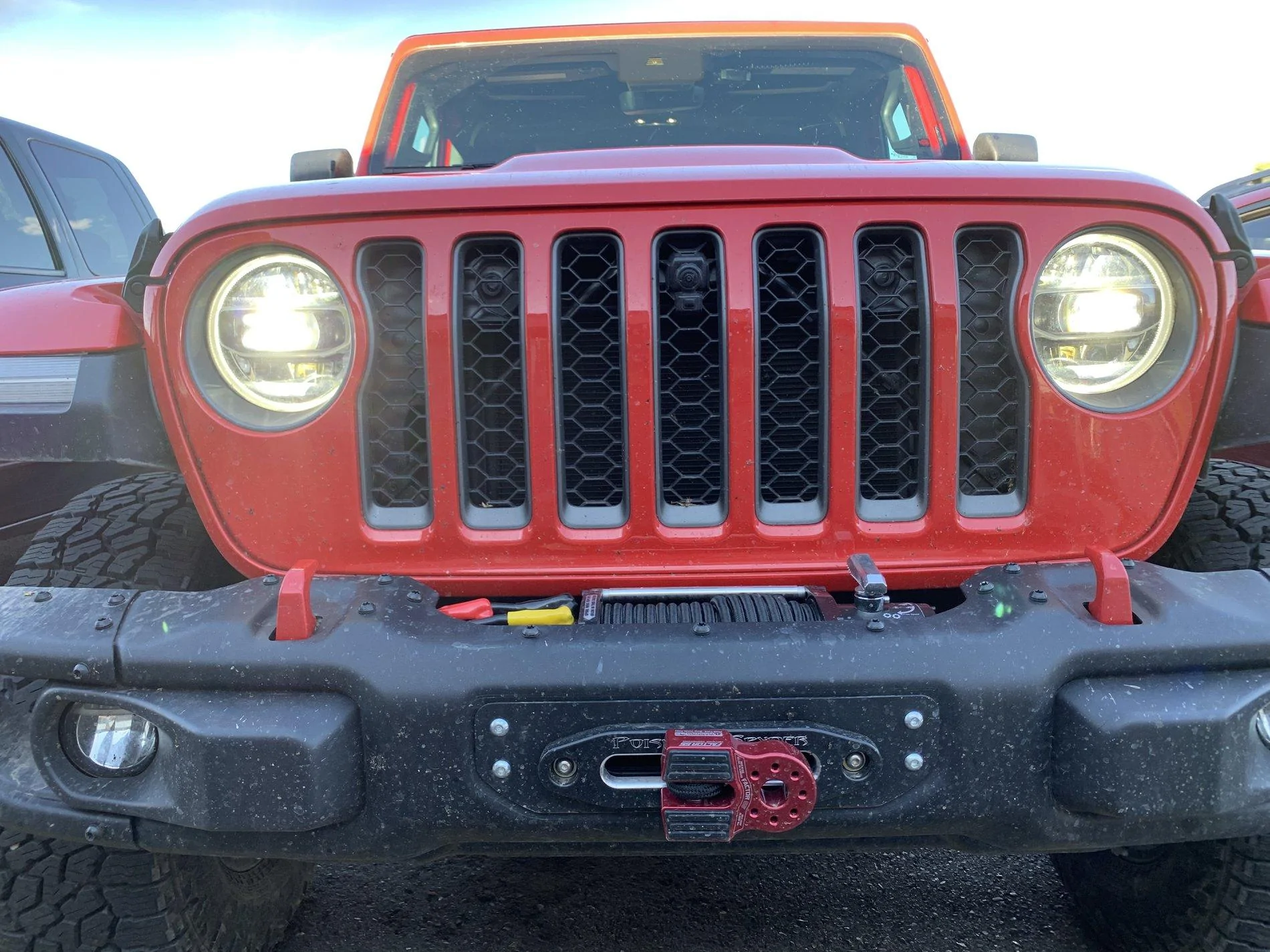

I just installed my winch yesterday. It’s my second JCR winch plate. First time I installed a 10S on our JLR, this time around, I went with the Harbor Freight 12,000 lbs Badland. I upgraded its steel rope with a synthetic rope and mounted the control box under the hood. Even with the Factor55 closed system hook, I’m $300 richer than if I’d gone with the 10S. Like you, it’s an insurance policy, don’t plan on using it daily. Sits flush in the bumper too.

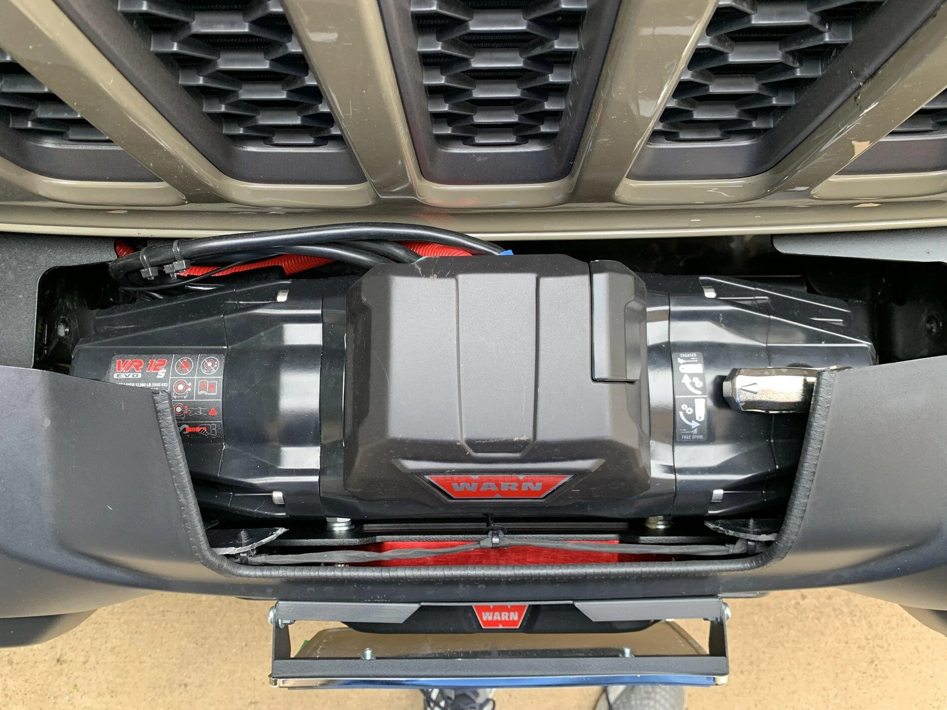

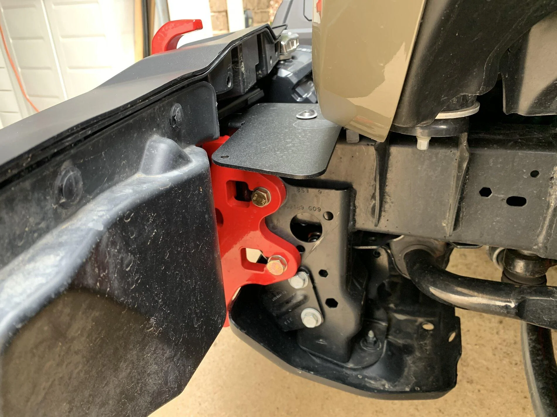

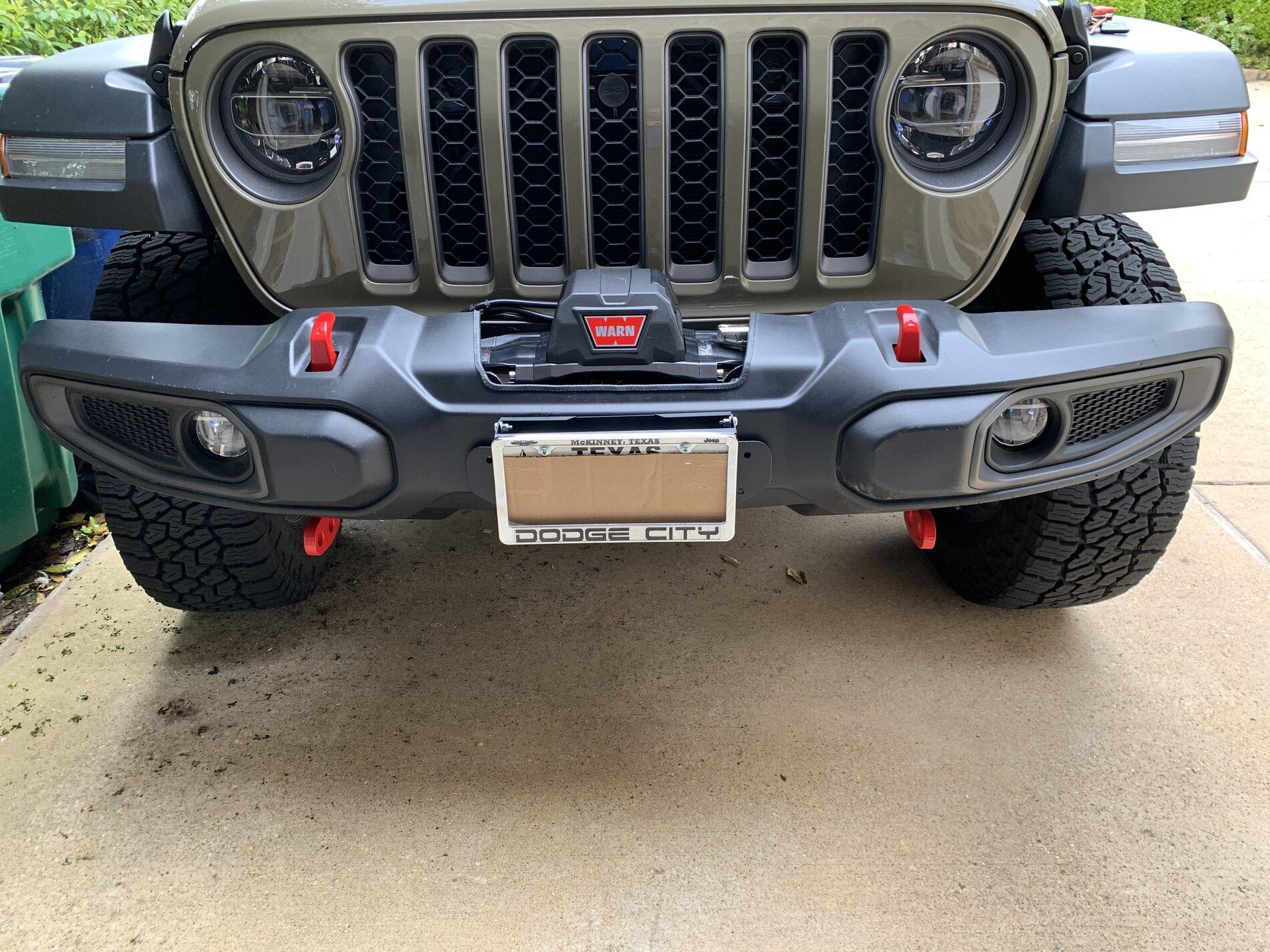

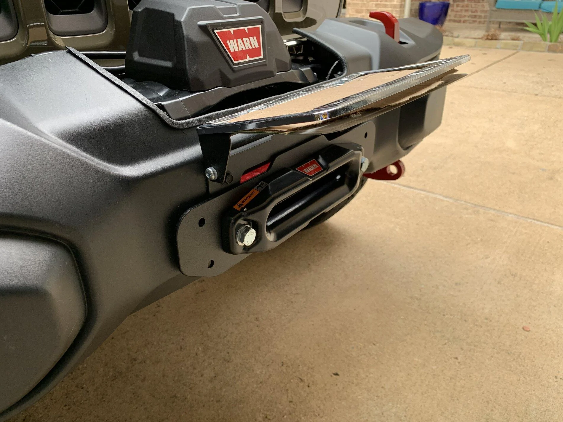

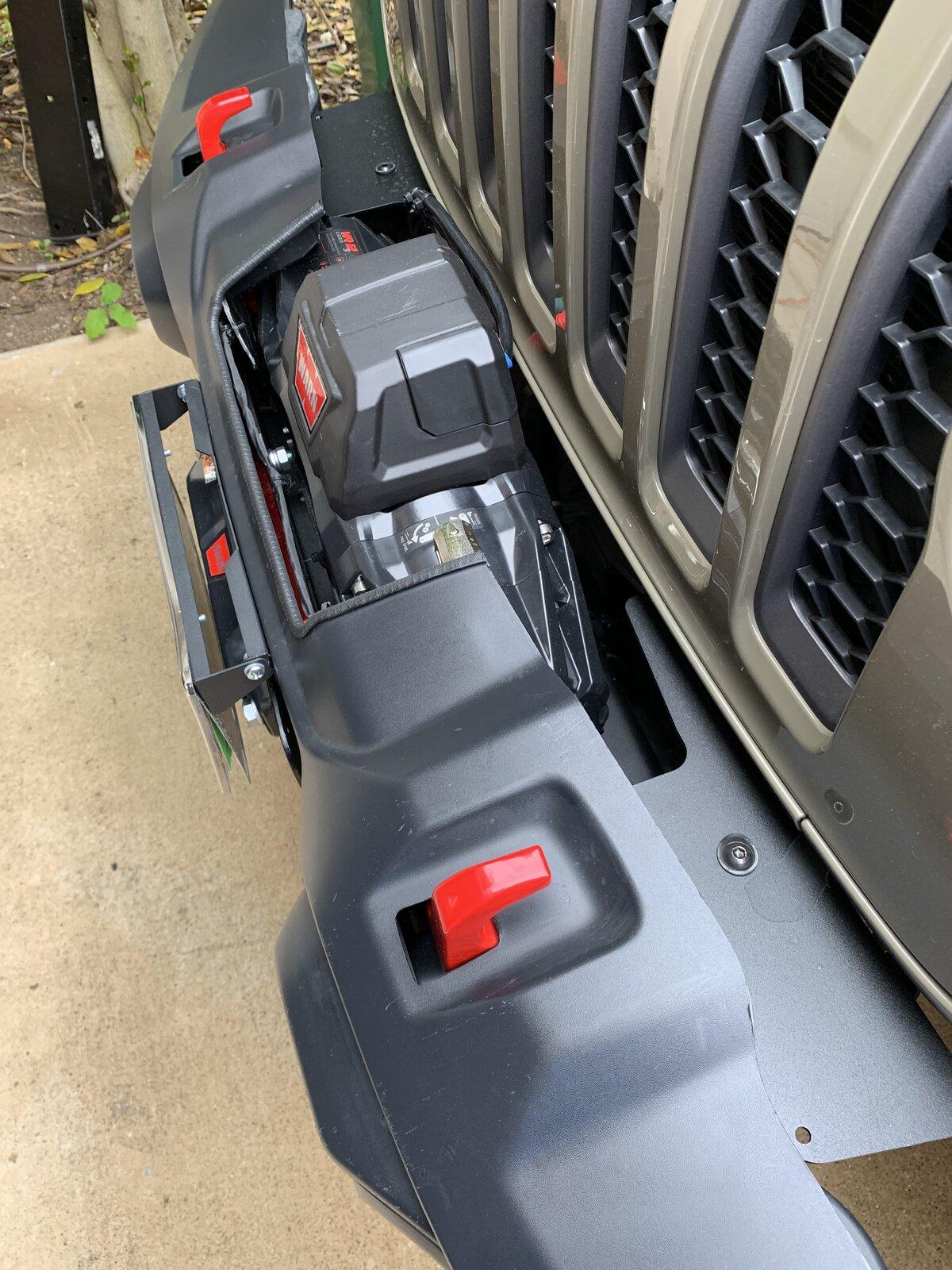

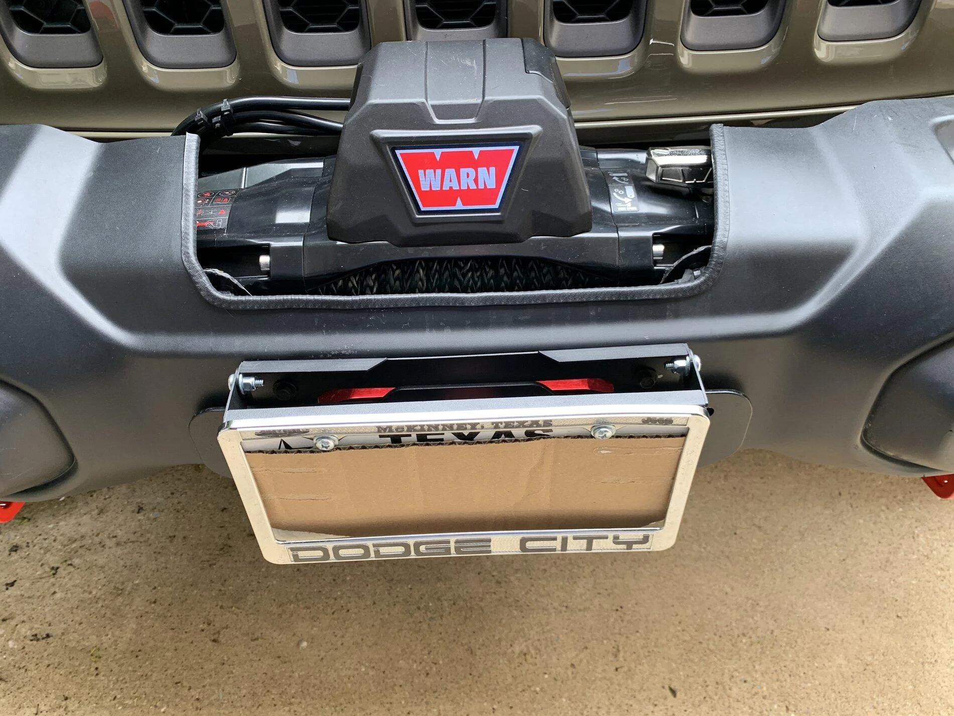

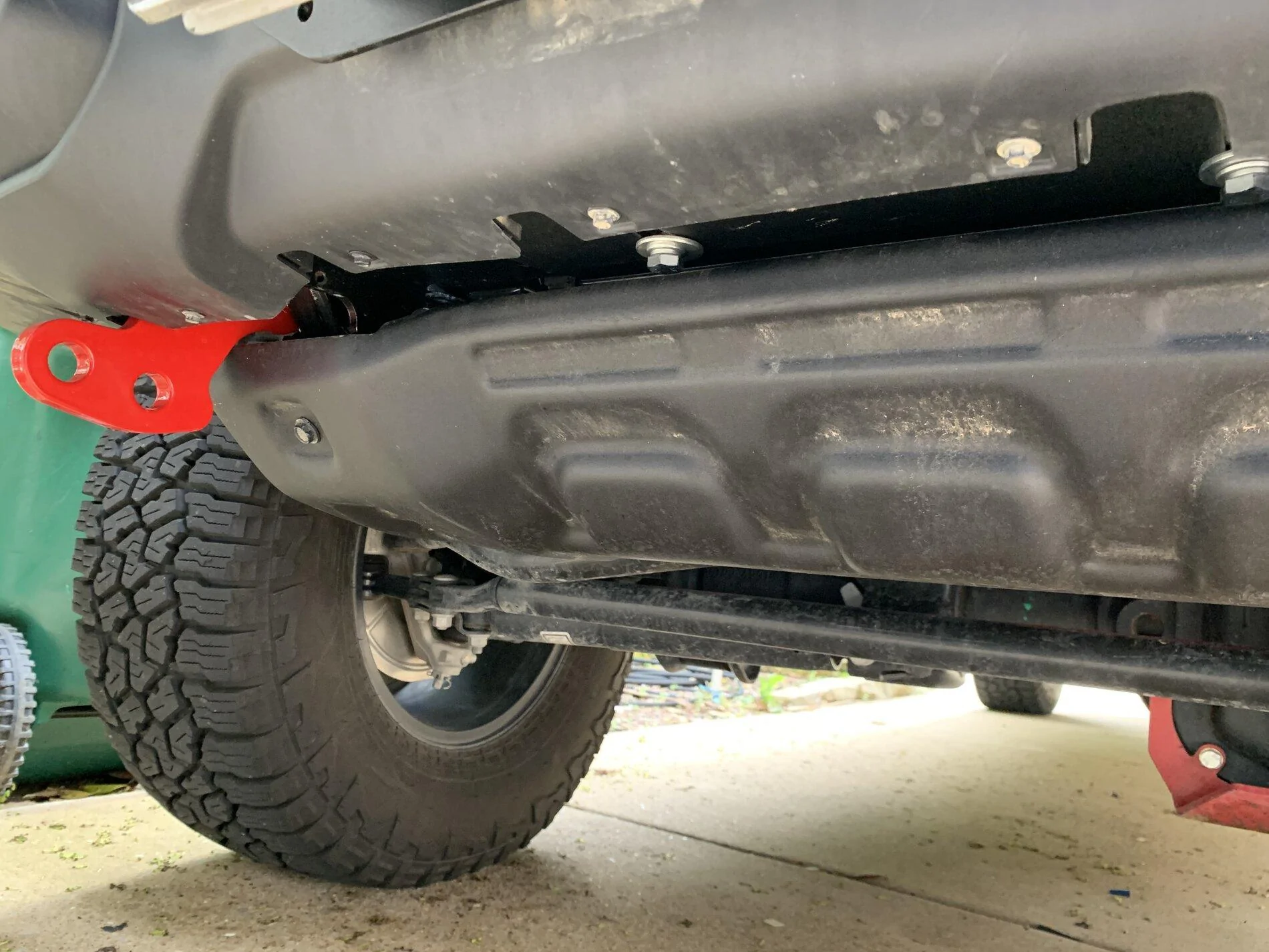

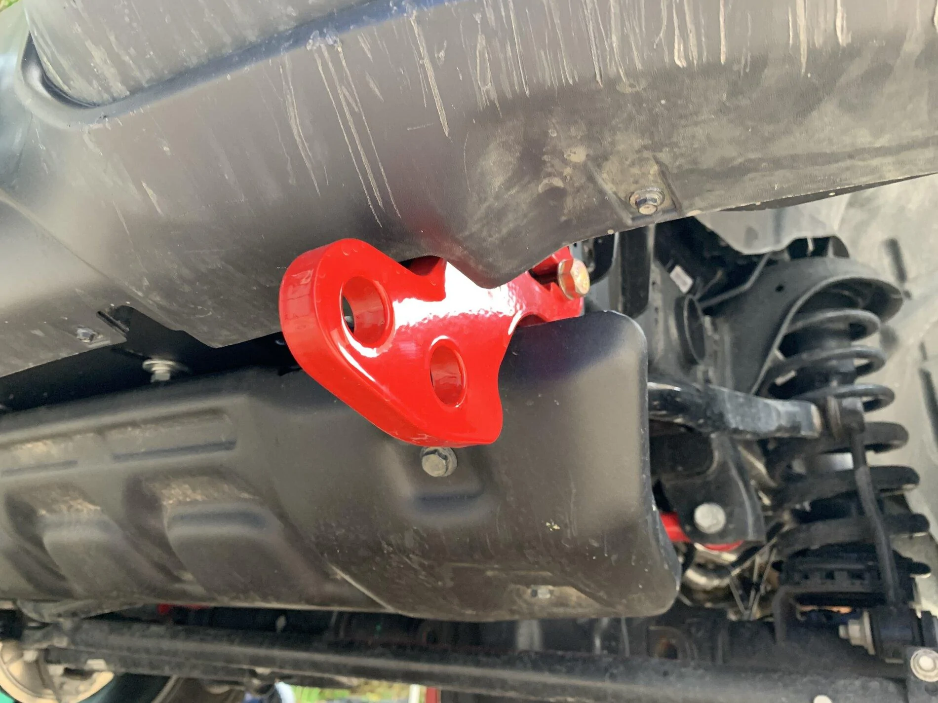

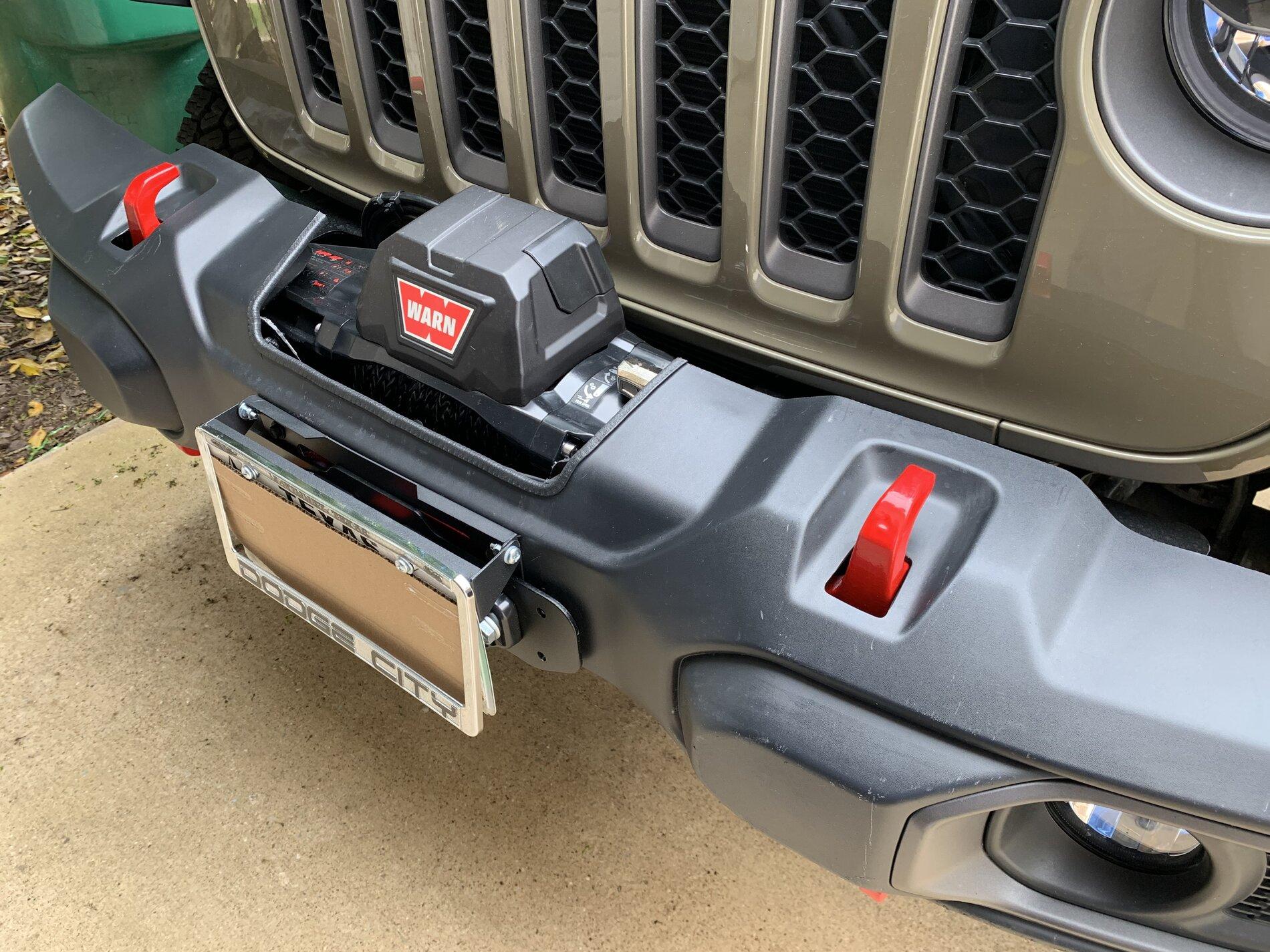

I have the factory plastic Rubicon bumper and factory steel skid plate. I wanted to keep weight down and use what I already had. I installed the Warn EVO 12S, Maximus-3 winch plate, Go Rhino 332000T Rockline Textured Black Fairlead Mount Plate (to take up some space between the winch and the plastic bumper), Tuffy license plate holder, Maximus-3 Tow/D-ring brackets. I bought the winch/mount plate kit from RubiTrux. Great price, no sales tax, and free shipping. I had to cut up the plastic and steel factory bumper, but the mounting plate fit perfect. I got the idea from a gentleman, Toby W, on the JLForums website who made his own winch plate and kept his plastic bumper. https://www.jlwranglerforums.com/forum/threads/winch-mount-for-plastic-bumper.7605/
