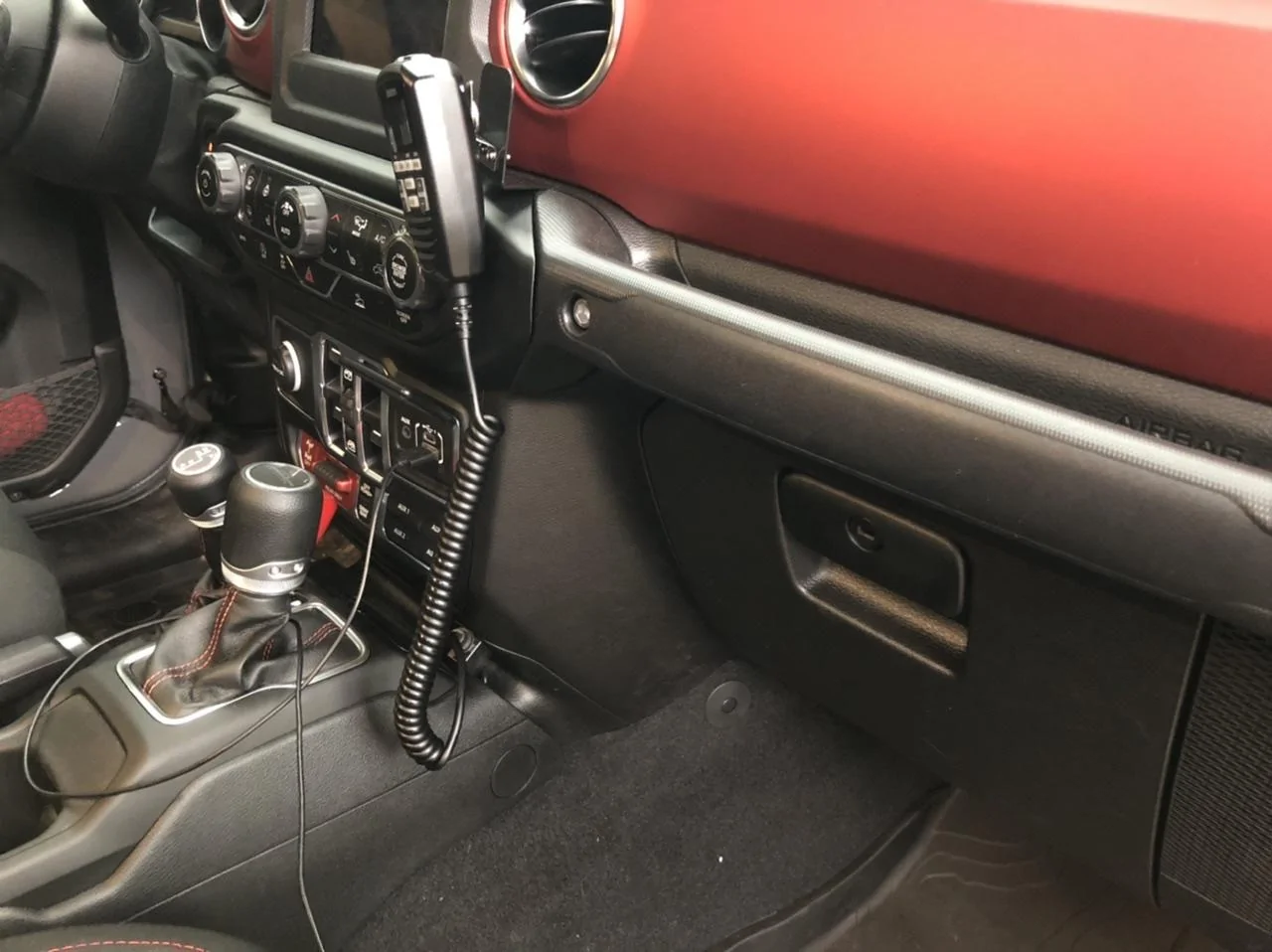

I pulled mine to install my brake controller, and I keep feeling like it doesn’t seat on the right side properly. I wonder if I did the same thing and should replace mine. Does all of the stuff like the start button and HVAC controls just transfer over?
You can’t really break it again so you can pop it off to check. It’s a shame because the Fiat fit and finish is so impressive throughout.
The diagram looks like the plastic trim separates from the controls, which explains the low price.

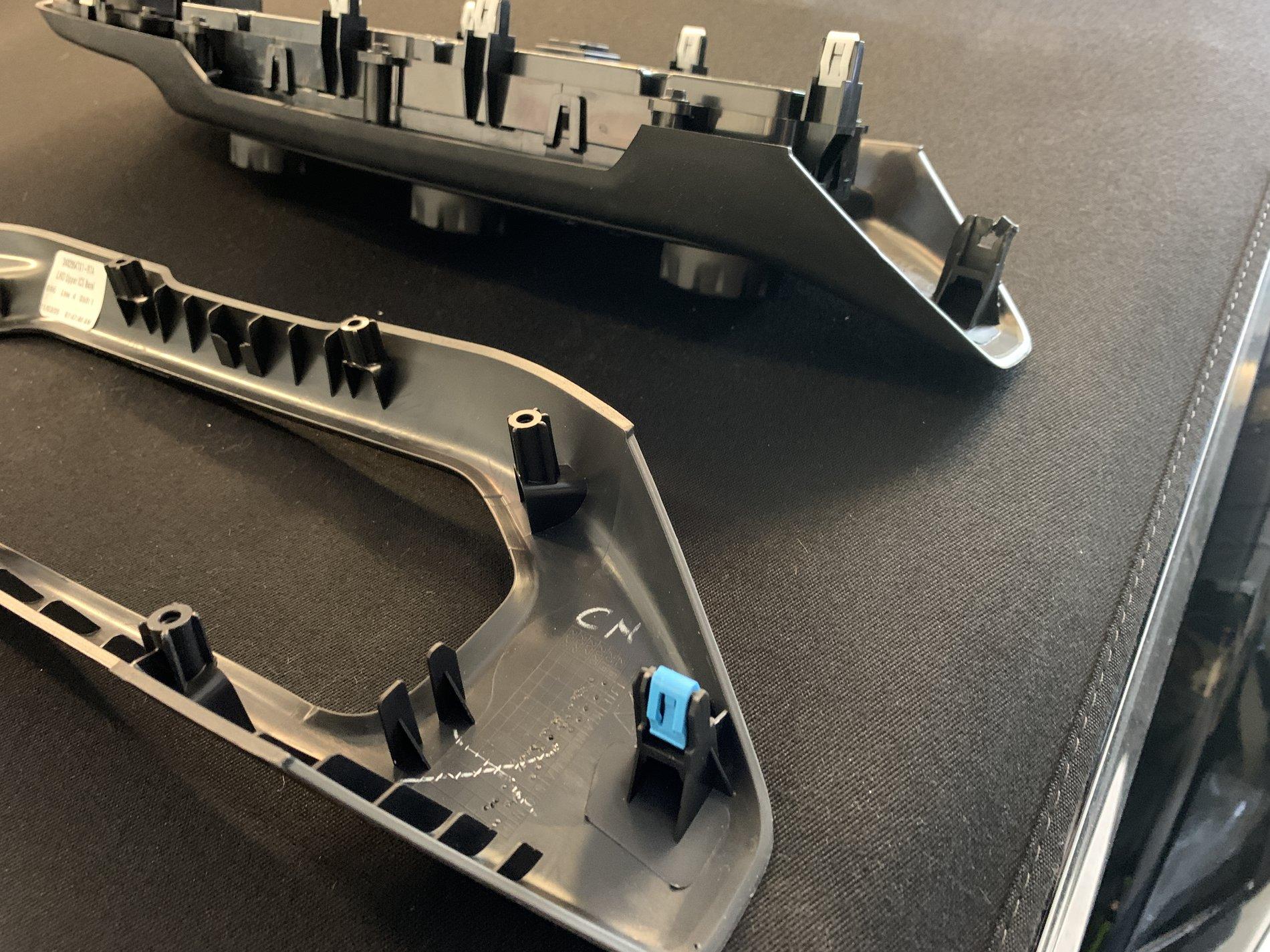

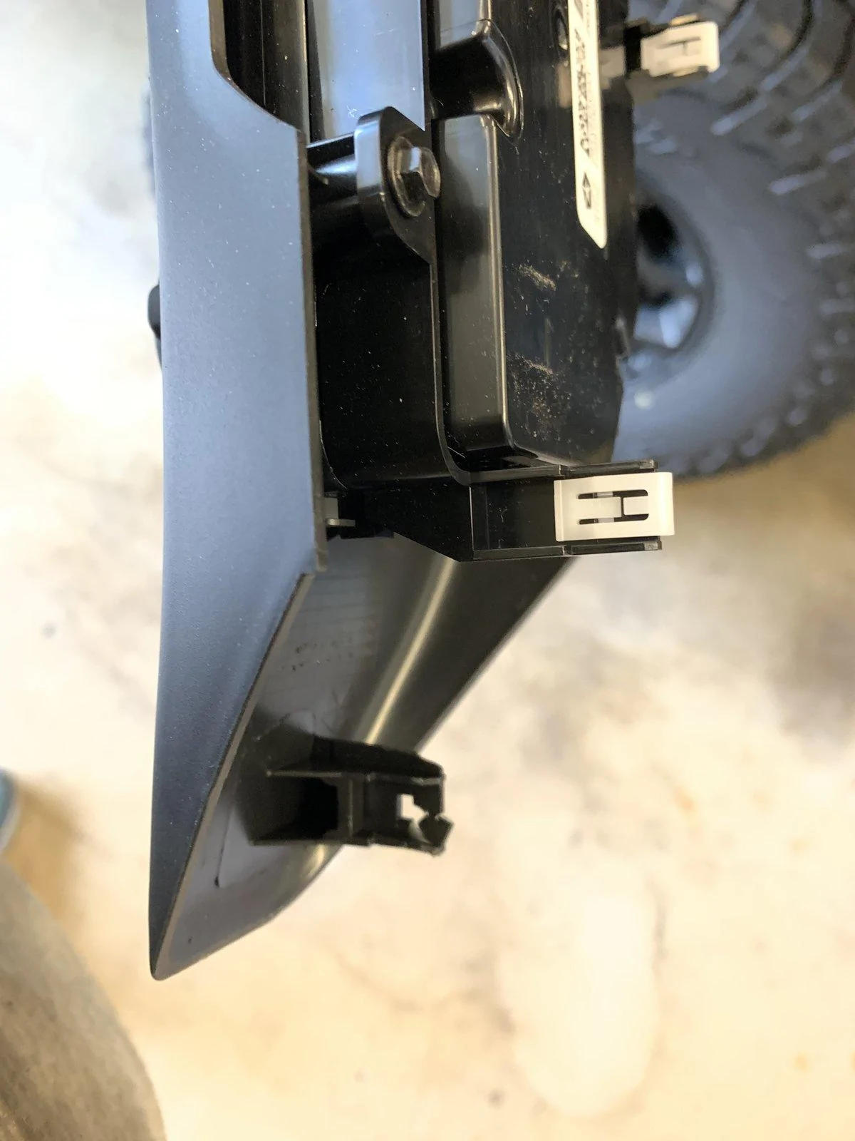

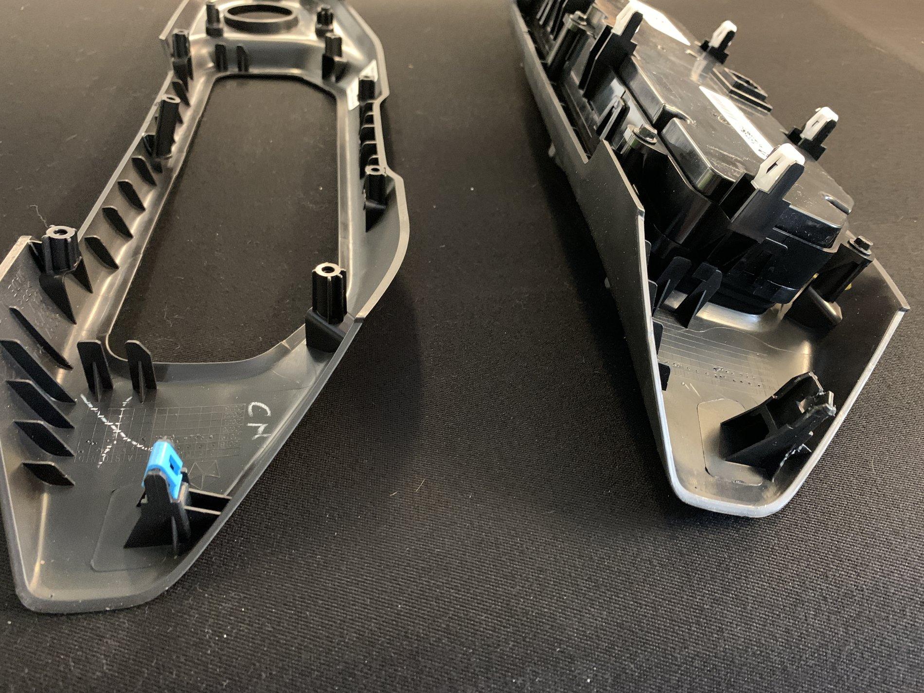

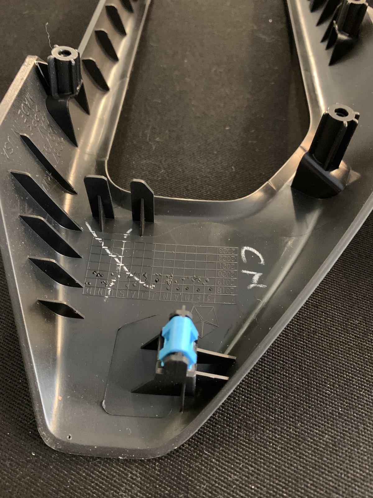

So my OCD was in overdrive, which caused me to go ahead and order the part and make the repair. I posted some pictures below of the offending part and new one side by side. Unfortunately the clip for mine had disappeared, so even if I wanted to fix it, it still wouldn't have stayed. Replacement is really easy, took a few minutes to swap the start button and controls over, they have a surprising number of screws in them. Nice snug fit again now for the trim piece.
I didn't' take a picture of the removal, but I think the issue is that the part you can get a trim tool behind is at an angle, but the clip goes straight in. I think the pulling t at an angle cause it to twist and break. Best bet would probably be to try and get under one of the straight edges so that you can pull straight out on it.
