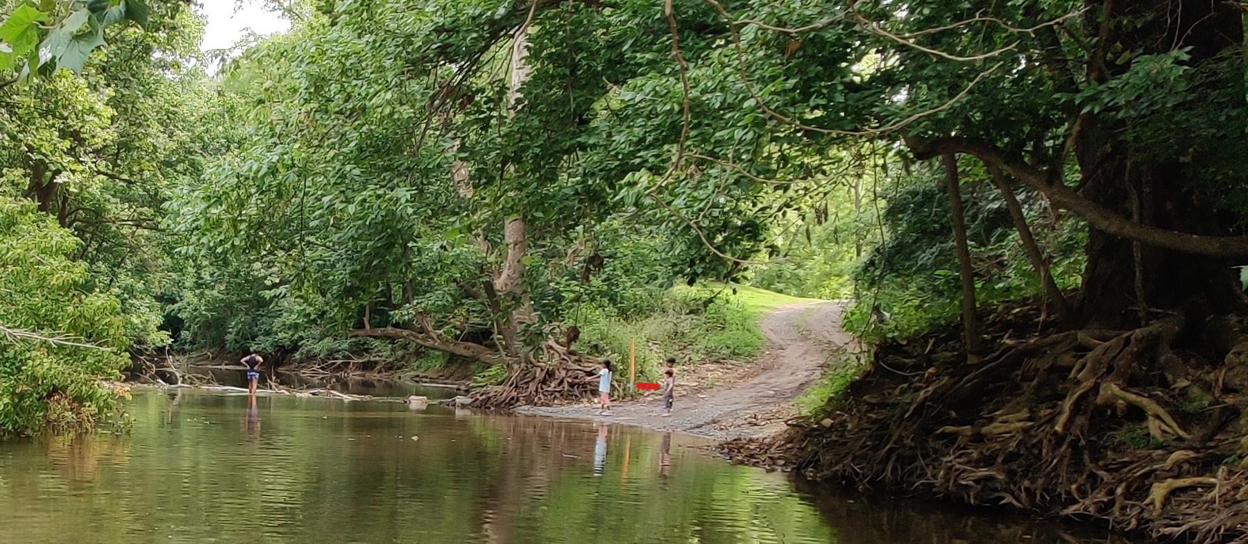

So finally got to take the JT on some small dirt roads over the weekend. Was going to try crossing a small river branch that was about 12- 14" deep back in August.
Was very calm back then and could easily walk into. Saw some guy on a 4 runnings go thru it now issues.
Fast forward 4 weeks and with the amount of rain we got in the last few days the water level was significantly higher. I can't be completely sure how deep it was pretty muddy but the part that scared me a bit was the current that was moving a bit more than before.
If I had to guess based on the before and after pictures that I had taken (the water went up to the bottom of the yellow pole where the kids are standing --- red mark) the water probably would be closer to 2ft at this point. There was a little drop right after the "road" that was made of of rocks so the water was rushing down a little further.
The main thing is that the flow wasn't small so I didn't venture too far in (put the front tire then backed out).

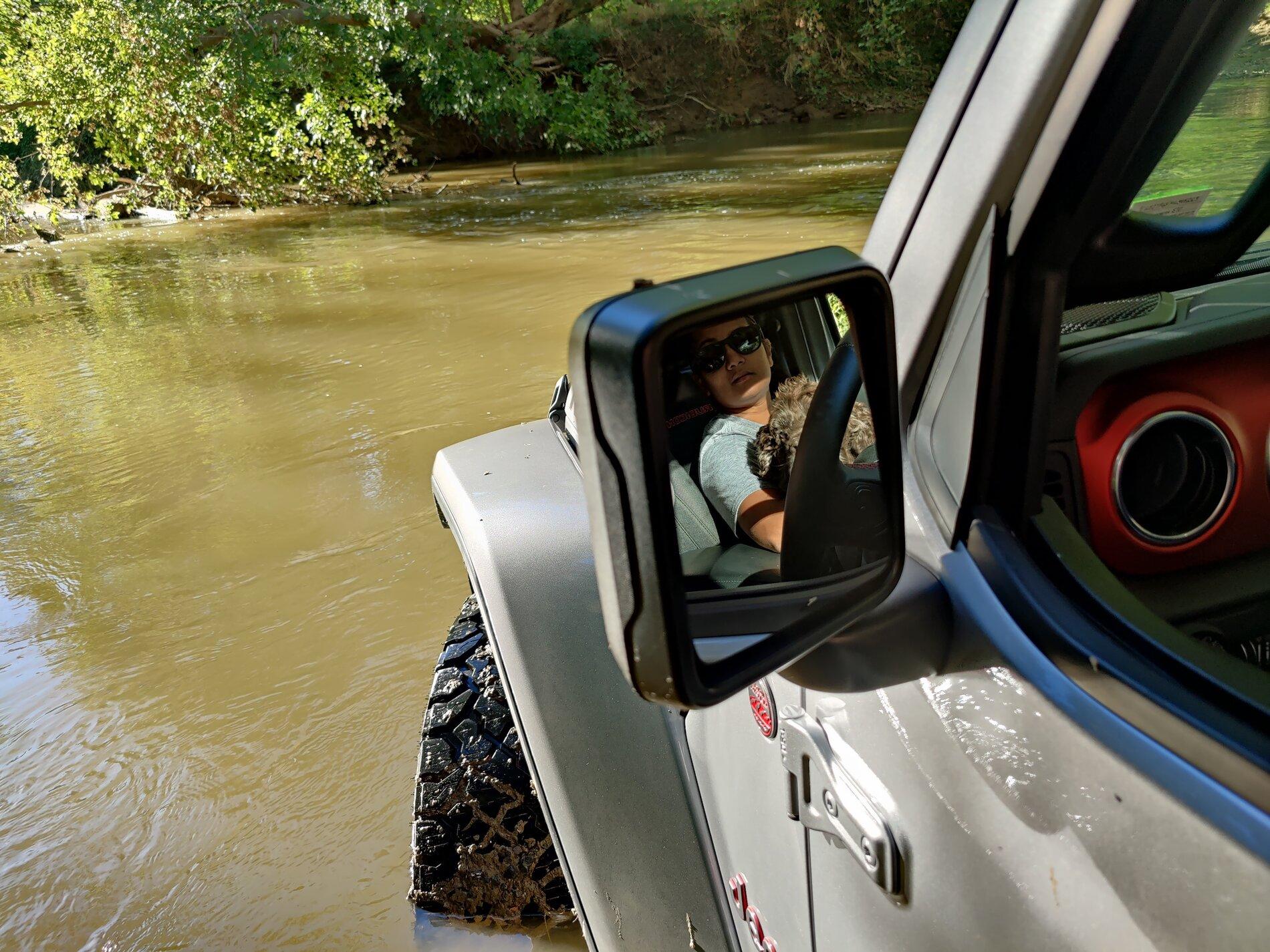

At this stage I'm about where the water line is standing on the first picture.

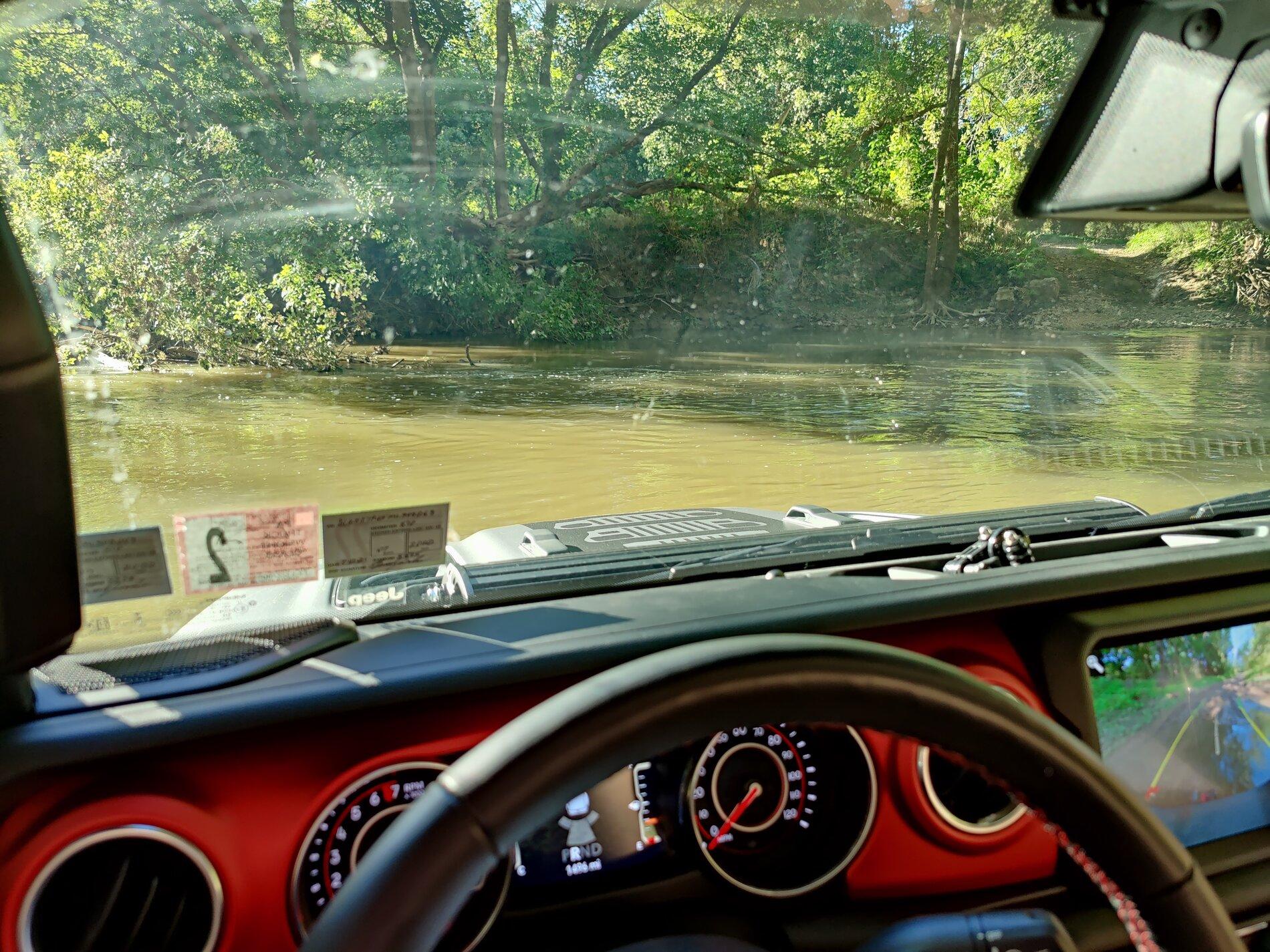

The wife and dog are not impressed!

Yeah we have a river crossing identical to that. I drive around in it all the time. Technically these are rated 30 inches but my personal rule is below the door sill only. I don't want to risk having to remove my carpet and hose it off. Lol.

If you can keep a small bow wave in front of you while crossing, it'll typically lower the water level behind it. So while stationary the water comes above the door sill, moving will make it drop to or below it. It took me a few tries to get the pace right but it works.

Right. I mean at this point I had the rockrails in the water which is fine. I wasn't as concerned about the depth (maybe a little) than the current...
Looked like it was moving pretty good and well didn't want to end up downstream ;)

Go in slow maintaining a steady pace. Splashing in is fun until it's not.
This is for still water, for currents it's a matter of risk tolerance.
