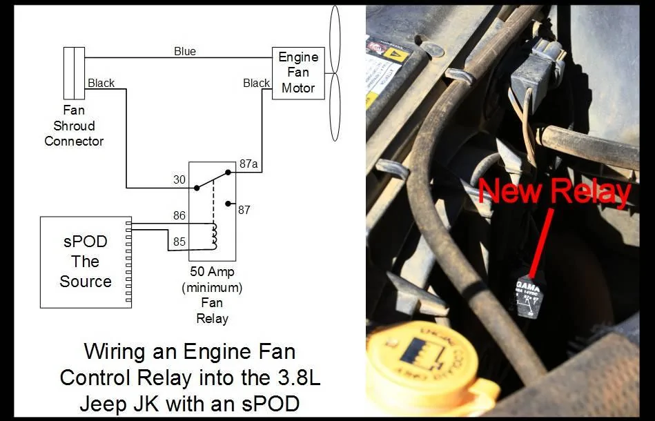

I forgot one other useful mod in my post above: A switch to turn off the engine cooling fan. That reduces splashing in the engine bay. On the Gladiator, I plan to use my last available aux switch to perform that function. I hope to add an 80-amp five pin horn relay that will be controlled by the aux switch, similar to how I did it in my JK through the sPOD. I say "
hope" because the 3.6L engine fan is variable speed, where the 3.8L is dual speed. More wiring involved on the former that may become an issue....
