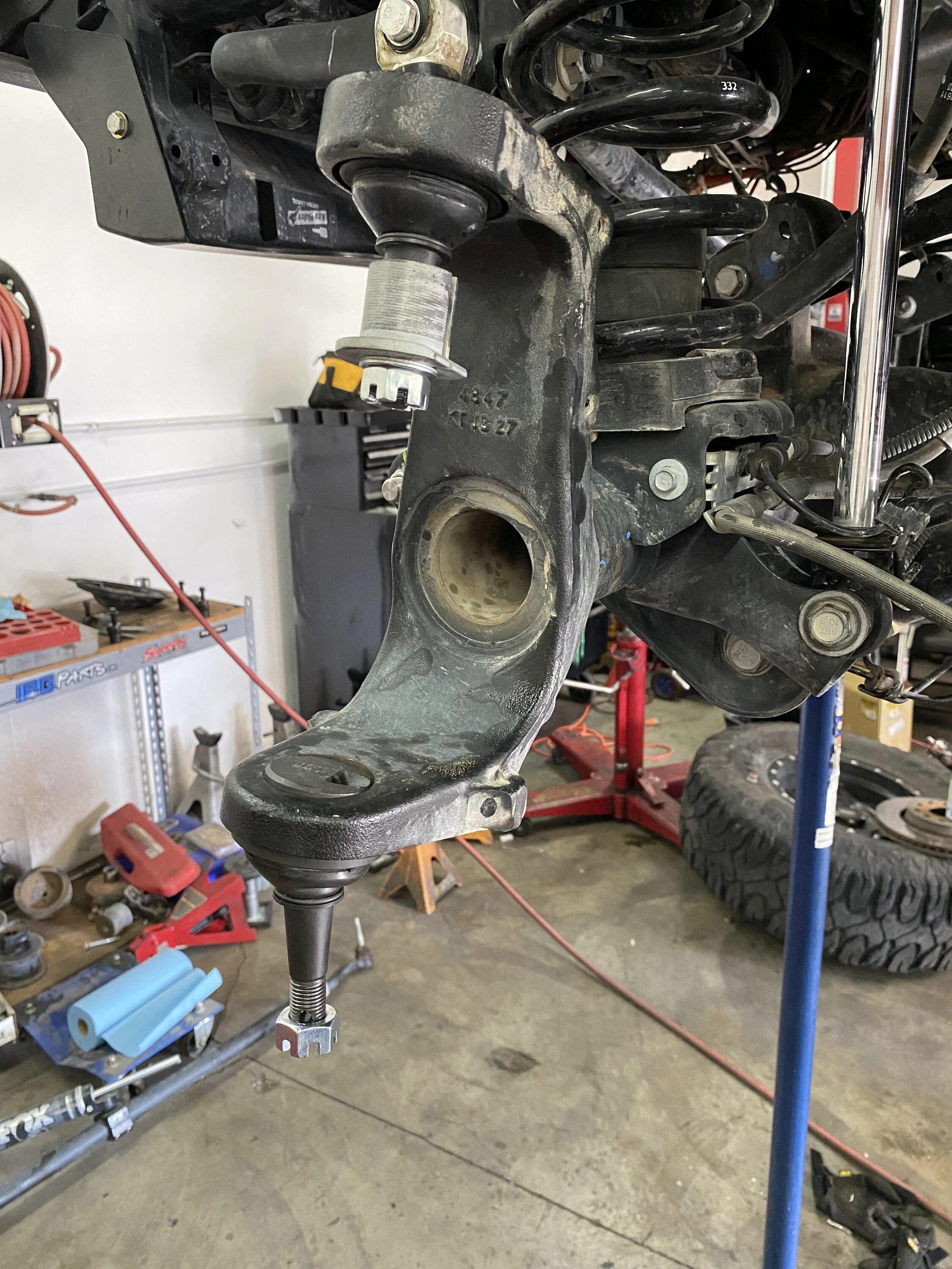

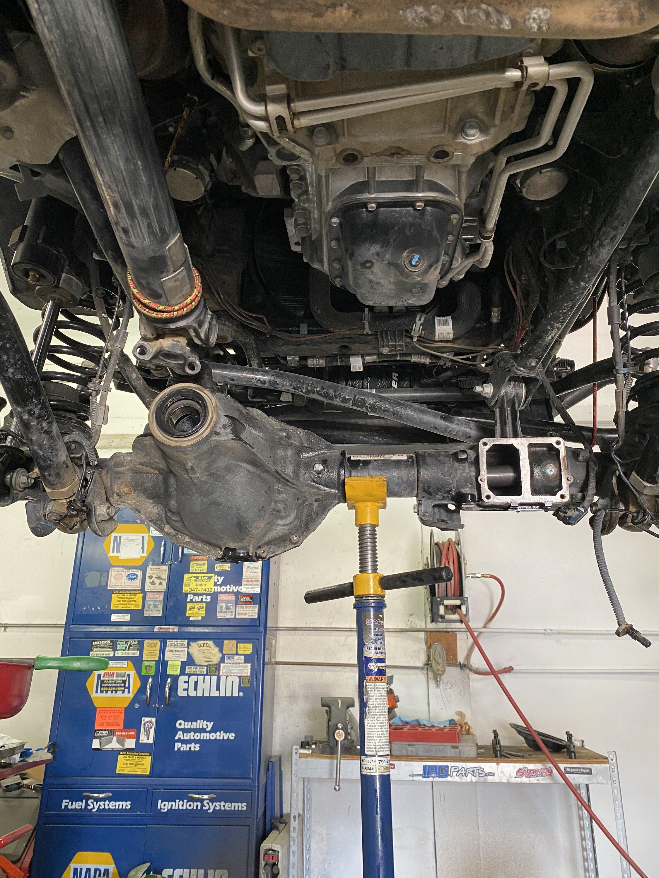

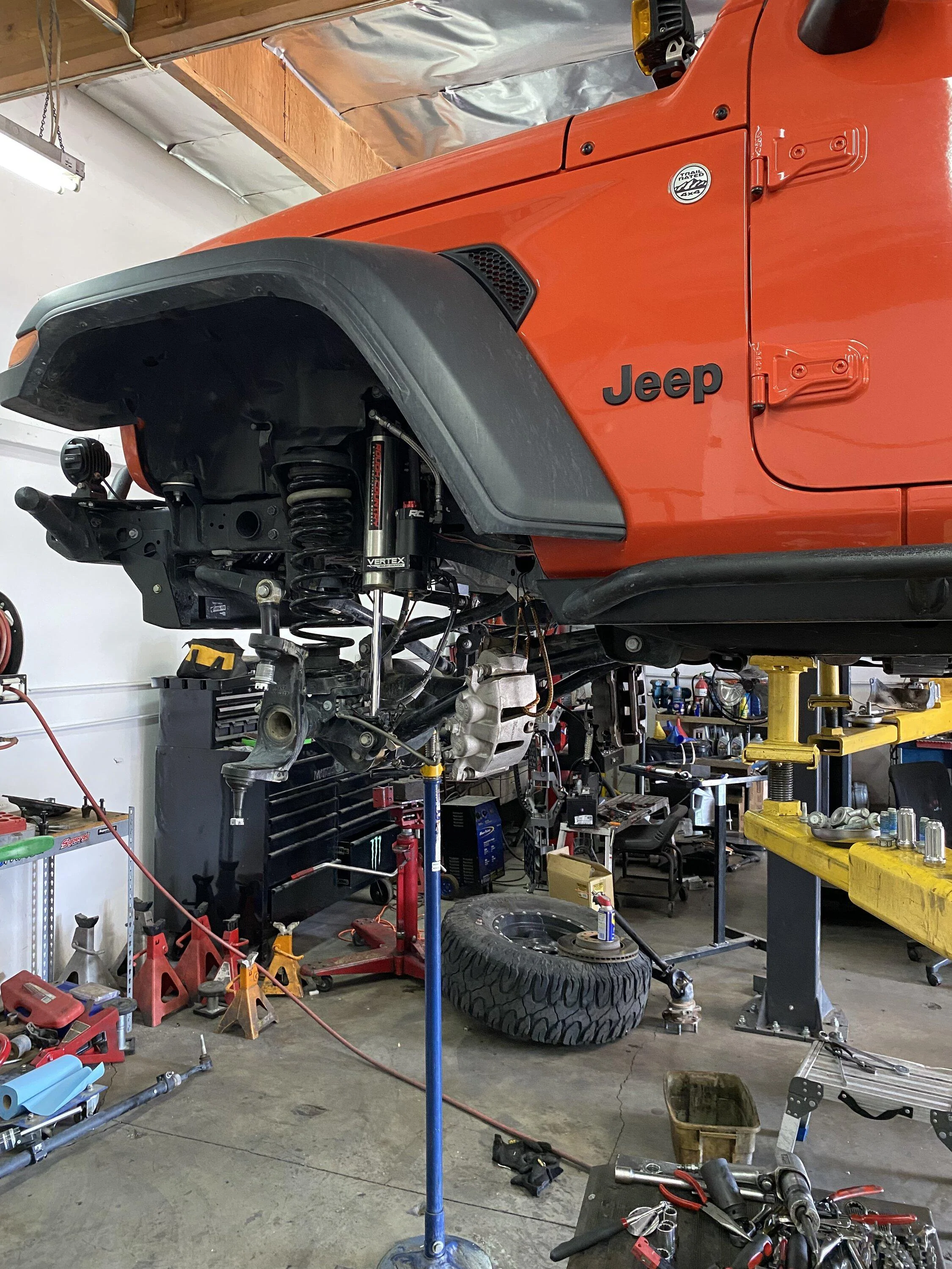

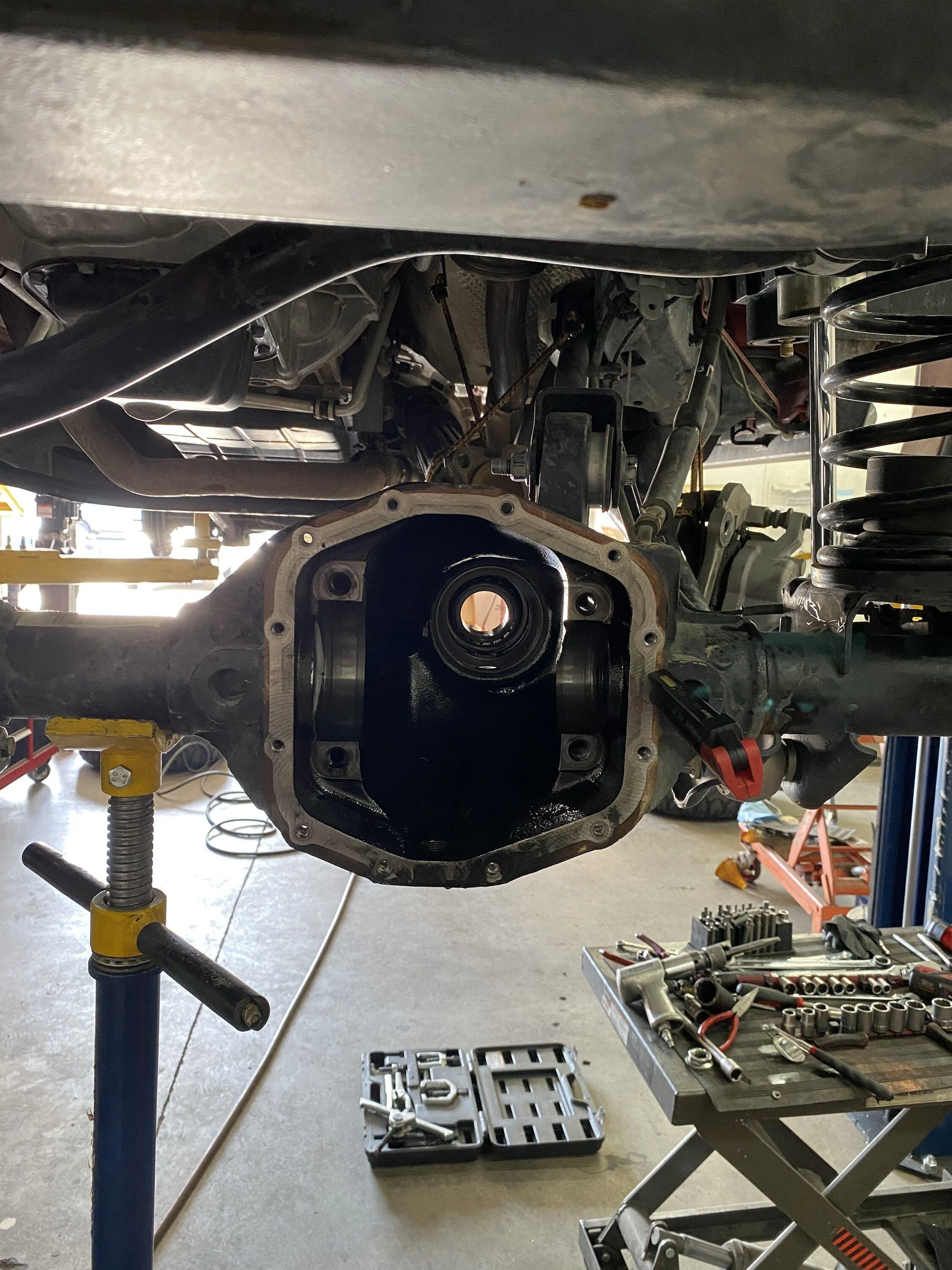

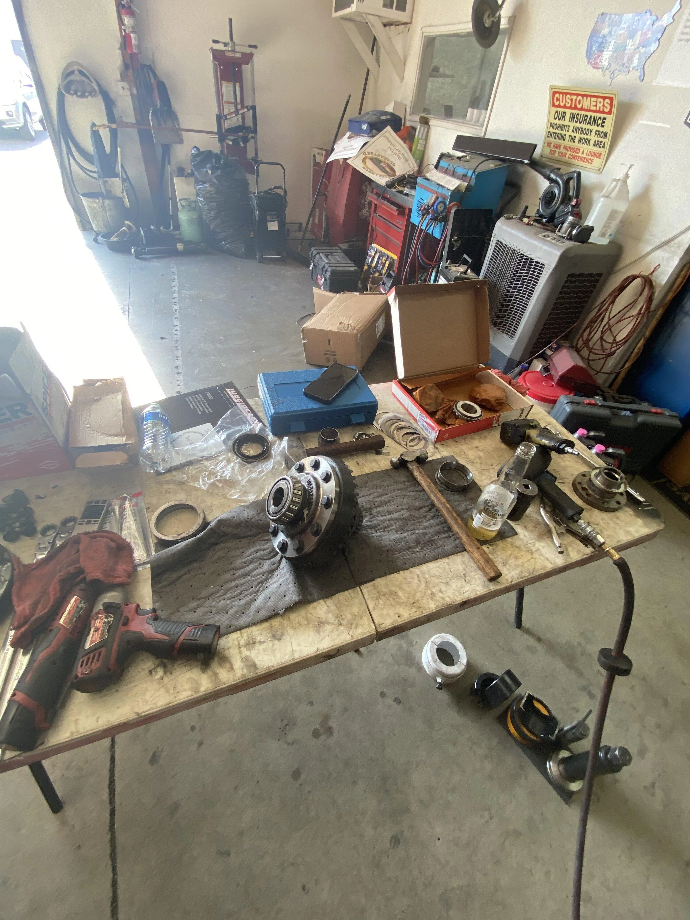

Took us 3 days in a 110 degree shop, but we’re finally done. I wanted to post a few things, and my opinion, as I searched when I had a few tough spots and didn’t get much luck. Here we go!
  1. I am in 8th gear a lot, but my current results indicate 0 to slim gas mileage increase.
  2. It still felt peppier stock. I like the 4.88s better than the 4.10, but its still super slow. Was not a day/night difference.
  3. If you’re doing the install yourself, the crush sleeve portion of the install was very challenging. We ended up chaining the flange to the LCA.
  4. We didn’t not need to use different shims- same setup from the factory
  5. A bolt on one of the ring gears seized and we had to cut it out. Oof
  6. Overall, knowing what I know now, 4.10s were fine enough and I probably wouldn’t say this is a must-do. There’s just so much involved with a regear that I wouldn’t recommend it unless you really hate the driving experience. This is absolutely not a DIY project
