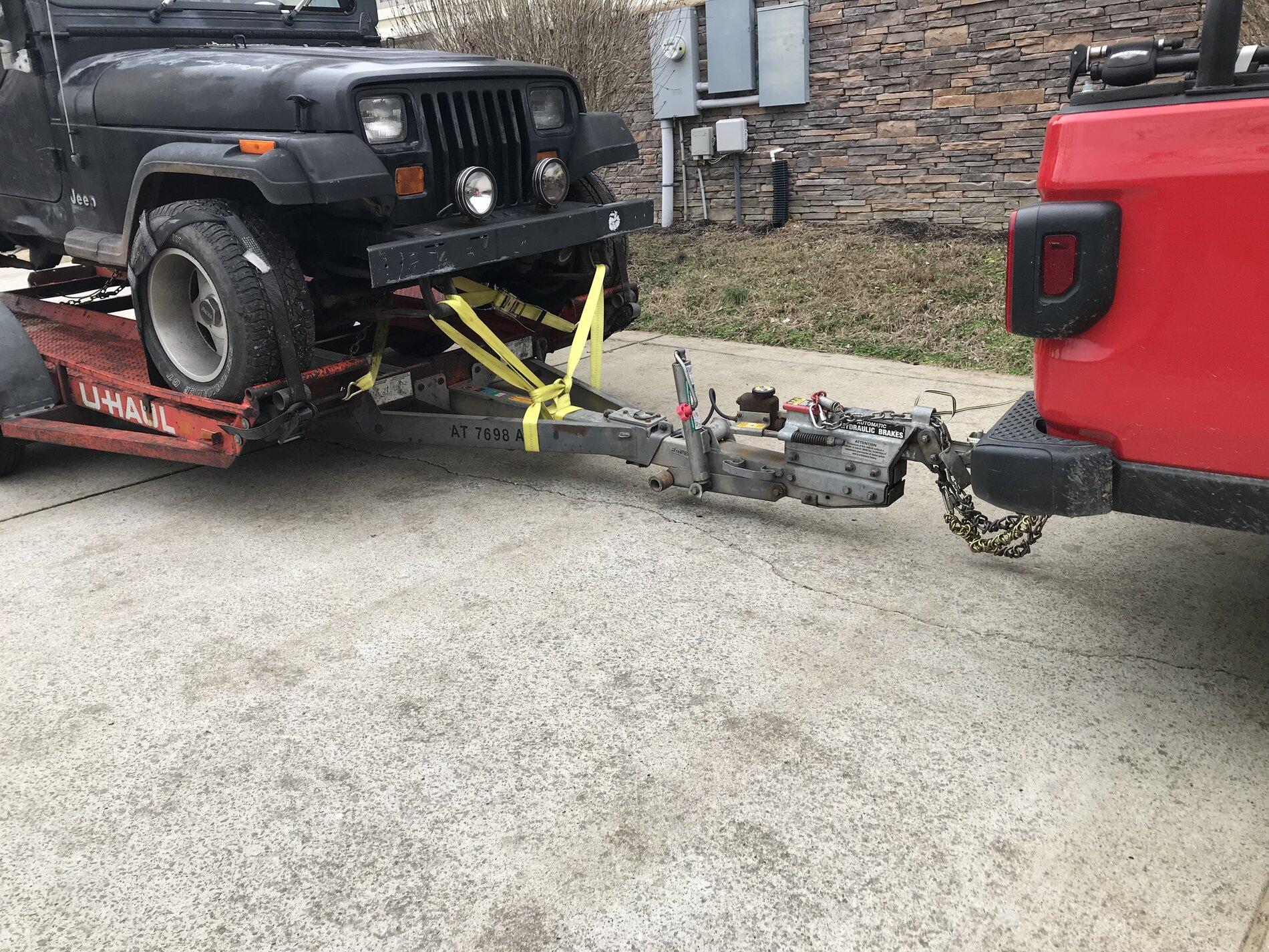

This is how close the trailer tongue was to the ground. tge Max Tow JT has quite the squat, estimated tongue wt about 5-600 lbs. load leveling hitch would have been much better

I just towed a Jeep YJ on a 2500lb U-Haul trailer (the old steel one) total weight was around 5500-6000 lbs.
Jeep Gladiator Weight distribution hitch - do I need this?!? 79158249-BF9D-4F5B-B869-24911C054DA4
That load definitely needed help!
I never would have pulled it with safety chains that close to the ground with the way fires get going around here.......
That is a little distorted as that is low spot on my detached garage driveway. The trailer nose is at low spot with Jeep and trailer higher up opposite slopes.
The Jeep handled fine on 166 mile trip, no sway and nothing touched the ground. Definitely wished U-Haul allowed me to use a load leveling hitch. I also wished they let me take the newer lighter weight aluminum trailer (it was already reserved).
Surprisingly the front end of the JT was not light and I had no issues with light steering. The JT handles very well.

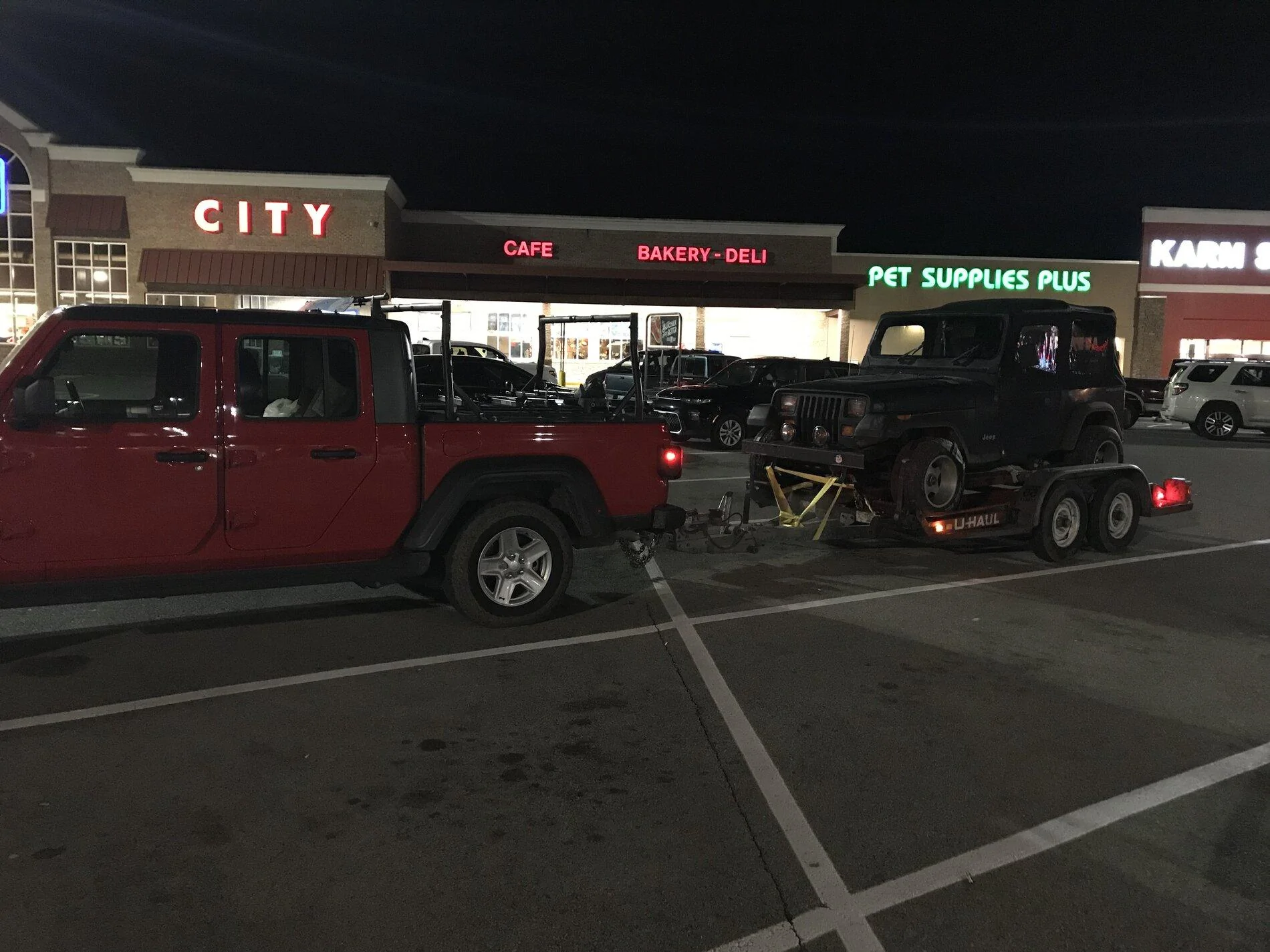

Here is level ground night picture. Still needs the load leveling hitch.
