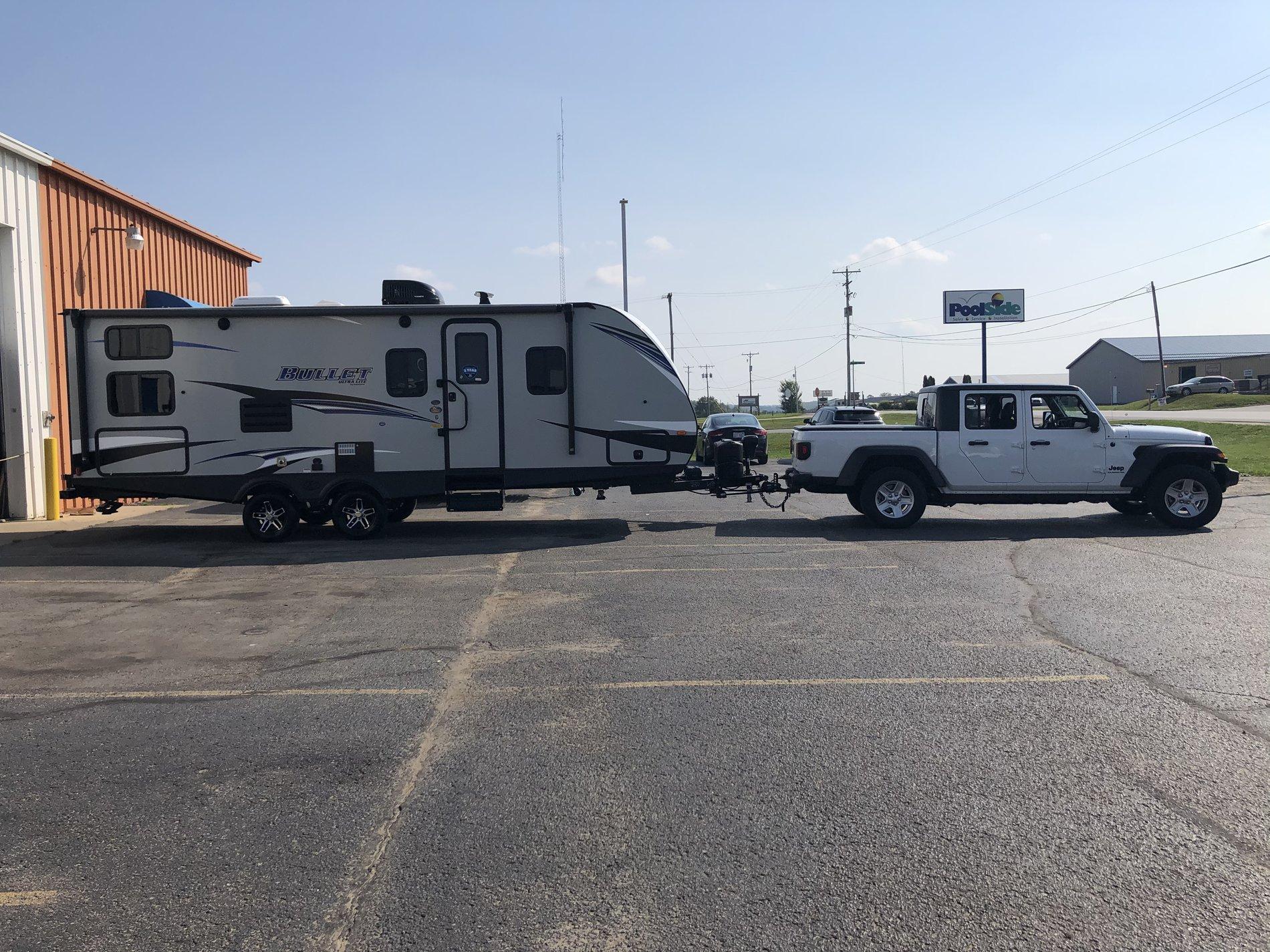

I have this one and it works quite well. I've only towed with it three times and haven't had any issues.

Nice, what are you towing with it? Did you buy from e-trailer?
Yeah, we bought it from etrailer. Hauling this. 5000 lbs dry weight. Took it camping this past weekend and would guess it was 5500 - 6000 loaded up. Pulled fine.

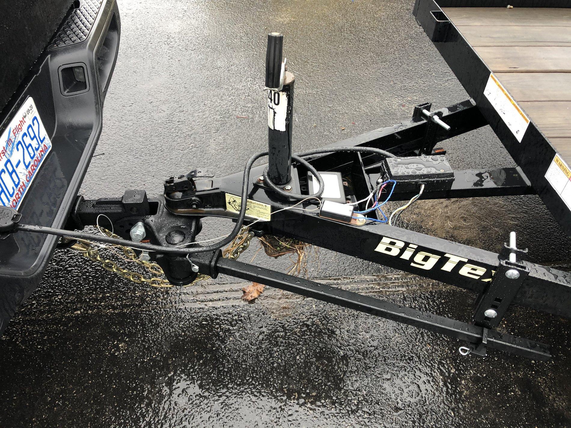

I ended up getting a Curt 17500. Couldn’t beat local price for it and got the installation for free as well so I didn’t have to mess with it. Haven’t tested it with a load yet but my JT pulls my 16’ Big Tex car hauler trailer much better now - my area has crap roads and I felt it bouncing around much less than before. It’s definitely a beefy unit, too, so hopefully it keeps me safe on my road trip (NC - CA).
How heavy is your trailer - empty?
Your BigTex looks to be a lot lighter than my PJ was - it was 5" channels clear to the front. Yours looks like a clean easy to use setup.
My prior trailer, a PJ 18 footer weighed 2350 empty.
I never used a weight distribution hitch with it as it was long enough with the car loaded right there was no problem and with my Silverado, the back dropped minimally.
My new trailer they say WDH is a no-no. Companies that make the aluminum trailers say never use such a hitch.
Will be interesting to see how the JT handles it.
