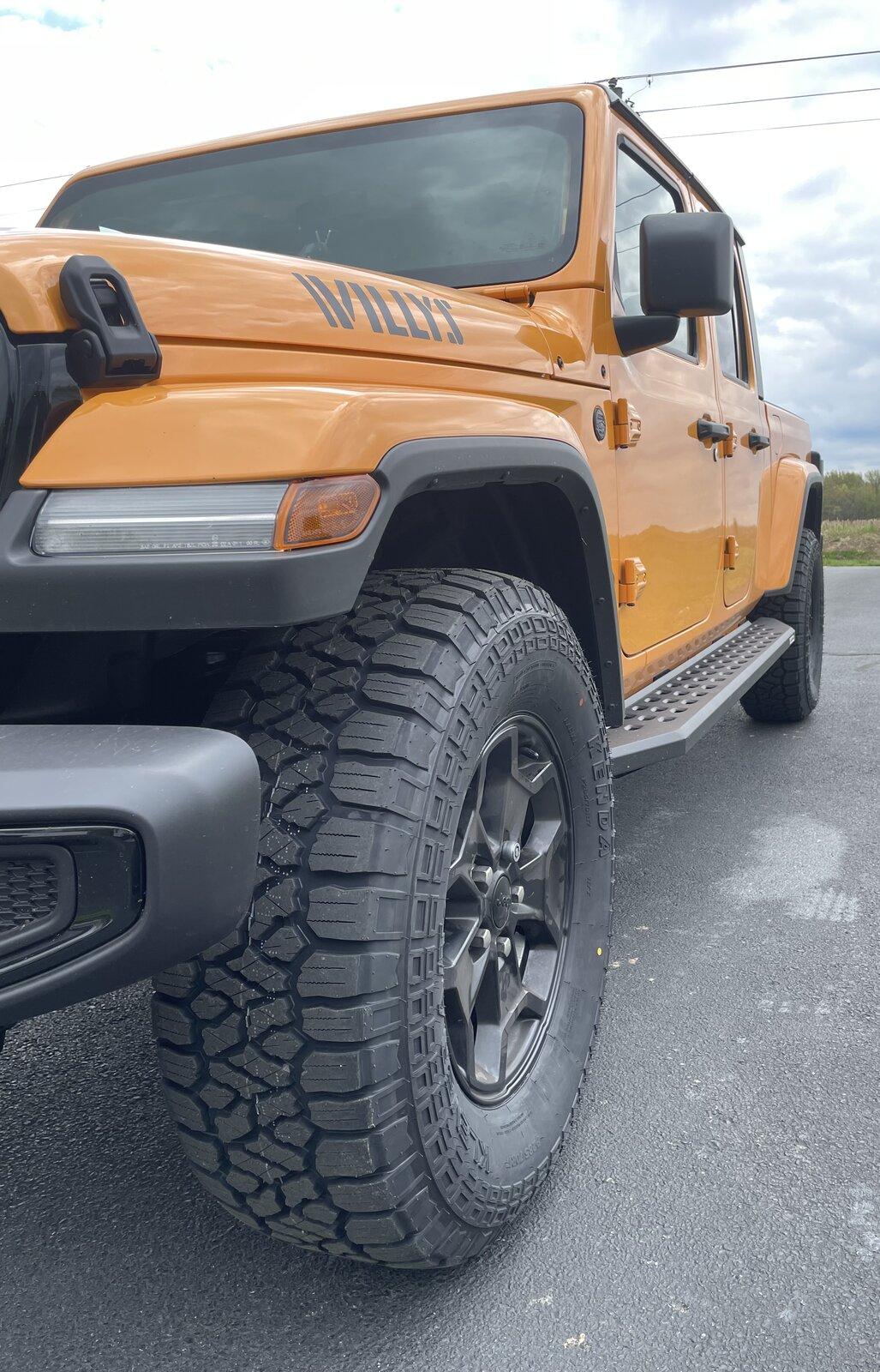

If you don't want to go bigger you should consider the Kenda Klever AT2s in P285/70-17. They weigh in at 46lbs each.
