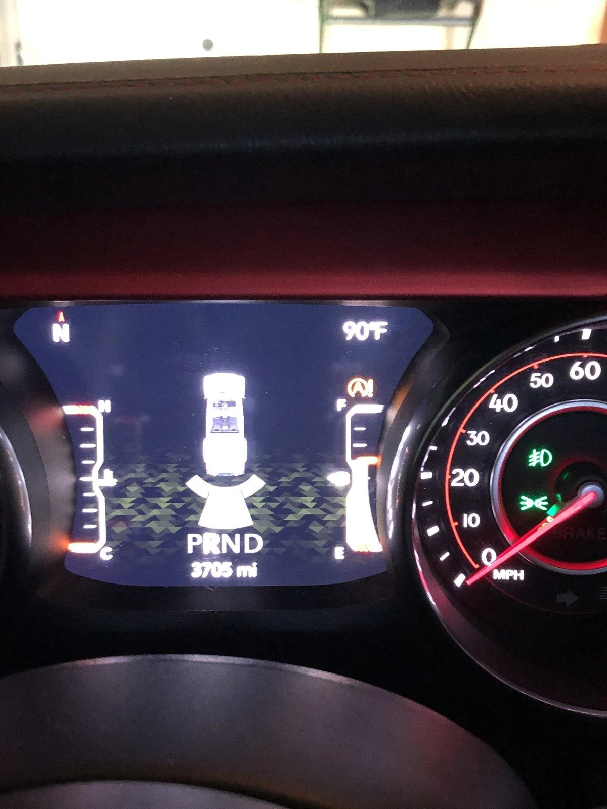

so this has been on my dashboard for a few days....regardless of the button on center console is pushed to activate/de activate the ESS....
Ideas?

First thought is the hood latch. Is it locked down right whereas to depress the sensor on the right side? If not, possible 2nd battery issue?
Haven’t touched the hood since purchase. Guess I’ll wait and have dealer check it out during first oil change. I usually get oil changed before 5000 miles.

That is a fault indicator for the start/stop system.

Like Hootbro said, it's the fault indicator for the auto start/stop system. Take it back to the dealer and have them check it out.

It's your auto start stop light. If you go to your messages in your display above the steering wheel, it will tell you to service the auto start system. In my Compass this light came on when the second battery under the main battery refused to keep a charge. It was replaced under factory warranty.
