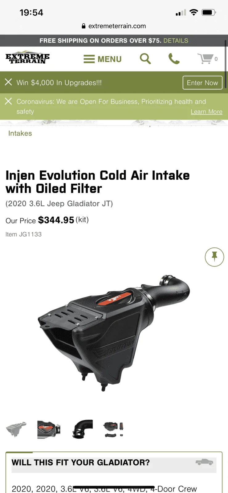

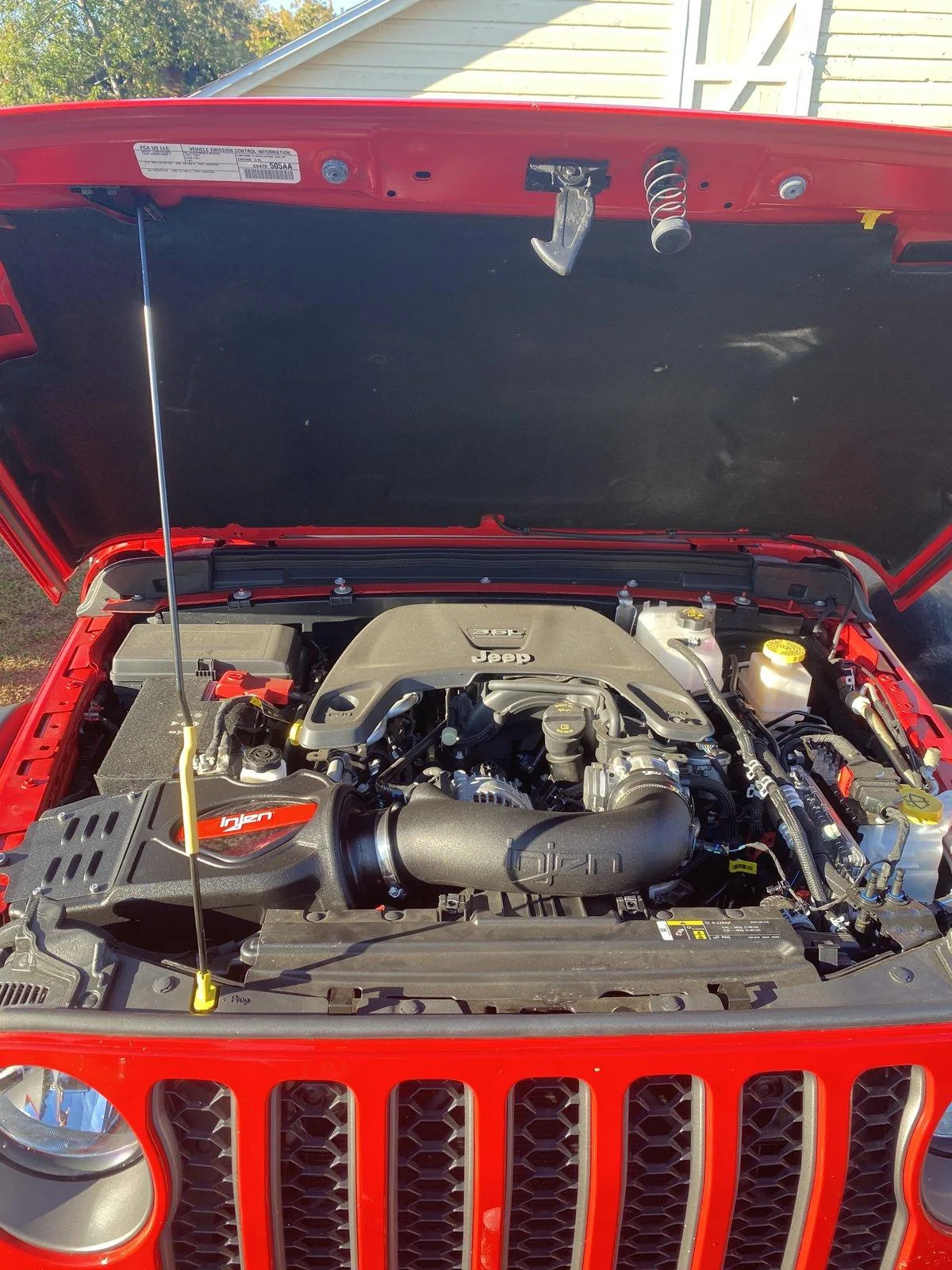

I just put an injen cai in. It’s set up for the snorkel part put as of now it’s just the intake. Obviously your not gonna get hp increase but it makes it sound more like a truck and not a JL.. I love the sound. As for ruining the engine, as long as you clean it and oil it you’ll be fine.
what is the part number for the CAI you used?
