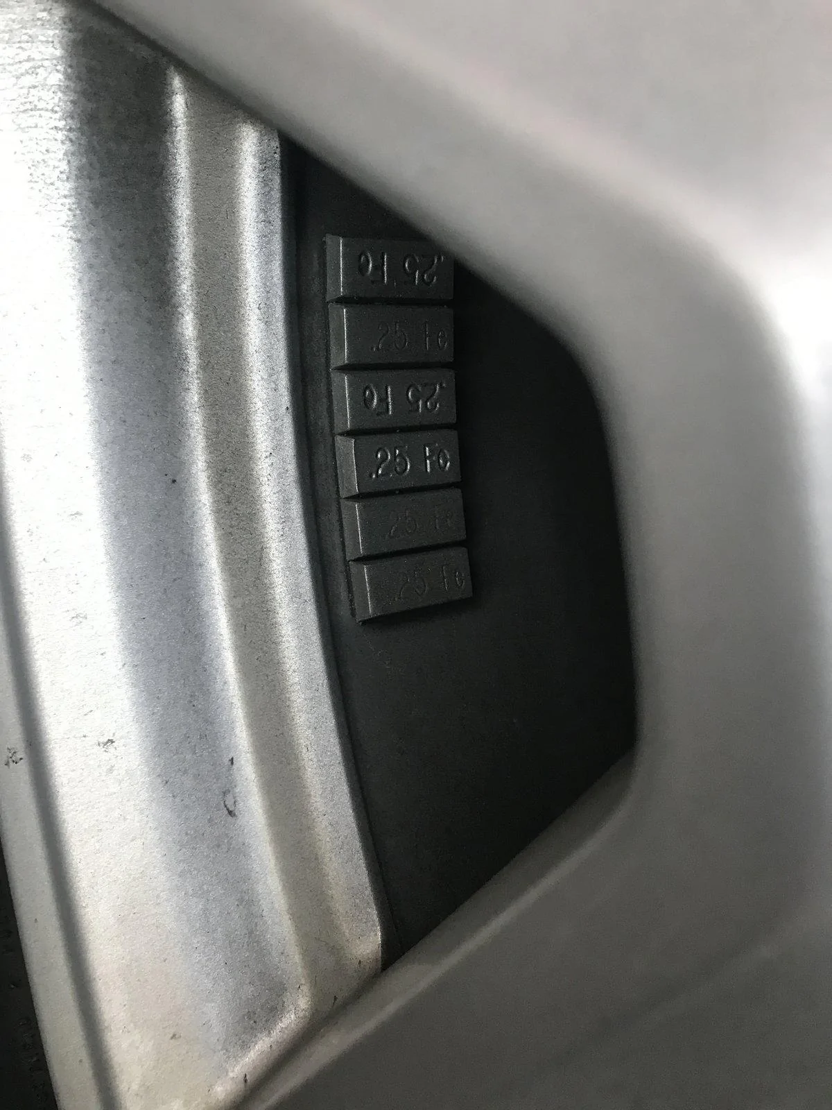

Looks like they say .25 Fe. What are they? Are they on the actual wheel? Do all Sport/S JT models have them? Are they needed if swapping wheels?

adhesive wheel weights used to balance the wheels The goal is to make sure the weight is evenly distributed throughout each of the wheels and tires on a vehicle. This process evens out heavy and light spots in a wheel, so that it rotates smoothly.
180
29,491
35,091
...and the numbers are the weight and you break off however much weight you need and adhere them to the wheel.
Or maybe that's the number of miles before they explode..........
Since there's no metal edge for the old-fashioned clip-on weights they have to use these, and it's better anyway because they can be placed more accurately.
And they donā€™t mar the wheel as the hammered on weights do.
180
29,491
35,091
Amen to that. My Silverado wheels were messed up in part to the weights they used. Same for some other wheels I had. Give me the stick on weights. Takes heavier weight to balance that much closer to center but keeps the wheel looking better longer.

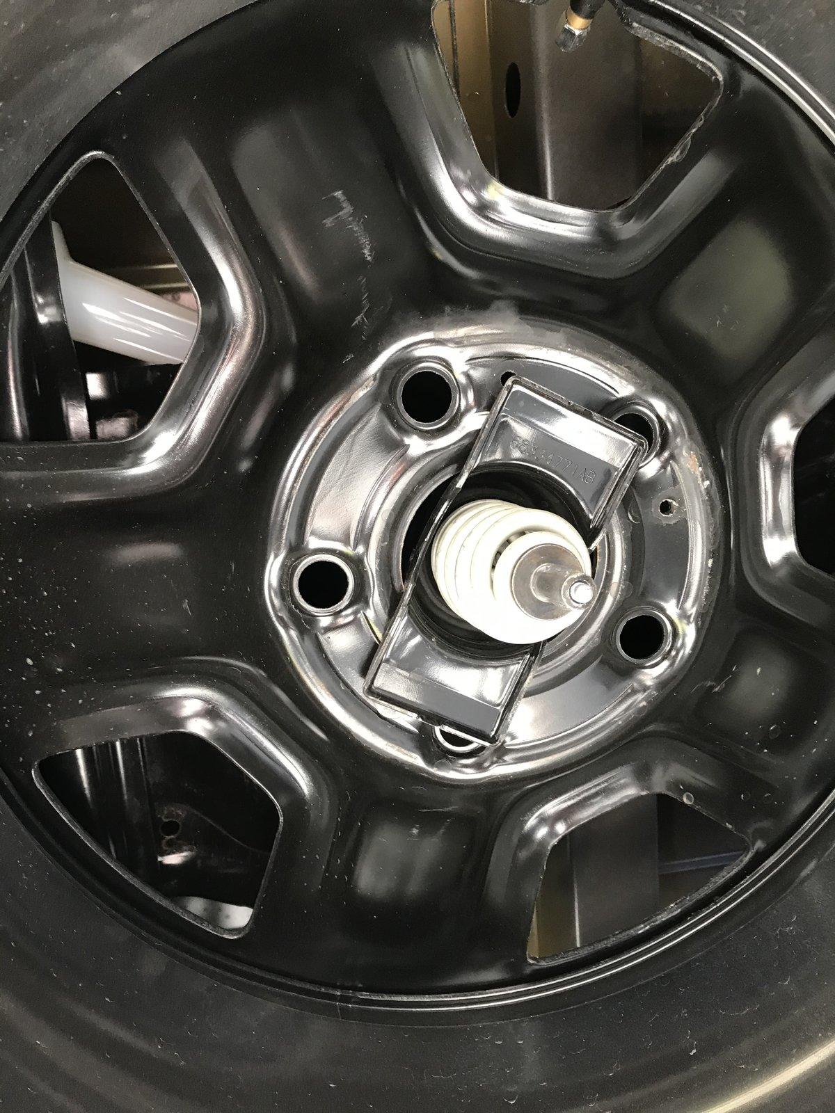

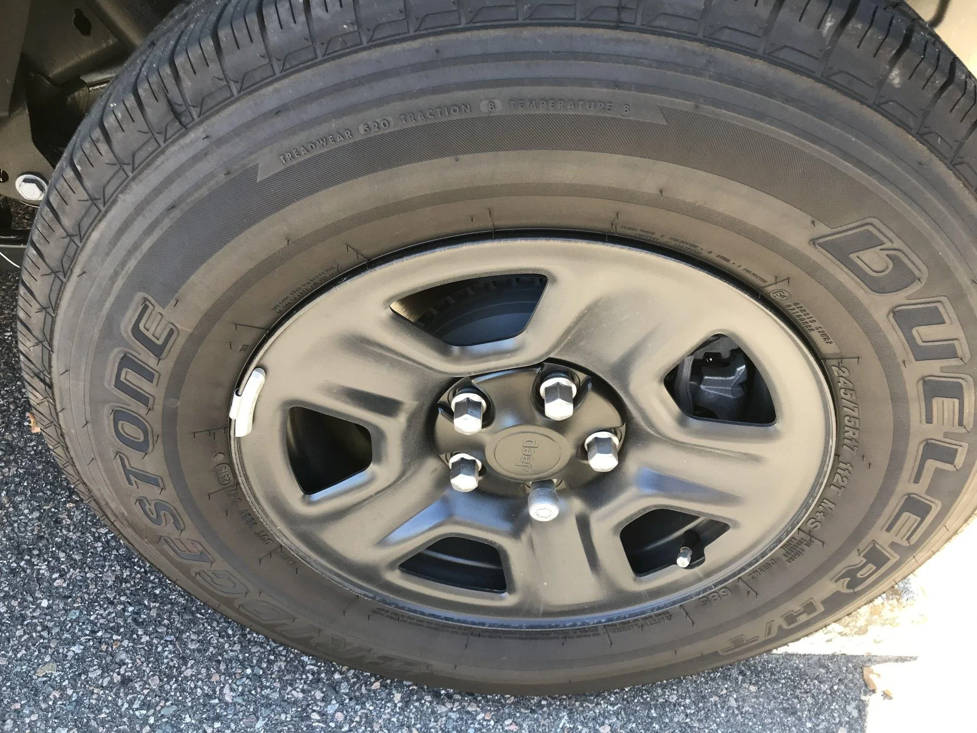

They did balance my matching black spare. It has a normal looking weight on it mounted on the outside. Interesting idea of @ShadowsPapa to possibly put the weights on the inside. See attached picture of my matching spare and another picture of one other tire/wheel on the ground with a normal weight on it. Spare is stowed outside up. Is stowed that way in case you hit your spare wheel on a big rock or curb then the outside of the wheel does not get scratched or scuffed up.
