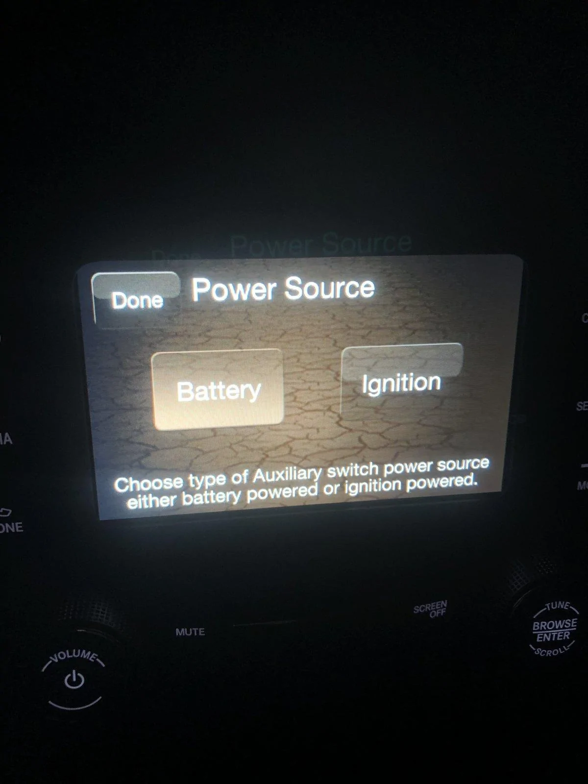

you can make the factory installed aux switch work either way through the touchscreen. Hot always or just when key is on.
Pretty sure the USB is always hot in my truck.
Thanks Cape Taco. Which option on the touchscreen? I'm 240 miles away from my Jeep ight now, so I can't try it out myself just now. Thanks in advance for any info.
Settings, aux switches, pick 1-2-3 or 4. Each switch has an option to choose battery or ignition.

Thanks!
I have the more-limited screen, but hopefully that works.
