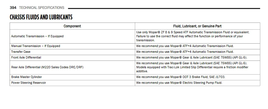

Recommended fluids are all listed in your Owners Manual.
As seen below, the 2021 manual makes no differentiation for the Tow Package.

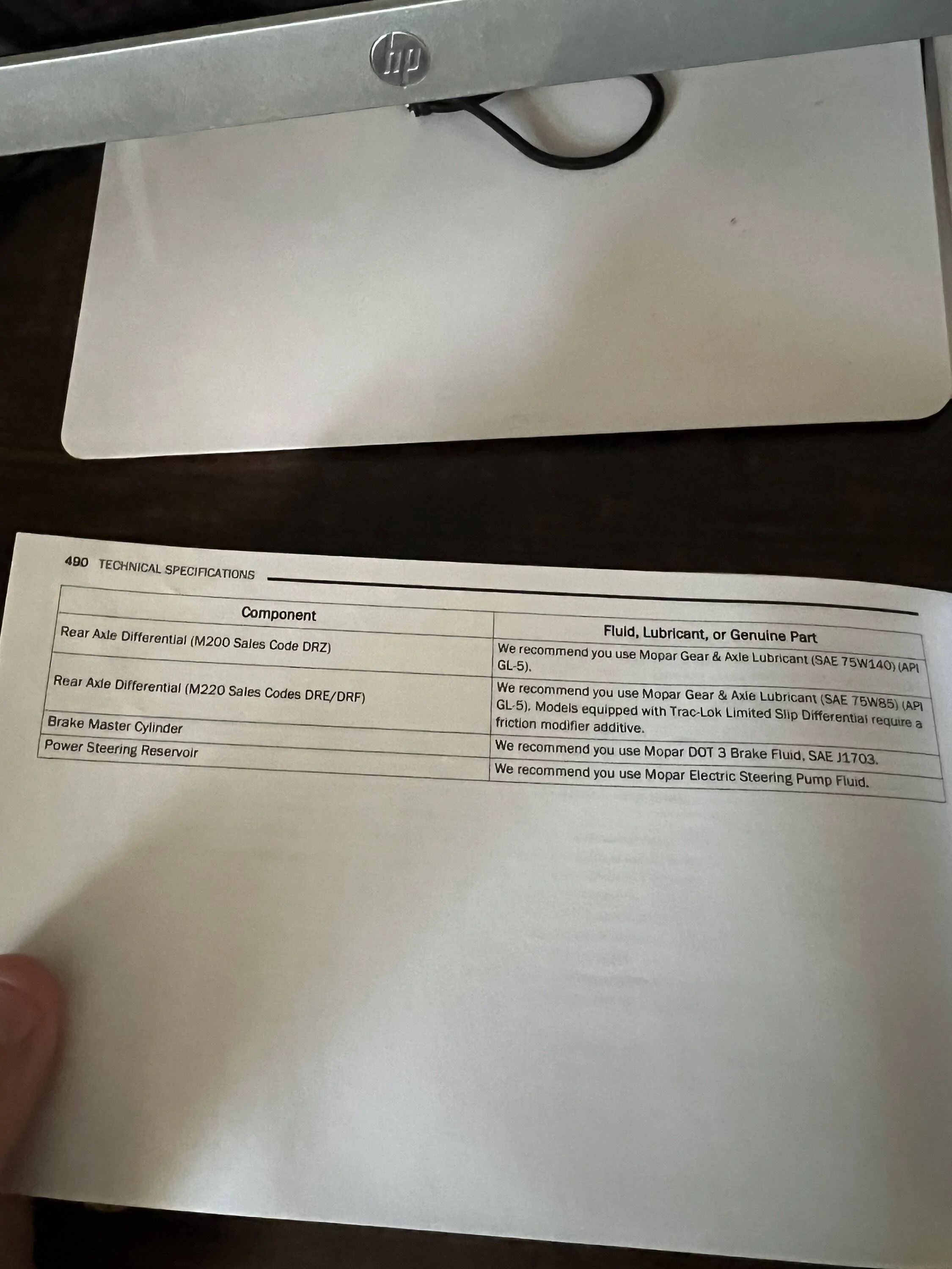

So issue is it says 2 different Lubes for Diesel. Gladiator Rubicon Diesel w/ Tow Package. In my owners manual.
One for limited slip differential and one for without.

There is only 1 lubricant specified for your application. Your rear axle is a M220. You could look at your build sheet to see what your sales code is.

Got it I factory ordered so I have my build sheet

Mopar Tech Authority data states you can use 75W-140 if you have the Trailer Tow Package.
