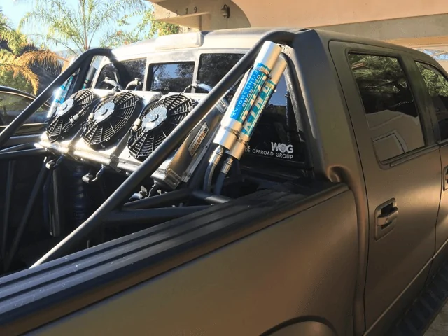

Cooling is easy. fully delete all EPA garbage and put a huge oil cooler in the bed with fans.
Done.
Done.
I can see a 6' tall chiller tower in the back of someone's Gladiator, water running down it, big squirrel cages forcing air through the fins.
@californiajeeping
Apr 1, 2020
916
922
California
2022 Jeep Gladiator diesel, 1977 cj5 LS swapped
I was thinking

That'll work and it looks cool, too.
Im going to start with a small lift and 38s. If i really end up wheeling this and loving the diesel maybe ill go full crazy. Right now its nice having a jeep that can tow my 52 cj3a off the towbar easily.
