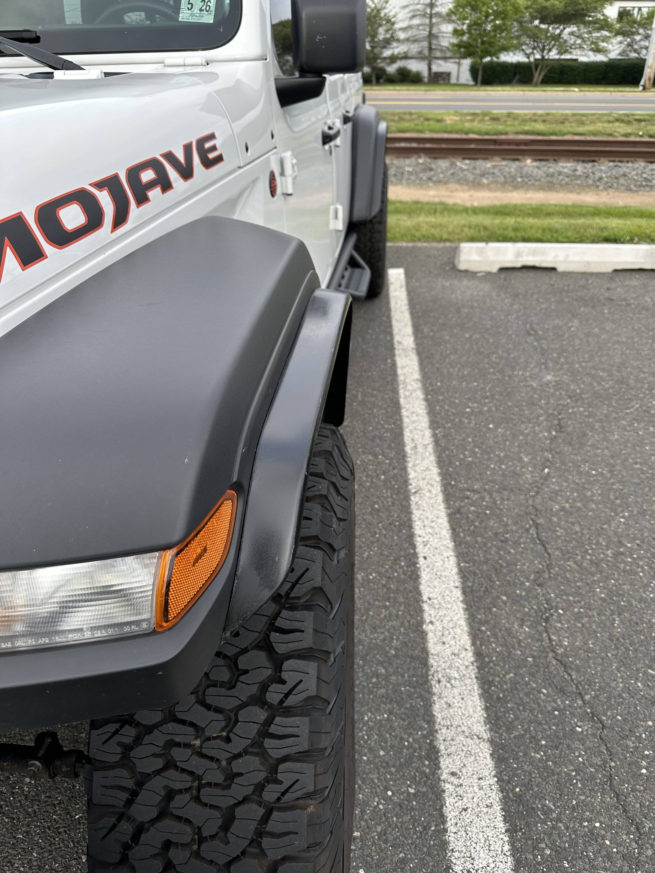

Switched out the Method 305NV (red) wheels to the Method 703s (bead grips).
Will be switching the American Adventure Labs front chop kit to @Metalcloak's fender gut kit with lights, to match my suspension. For my front fenders, I gutted the inner fender well's, and that's why there may appear to be a bigger space than normal. A little disappointed with AALab's quality of the lights.
Glad that Metalcloak is able to take care of veterans like myself! (Shoutout to Bobby!)
