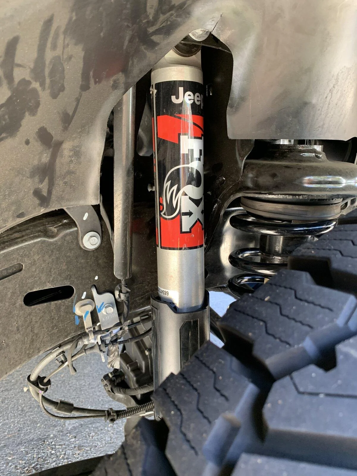

When you installed it, did the piston force its way out or did it stay in position on its own? The reason I ask is because I’ve had issues with steering shocks in the past that caused a pull because it was pushing out.
It did force its way out…
Gren71
Jul 9, 2019
143
4,004
6,342
Magician
Ive read about what the other member is referring to, where the piston pushes its self out and causes a drift to that direction.
I actually had this with my fox until I read on here somewhere to "cycle" the damper a bit. Basically you compress it fully a couple times and it should level out as it where. I did it to my fox damper and never had the issue come back.
If its already installed just drive in a large open space and take the steering to full lock in both directions a couple of times and it should have the same effect.
But if your not having a problem, dont fix what isnt broke! lol

Yes! You need to cycle them say 3 times before installing.

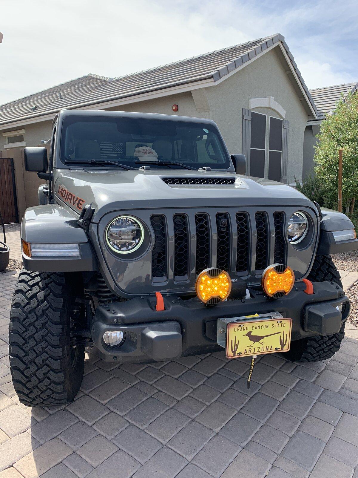

Mocking up the front bumper before getting powder coated. Shrockworks bumper utilizing factory LED fog lights. Tabs on top are for light pods which will probably get added in the future. Ordered bare metal to match the powder coat of my White Knuckle Sliders.
