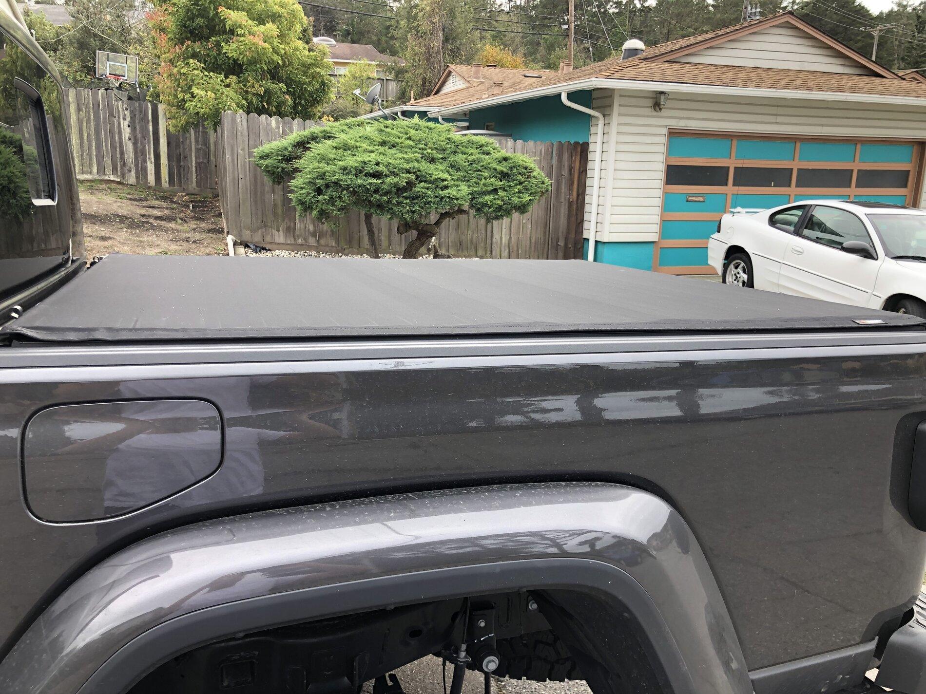

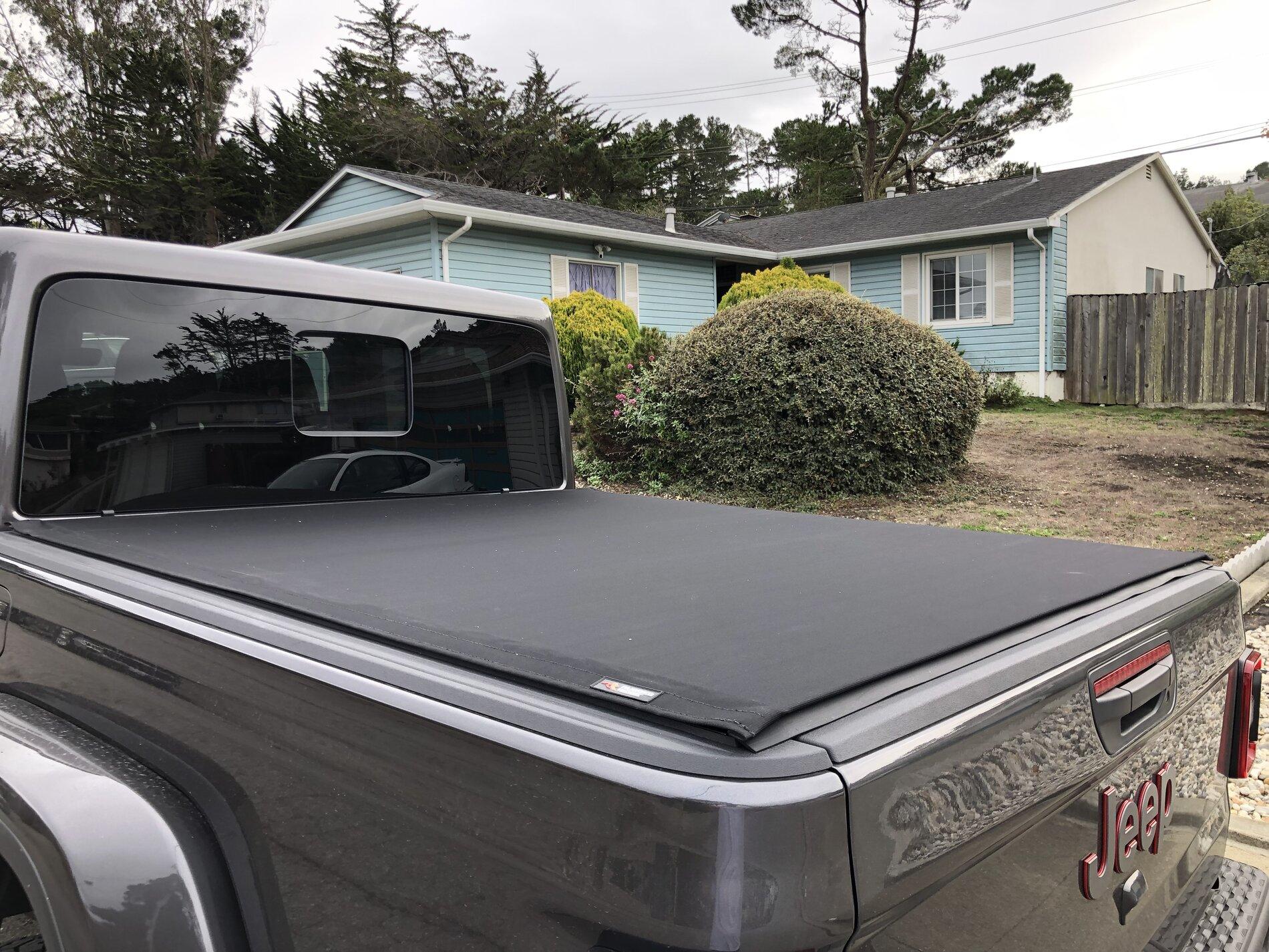

Good so we want to use tax paying citizens firehouse for our own personal projects?!Installed a Rugged Ridge tri-fold cover. Pretty happy with the fit and quality. Installing the bulkhead bracket was tricky. Having a friend with long, skinny fingers is recommended though.

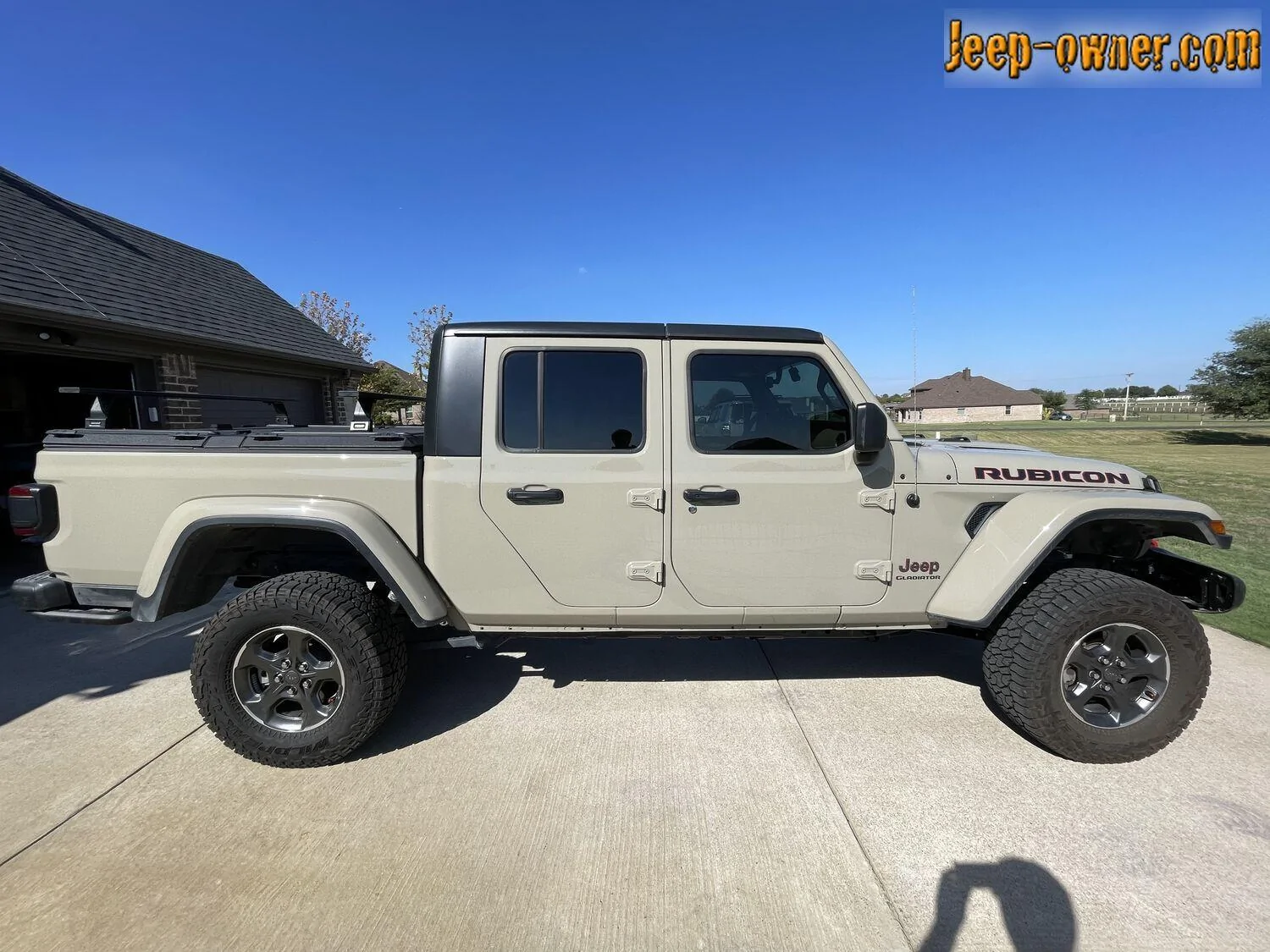

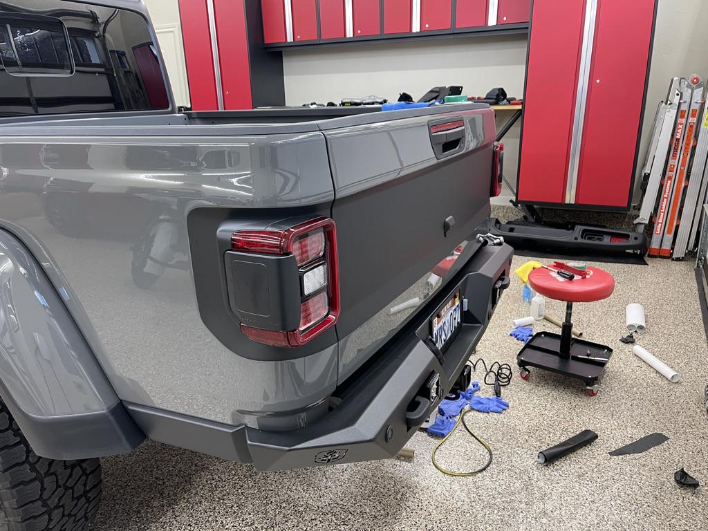

sure is! I've done it enough to warrant buying 4 rhino ramps solely to get the jeep up higher for easier/more leverage. Might help out for re-torquing yours!Fitted new front LCAs from the Mopar kit to compliment my 1.5" puck lift. 190lb/ft with the JTR on the floor is seriously hard work!

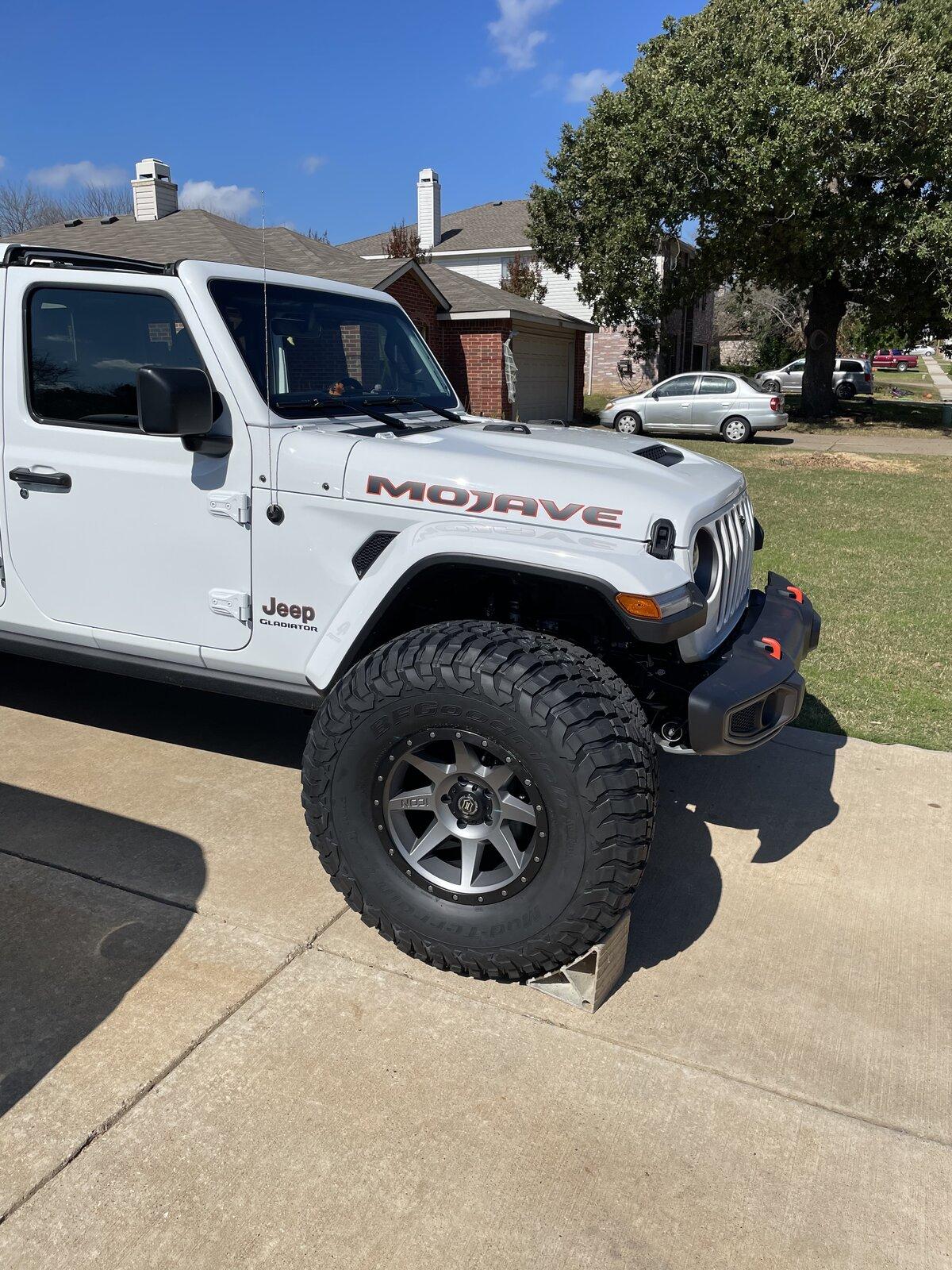

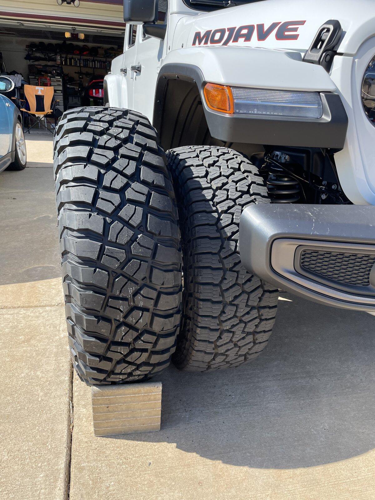

Ratchet strap helpful for aligning everything up. Steering pretty easy.Spent the last 2 days installing the AEV 2" Mojave lift with their geometry correction brackets. But only the front half, that's as far as I got in 2 days (did it at a DIY shop with limited hours). Nothing was as easy as it seems. I thought Jeeps were supposed to be easy to work on????
Only half kidding. Main struggles were awkward angles to get torque to loosen on control arm and track bar bolts, there is not a lot of room between the bolts and the track bar/drag link/steering stabilizers/all the metal down there. And then had a hell of a time lining up the axle to get the shocks back in at the very end, that part alone took me about 2 hours to figure out. Oh, and then the shock extension brackets from AEV were too narrow to fit around the stock shock mounts, and I had to bend them in a vice.
For the next 24h, rocking the Carolina Squat until I get back in there and finish up with the rear. Hopefully won't have the same problems - although I am worried about being able to line up the axle without the ability to turn the steering wheel and shift it right to left. Oh, and have to realign the steering wheel too - I'm about 10 degrees from center and getting the ESC warning issue. Almost there!
