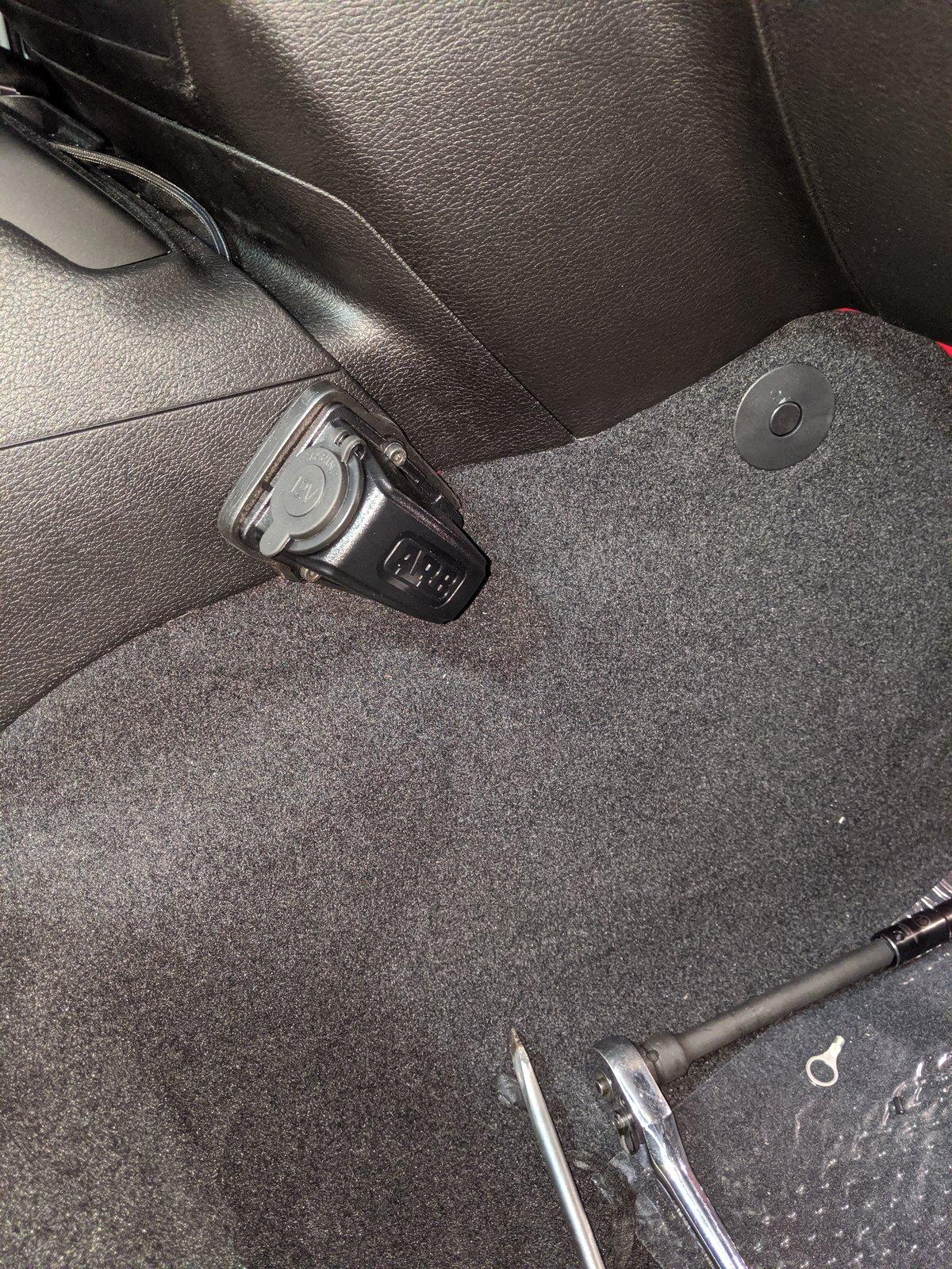

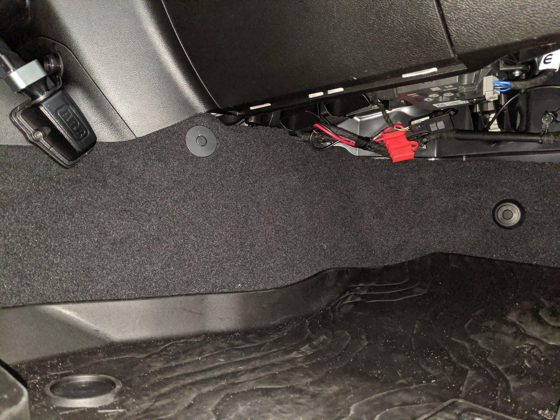

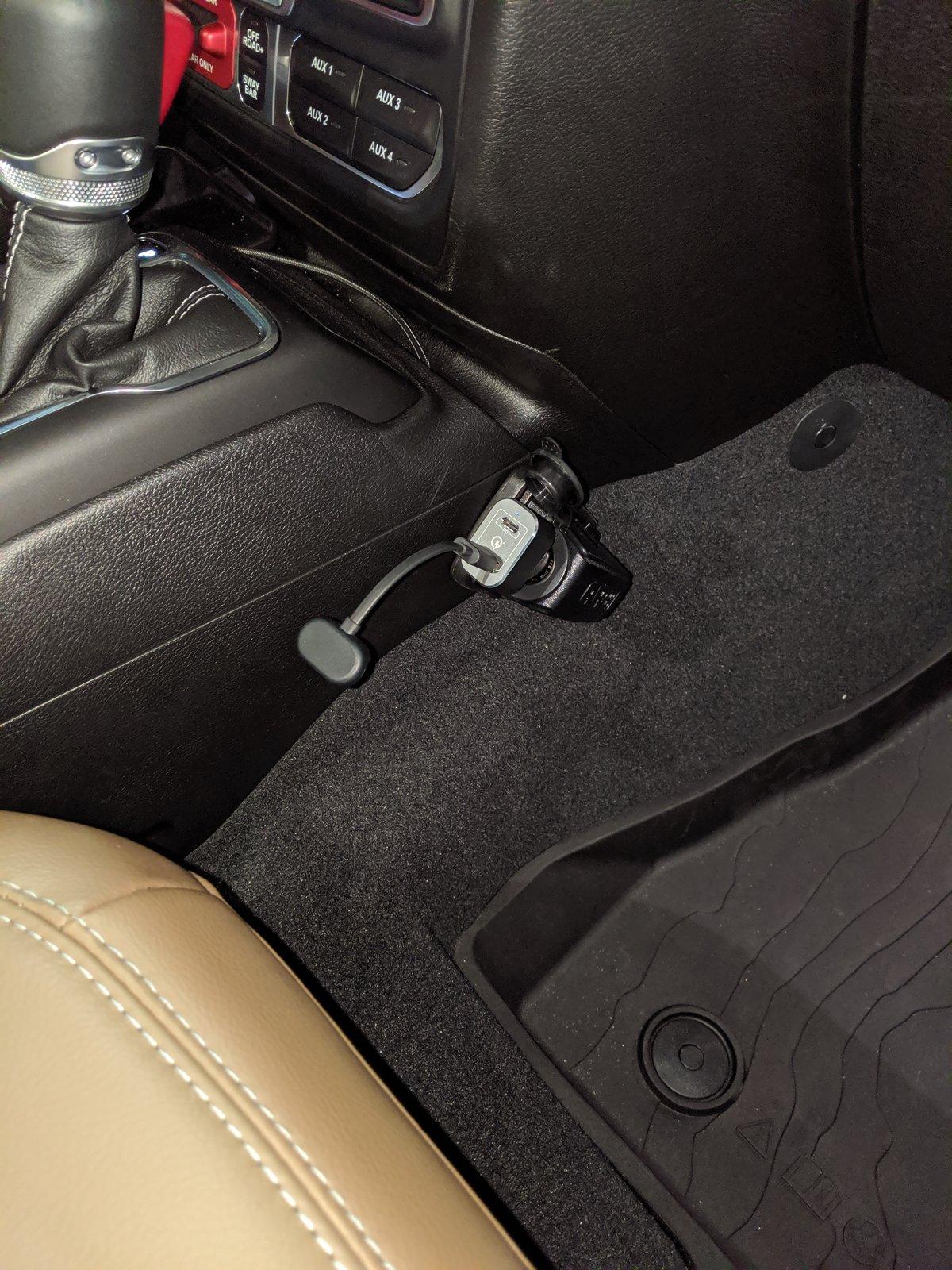

Does the Redarc brake controller work with a Gladiator that has the tow package?Nothing super exciting, but I borrowed an idea from @KVJ and filled in the letters on my Redarc bezel to match the other white lettering on the dash and make it pop out a bit more. Pretty happy with how it turned out.
Have one in mine. Works well.Does the Redarc brake controller work with a Gladiator that has the tow package?
I’m thinking about this.Got in yesterday and installed today... whew. Synergy’s trackbar and sector shaft brace. I fully recommend 150%.
Thx. Which wiring harness did you use? Any recommendations on removing the cigarette lighter plug?Have one in mine. Works well.

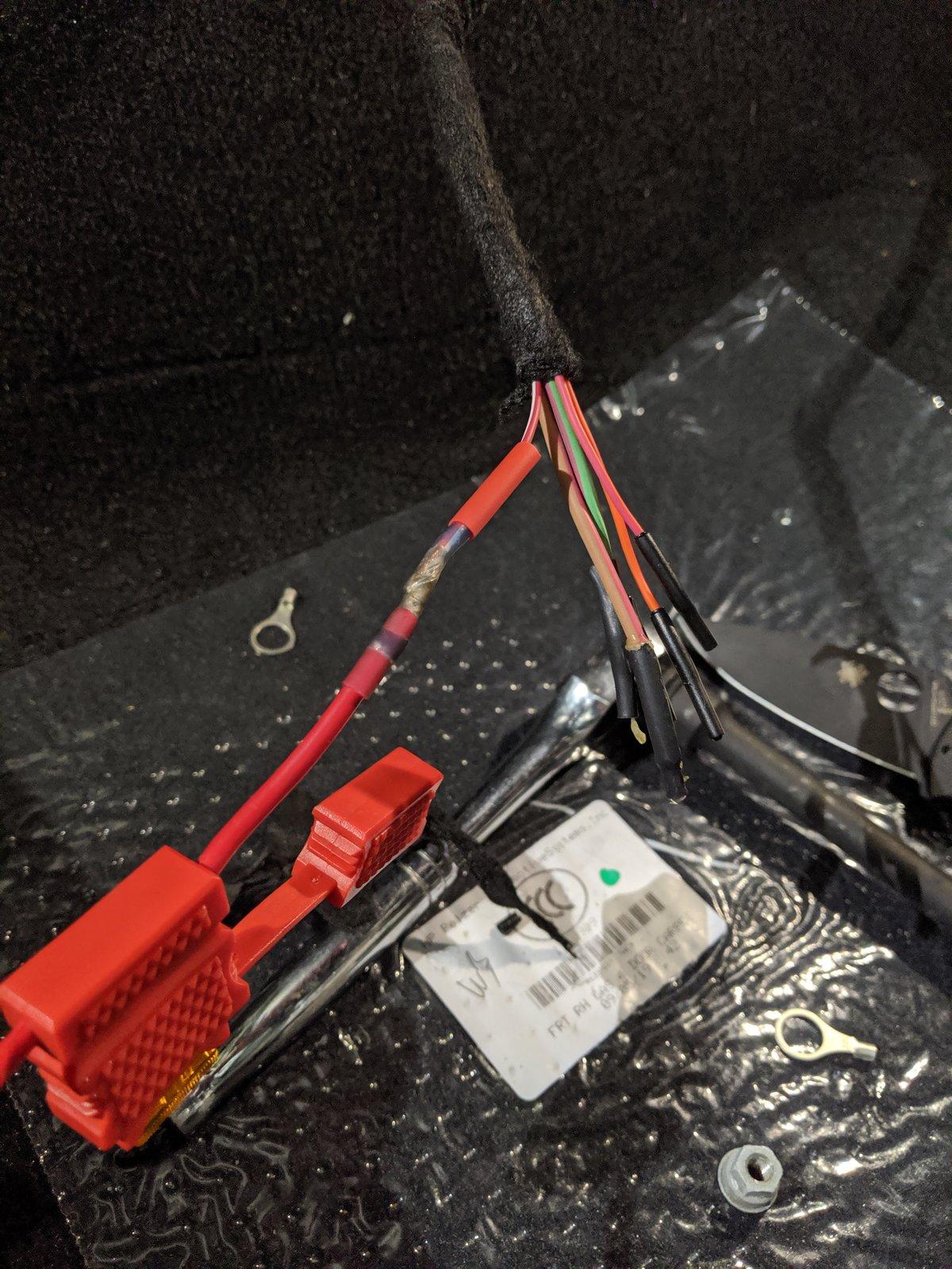

Yes, mine has the tow package and it works fine with it. I used the Ram Harness from Redarc, and switched the blue andT
Thanks for the info. I saw the video by @WXman. He also used the TPH-020 harness. The missing piece to the puzzle was the cigarette lighter replacement. Your finished product looks great. I’m going to install the same set up.Yes, mine has the tow package and it works fine with it. I used the Ram Harness from Redarc, and switched the blue and
black wires. This made everything 100% plug and play with no splicing required. Here's the harness:
https://www.etrailer.com/Accessories-and-Parts/Redarc/331-TPH-020.html
@WXman did a good video that shows everything other than the cig lighter part here:
https://www.jeepgladiatorforum.com/forum/threads/redarc-tow-pro-elite-installation.27012/

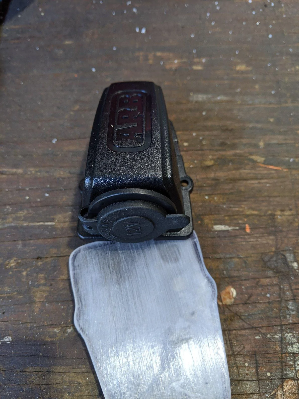

As for the Cig lighter part, I got that idea from @KVJ and someone else on here. you'll need this mounting ring:
https://www.etrailer.com/Accessories-and-Parts/Redarc/331-TPSI-003.html
Removing the lighter is the hardest part of it, that thing fought me for a while. Getting the dash pieces off to get it out was pretty easy, they are just snapped in. Once you have the lighter out, you can either make a small notch in the dash piece (I did this) or file the alignment nub off of the mounting ring. After that it snaps in with no problem. I have the outlet out now in my toolbox, so I could probably take some pictures of it to show you if you want.
Yeah, I talked @WXman through it and he shows it in his video. you basically have to pop those 2 wires out of the Redarc harness at the connector that plugs into the Jeep, switch them and push them back in.Can you expand on your comment where you stated you switched the wires? Did you have to remove wires from the plug and reinsert them? Thanks.
