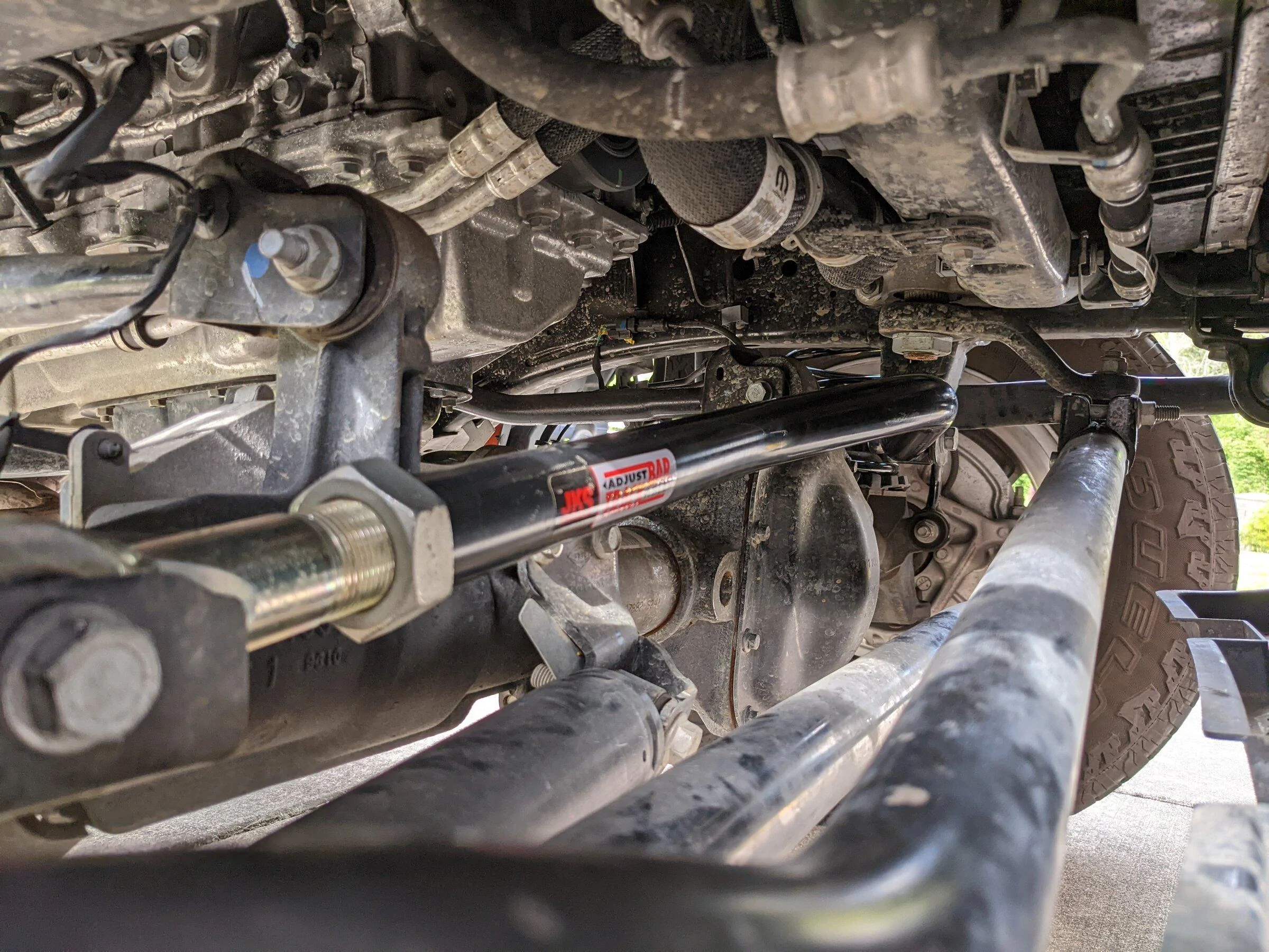

Steer Smarts Track Bar Reinforcement/Sector Shaft Brace
Never had an issue with steering wander so this is mainly preventative but I do feel a difference.
A lot harder to install than I thought. The sector shaft nut that came with the kit is very shallow and I was afraid of rounding it off when I was torquing it to 177 foot pounds. If you plan on installing this get a 42mm crow foot.

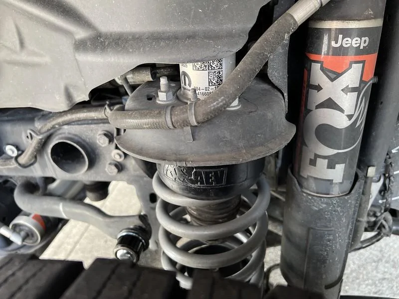

A few more add ons:
Rear Eaton e-lockers (got the front installed but found a rear axle seal leak so had the dealer fix it first)
Falcon 2.1 SP2 shocks
Rock Krawler 1.5 inch lift front springs
Longer Mopar LCA
Enjoyed a Hurricane Creek trail ride with my brother near Asheville NC
