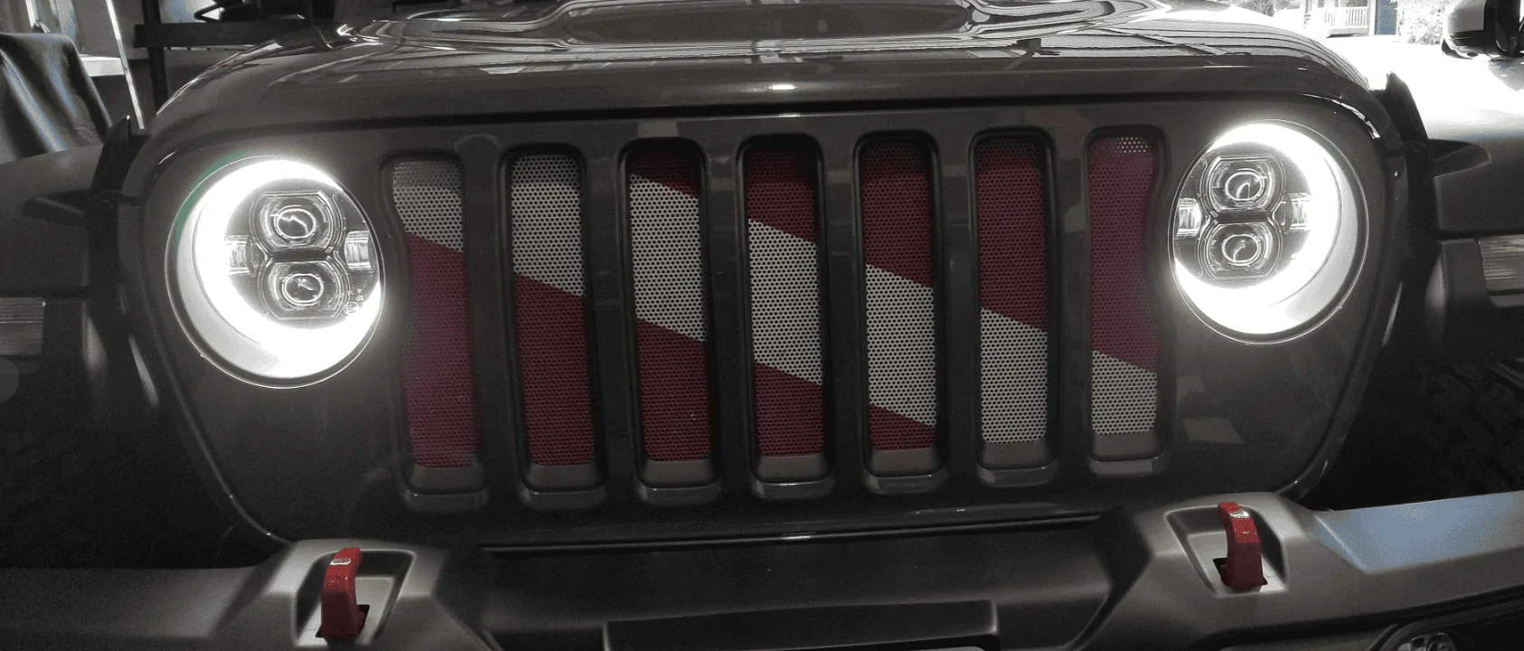

Did my front end led bulb install, drivers are led, passenger is halogen, also did turn signals (not pictured) and reverse bulbs (not pictured)

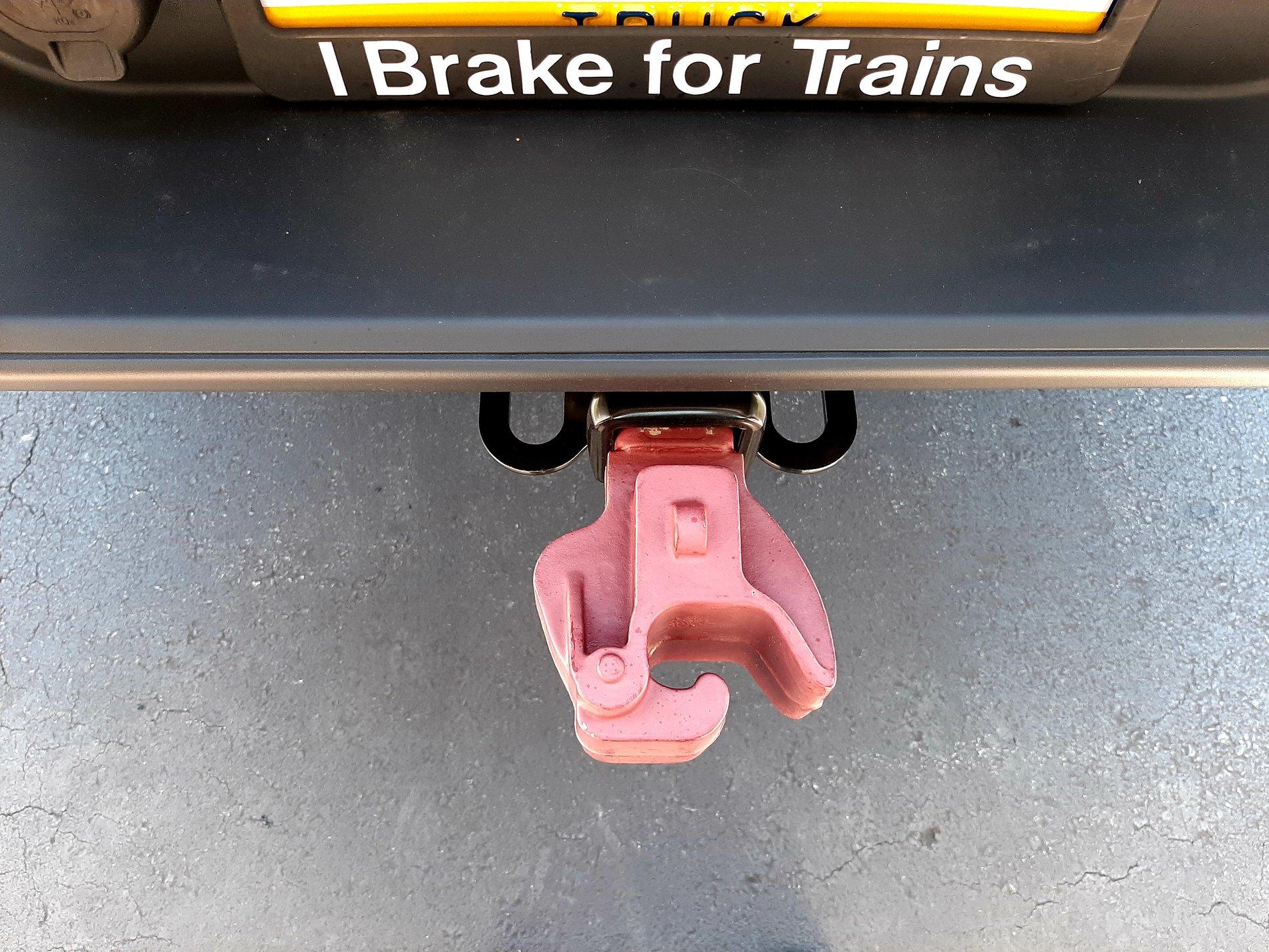

added 2nd rear tow hook and tonneau cover
