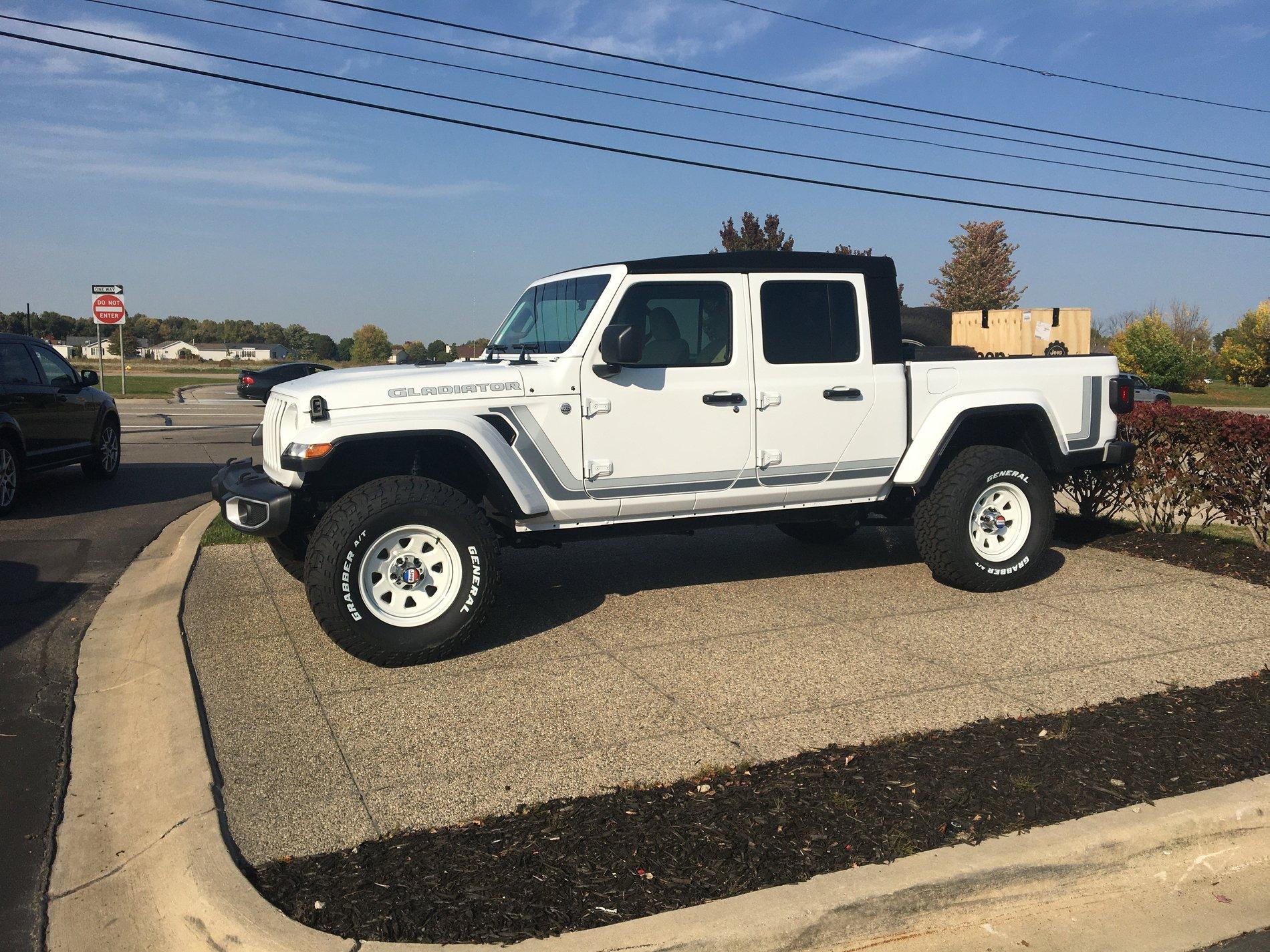

Technically over the last couple days, drove down to North Carolina and had @chevymitchell from the Wrangler forums do a regear. Went with 4.56 to bring it back closer to stock with the 35’s. The rear put up a fight but he was able to get it perfect. The difference is very noticeable and well worth it!
Finally... this is an auto correct? If so, are you able to hold 8th? Id be happy to just see it..once.
After some time can you add more to your thoughts? Towing, MPG +/-, how it does at 65+ mph.
Im on 35's with 3.73. Never seen 8th with them, only see 7th if 60 mph or below or with a very strong tailwind....dont have any hills to speak of here but I see 7th going down an over pass, lol.
I tow from time to time, nothing extreme, a couple thousand pounds...mainly cause my tandom weighs close to 1500 lbs. Have considered 4.88 but day to day driving just would like to get more input on 4.56.
Thanks
