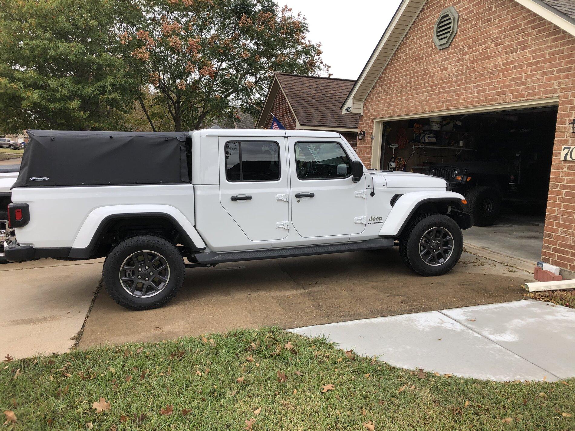

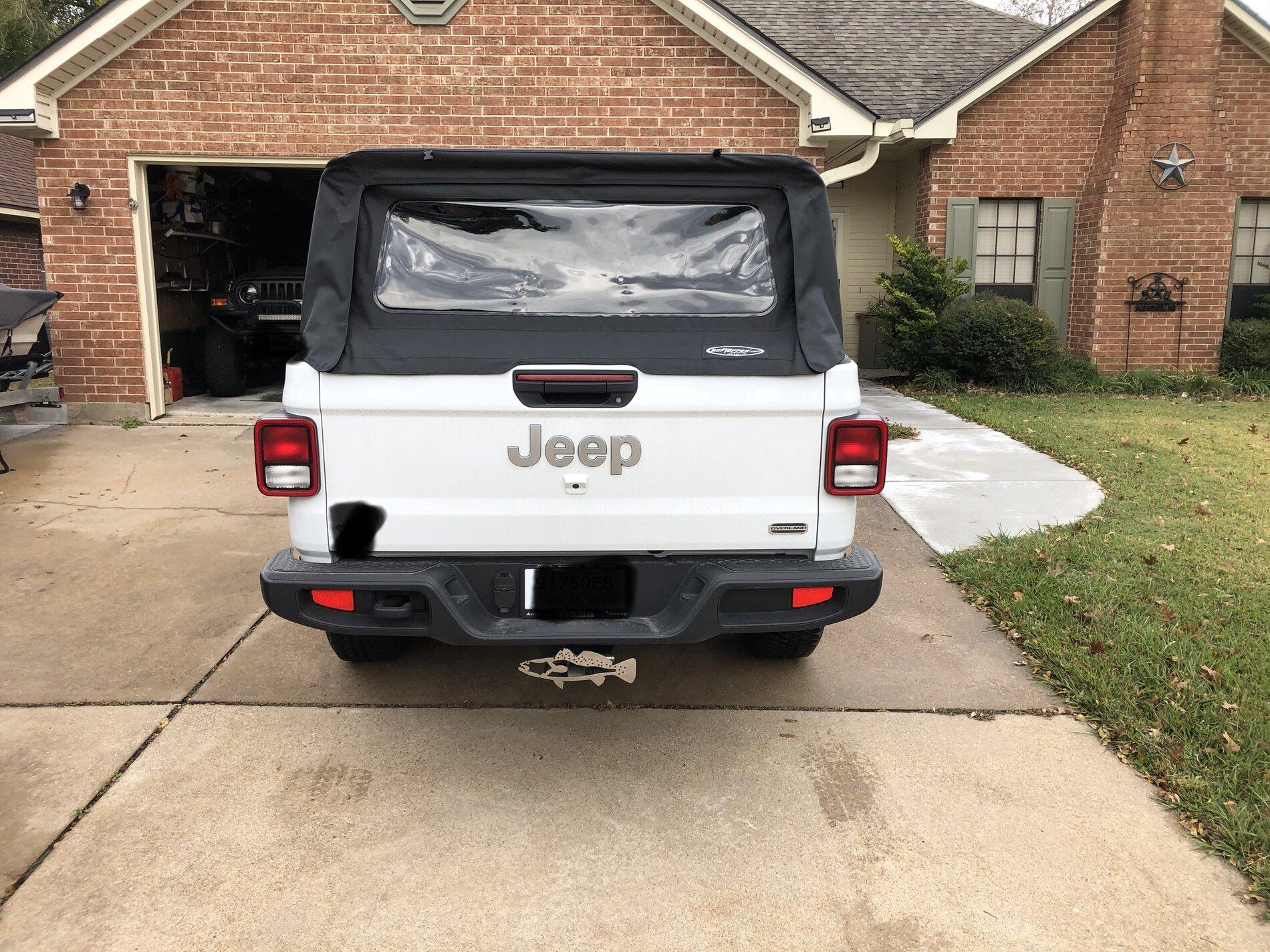

I’m very pleased with armorlite, the installation is not hard but you do feel like you wrestled a beer. Make sure to wear gloves and take your time with the trim pieces. I broke my front passenger side trim putting it back in. It helps if everything is a little warn so it’s more flexible.

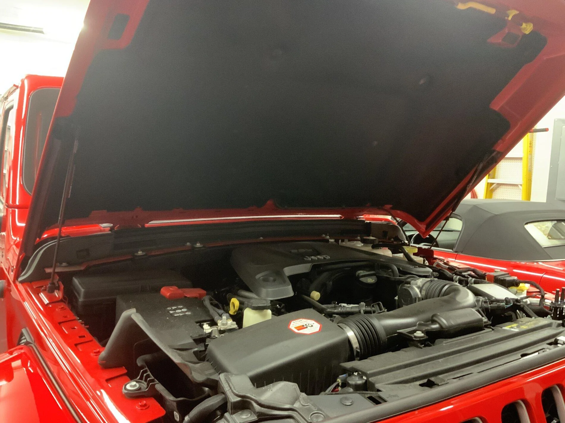

Used a Matco fuel injector cleaner with stand alone small gas tank.
Put gas & BG FI cleaner in, killed the Jeeps fuel pump and started the process.
Turned the machines fuel pressure down until it limped. When it would smooth out I lowered the fuel pressure again & again.
The BG distribution outlet’s salesman tried for almost two years to find out why my washes were better than other shops.
Our old TV commercials showed my mom in her STS before & after boiling the hides.
BG sells a great decloaking spray that you can invert the can.
Cleans Mass air flow sensors & the small hole on the butterfly along with upstream & downstream 02 sensors.
If you do this, do it BEFORE you change the oil.
Plus change the oil right after you are done as a carbon filled oil pan causes etching.
If done this way you don’t even need to add BG’s 44k tank additive.
Seen new oil look old after the process.
Conical injector pattern without breaks pushes the piston evenly.
Sea Foam is #2
I am changing the oil & filter at 1000 miles tomorrow for break in.
