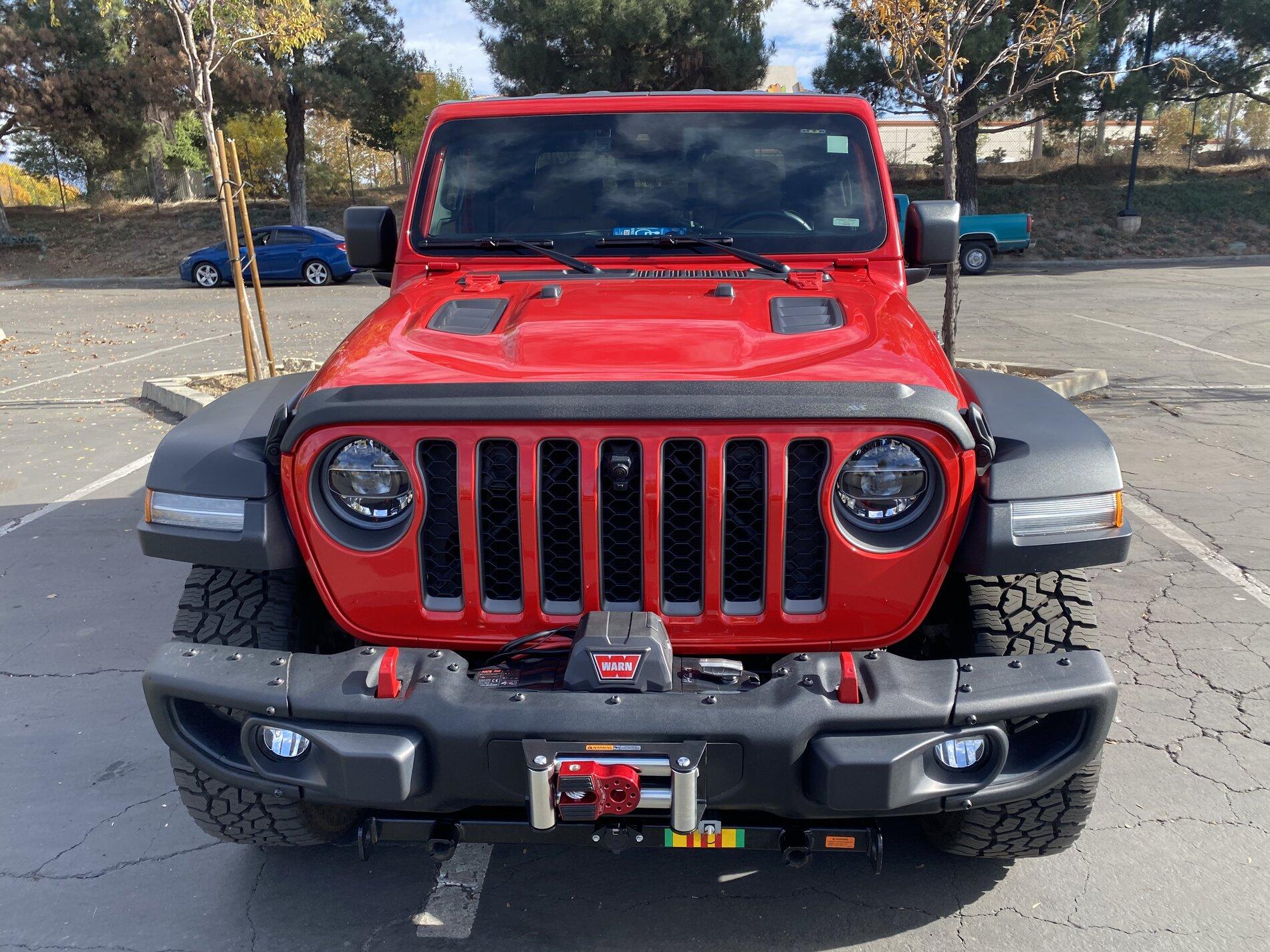

Alot of work for a simple project. I found out that mounting my solenoid box offset put the remote port directly in line with my LP6 lights.
Jeep Gladiator What did you do TO your Gladiator today? [ADMIN WARNING: NO POLITICS] 20210408_143800
I couldn't have aligned that better if I tried!
Off with the Arcus and winch to move the solenoid and re-route the cables. I told myself I would never want to put another Arcus bumper on, well, here we go!
Jeep Gladiator What did you do TO your Gladiator today? [ADMIN WARNING: NO POLITICS] 20210411_105011
The most time consuming part was deciding on a winch cable routing, as there is zero gap behind the winch where the cable would logically drop out of the solenoid box.
Jeep Gladiator What did you do TO your Gladiator today? [ADMIN WARNING: NO POLITICS] 20210411_123251
Finished product, I mounted the LP6's where the overrider bar is meant to go, if you do this, make sure you put a spacer in between the bumper shell and bracket underneath, if you dont, you will cave in the top of your bumper when you tighten the bolts.
Jeep Gladiator What did you do TO your Gladiator today? [ADMIN WARNING: NO POLITICS] 20210411_182934
