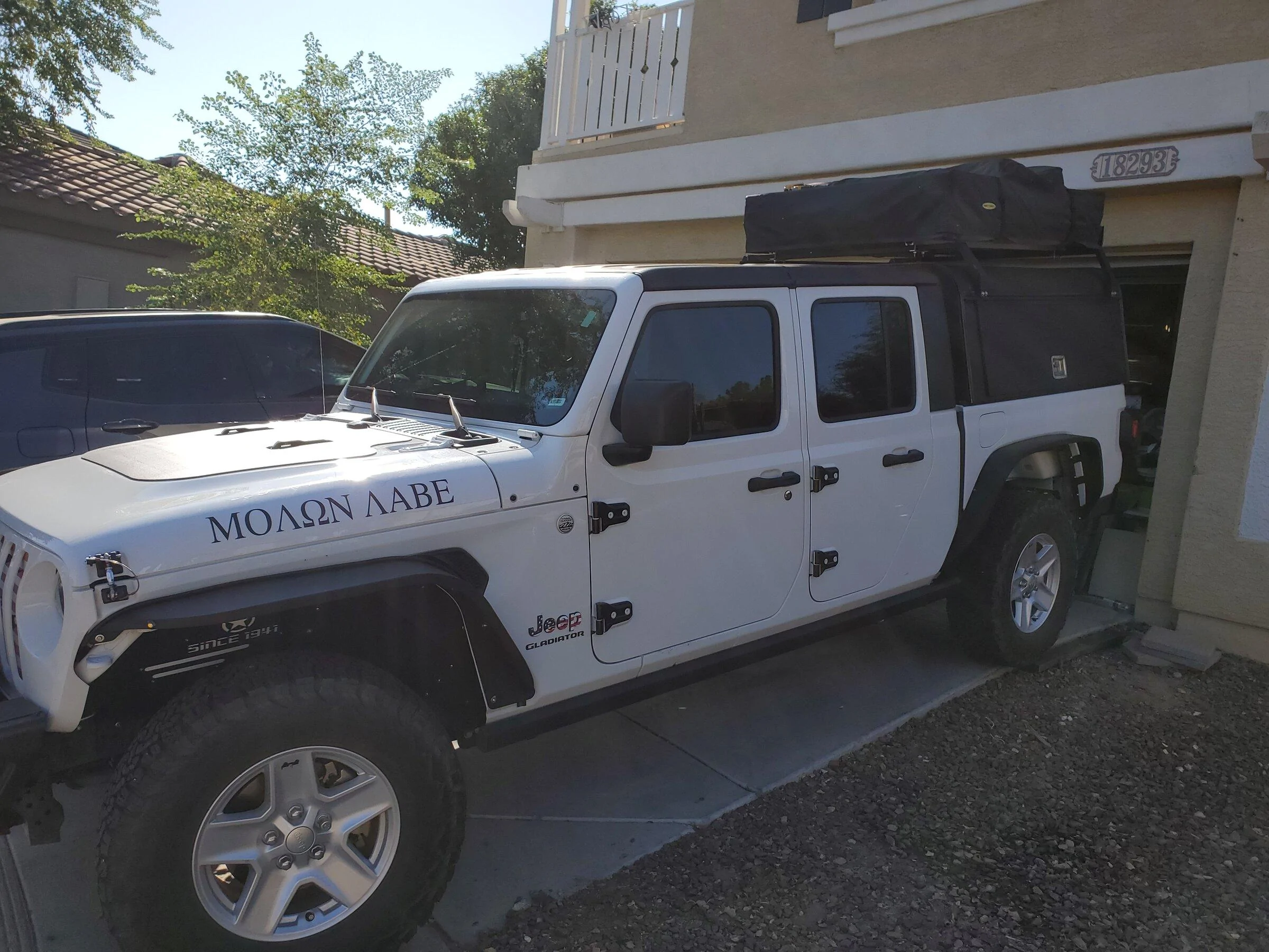

My JT is now 2 yrs old and I want to get 37's, BUT I've heard my stck axles will snap at some point. I'm getting ready to get front and rear lockers and regear. I don't have a lift yet, but I have DV8 slim fenders installed. What exactly do I need to properly run 37's?
- regear
- tires
I'm not asking for the be all wishlist or most badass set-up out there, just what SHOULD I have at a minimum? I don't go crazy Rock crawling mostly Overlanding. I don't plan on getting a lift till after I get the JCR Vanguard bumper with both swing outs. I'm waiting on the lift so I don't have to pay twice for springs and shocks with all the weight I have in the back.

At minimum I would say wheel spacers and 2 inches of lift. Do you have the max tow package? Axles should be the same as a rubicon if so.

Unless you have 3.73 gears you don't HAVE to regear.
2"-2 1/2" lift with shocks, longer front LCA's, track bar, drag link bar, tie-rod bar.
You will wear out ball joints faster, but don't need them right now. When you do, get the rebuild-able all steel ones and not the OEM with plastic bits in them.
Wait on buying wheels until you decide on what lift. You can ask them what back space you need. Most specify it, but some don't have a number posted so ask up front.
Don't worry about the axles. If you aren't bouncing rocks or sending it on hill climbs, they're pretty tough.

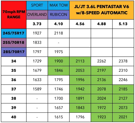

If your going to crawl on challenging trails you should have a skid plate package, stout differential covers, both axles trussed, swap the front axles for an RCV Ultimate Dana 44 Axle CV Set and the rear for new Yukon shafts. But since you don't plan to crawl hard and overlanding is your primary goal then you don't need that stuff, and $5,000 + 37" tires will suffice.

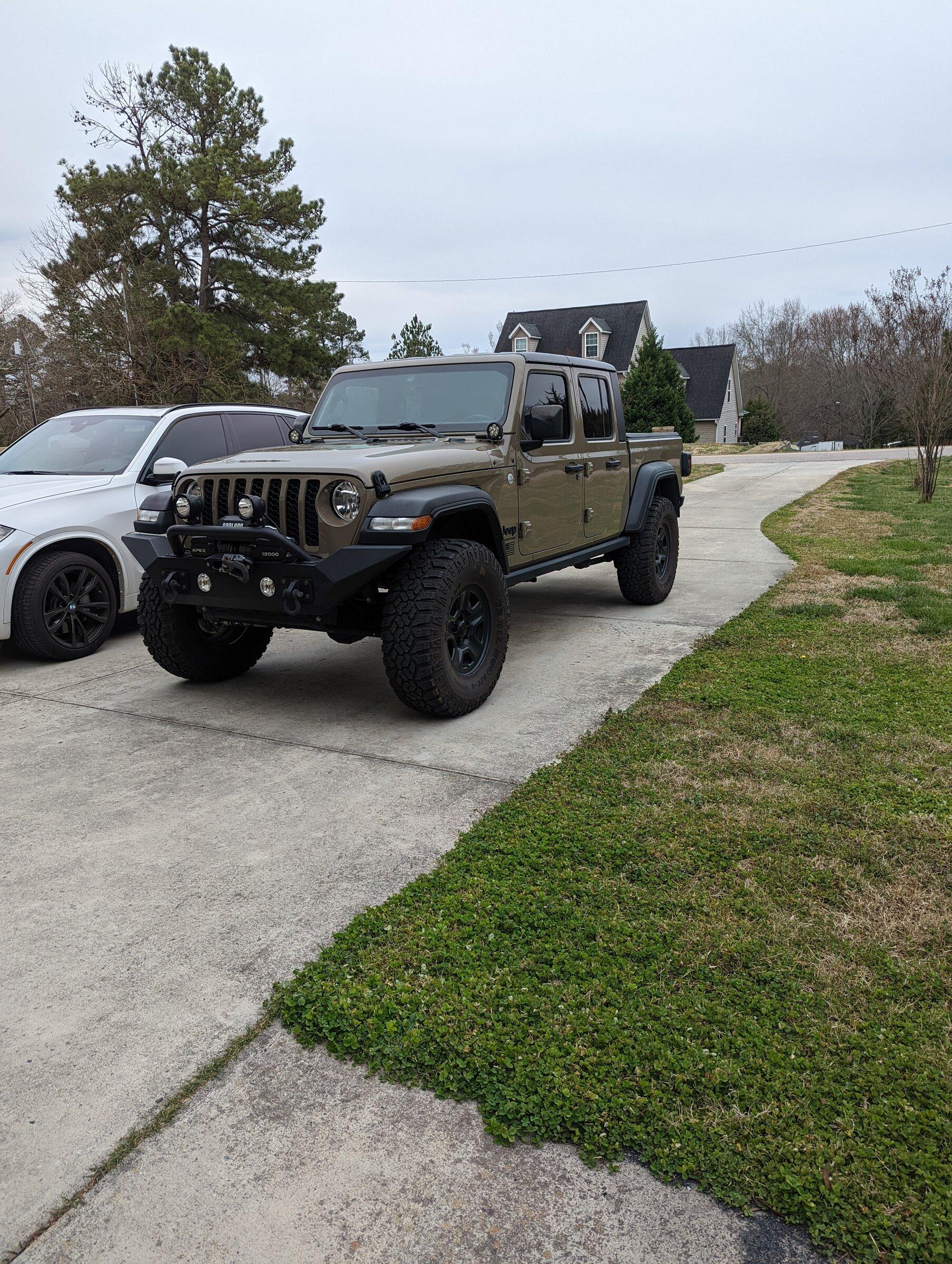

What is the down side of getting the lockers and regeared for 37's but keeping My 285/70R17 tires for a bit...till they "NEED" to be replaced? My JT is 2 yrs old at 42k tire are still great. I found a shop (reputable) that will do both lockers and gears for a reasonable price...no labor for the gears if I do them with the lockers.

If it's not a Max tow, Mojave, or Rubicon you may want to consider a regear, 3.73 will not cut it. 2" of lift is plenty enough to run 37's on the JT and if you don't have any of the 3 I mentioned then you will need wheel spacers or different wheels. I'm running 37's on my Max Tow on stock gears, 4.10, and I have 2-1/2 SST Readylift installed with Rubicon front springs as well. I'm on stock wheels with no spacers and no rubbing. I average around 17.2-17.9 mpgs for the most part, had it as high as 19 on a few long trips. Your axles will hold up fine no need to worry about that. Your ball joints will probably wear out around the 110,000 to 120,000 mile mark.

I have 37’s, and I’m not sure you’ll be happy with 3.73 gears. The other stuff depends on how hard you are on it. If you expect similar performance with the transmission, 3.73 gears will be pretty bad with 37’s. I would have left mine at 4.10 if I went with 35’s. When I decided on 37’s, I regeared to 5.13.
