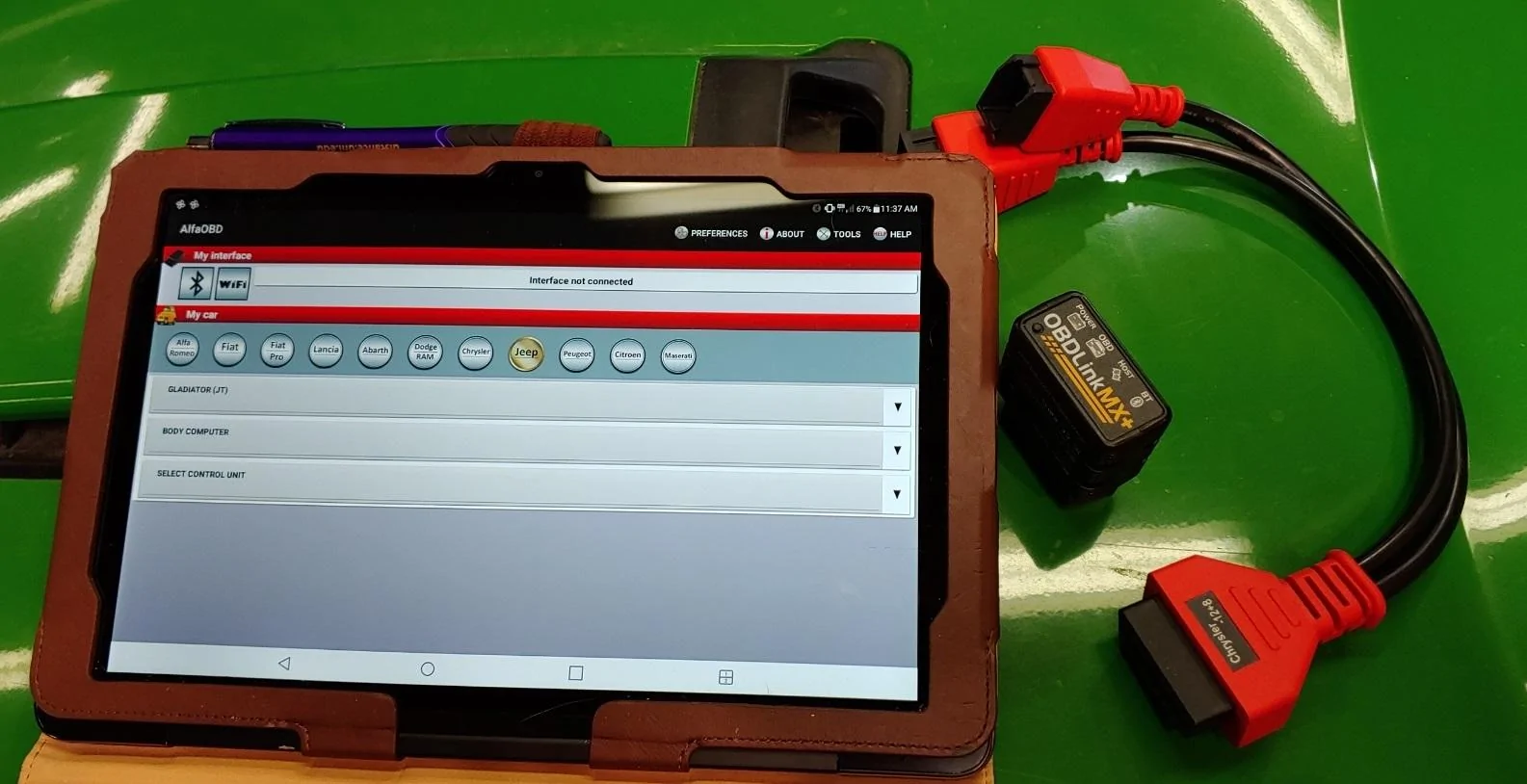

Jason already responded where - but I have those cables and they work GREAT. I can connect the bypass in seconds and put things back in even less time with the extension.
I've used jscan quite a bit - but also use AlfaOBD and really love it. Once you license it you can use it on any Alfa vehicle (Jeep, Ram, whatever with no additional licenses - and I have it on my tablet and phone)
jscan is a bit more intuitive, easier to search for things and navigate until you get used to AlfaOBD. For speed I like jscan, for depth and things jscan can't - or a while back could not do - I used AlfaOBD.
I logged the misfire errors on my wife's Jeep with AlfaOBD and got an in-depth report.
I made the tire size changes with jscan because it was so much faster to use, I've added auto high beam, set up the settings for passive entry, etc.
I've not even touched a fraction of the things jscan (or AlfaOBD) can do - not even close.
Jeep Gladiator What do you use your JSCAN for? 20210110_113706

Awesome. I used the J Scan today to change the tire size. Easy and fast. As I was fumbling with the cables I kept thinking about the extension I read about. Going to order it now. What is the most interesting change you made?
207
32,767
40,495
So far pretty boring - tire size change and added the settings for passive entry after I installed the handles and wiring.
For the auto high beams I had to use AlfaOBD because at that time, jscan was missing one of the necessary settings that needed to be set.
They (jscan) have since corrected/added that setting so you can actually use jscan for that now as I'm told.
Some day I'll hook things up and just "snoop" but for the most part my Jeep behaves like I wanted and then some. Maybe I'll dig and find something else to do, but I can't think of anything right now I would make different.
